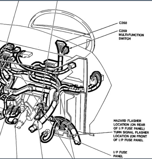

The first thing that you might want to check is the turn signal flasher. It is mounted on the front of the instrument panel fuse box. this guide can help us fix it
https://www.2carpros.com/articles/turn-signals-not-working-blinker
I've attached a picture of what it looks like and its location below. Hope this helps and thanks for using 2CarPros.
