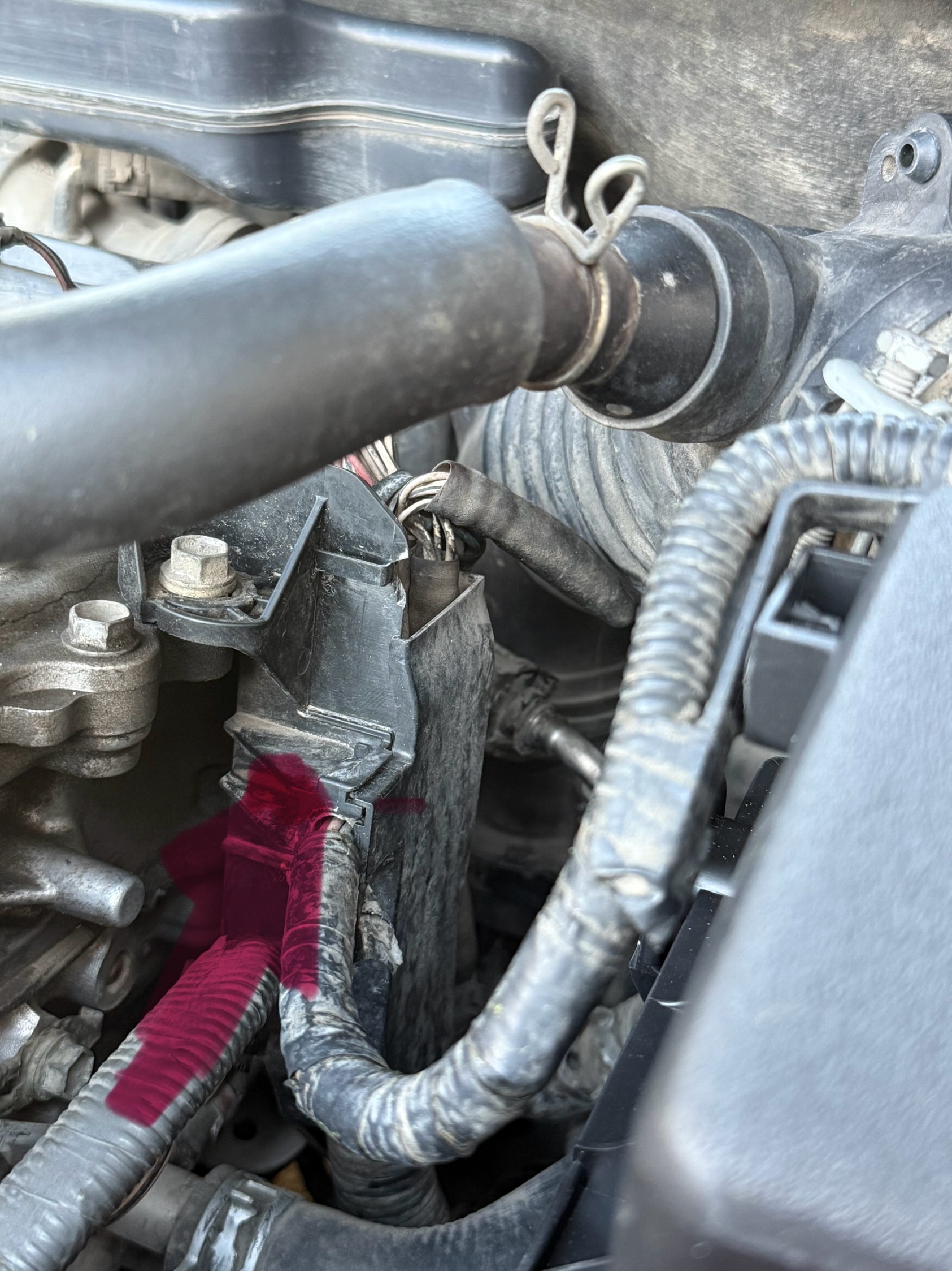

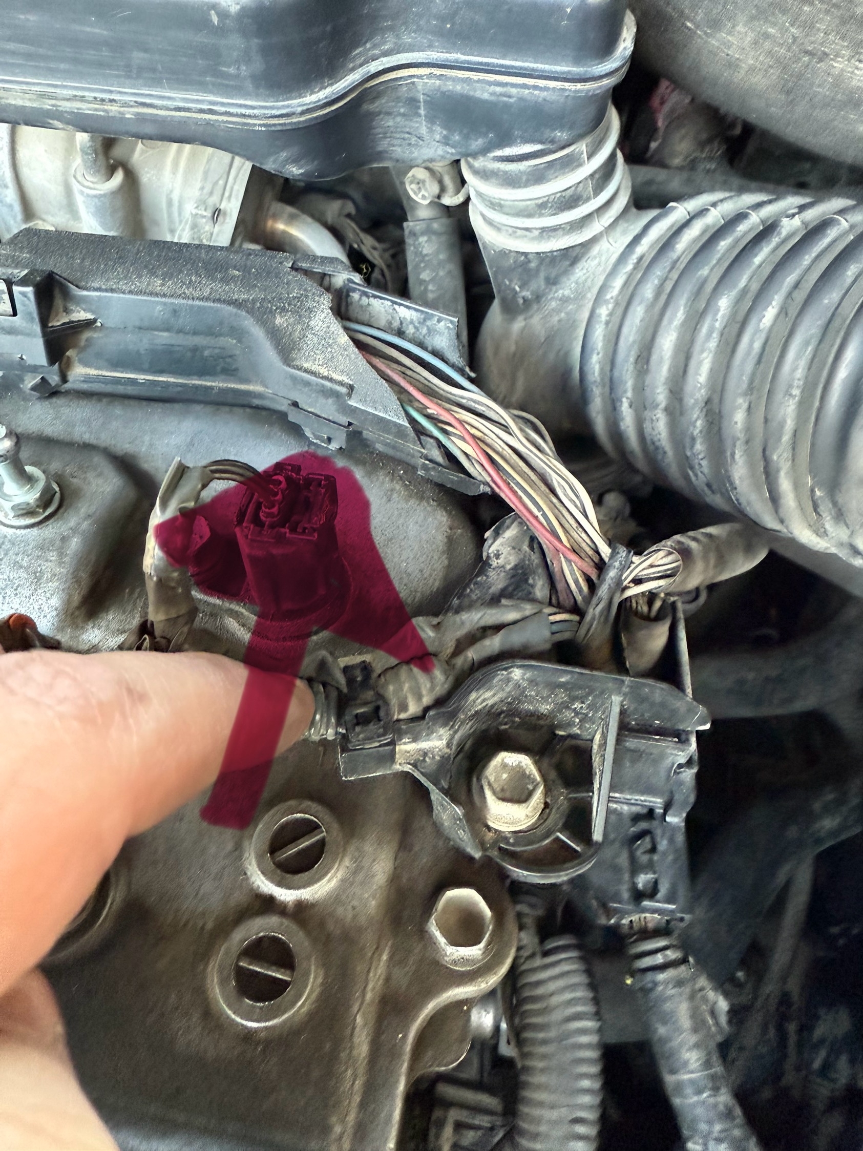

I am looking for part number of (cover harness protector) in my car listed above, it is broken in my car. i tried to find the right number of the item but failed. Please if you can help me, i will attach a picture of it, and where to buy it.

The "cover harness protector" is likely the Wiring Harness Protector Cover. This part is only available from the dealer
Part Number: 82815-07240
Let us know if you need anything else.
