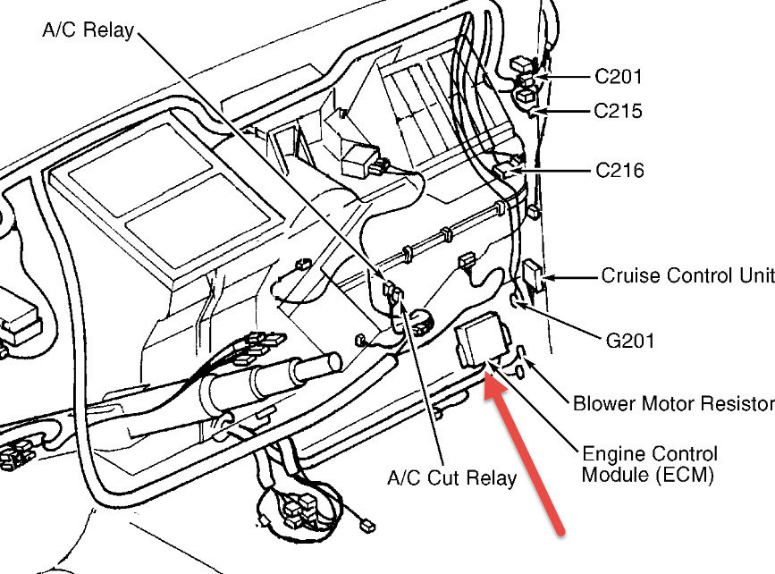

Where is the engine control box located?
Tuesday, April 25th, 2017 AT 11:56 AM
8 Replies
HMAC300
  • 48,601 POSTS
See picture for location under carpet under dash. If replacing it will need to be programmed by a mechanic for security system in order to start car.

After changing the control box no difference. No problem with the cold motor. After warming up the motor weak, or stops, and blow up into the chimney. Try to change the injectors now

Why not you scan for codes and check fuel pressure before doing that you guys waste so much money on good parts before doing the correct things auto parts scan s for free and you can check fuel pressure although you may need an adapter. auto parts rent the gauge. See link.
