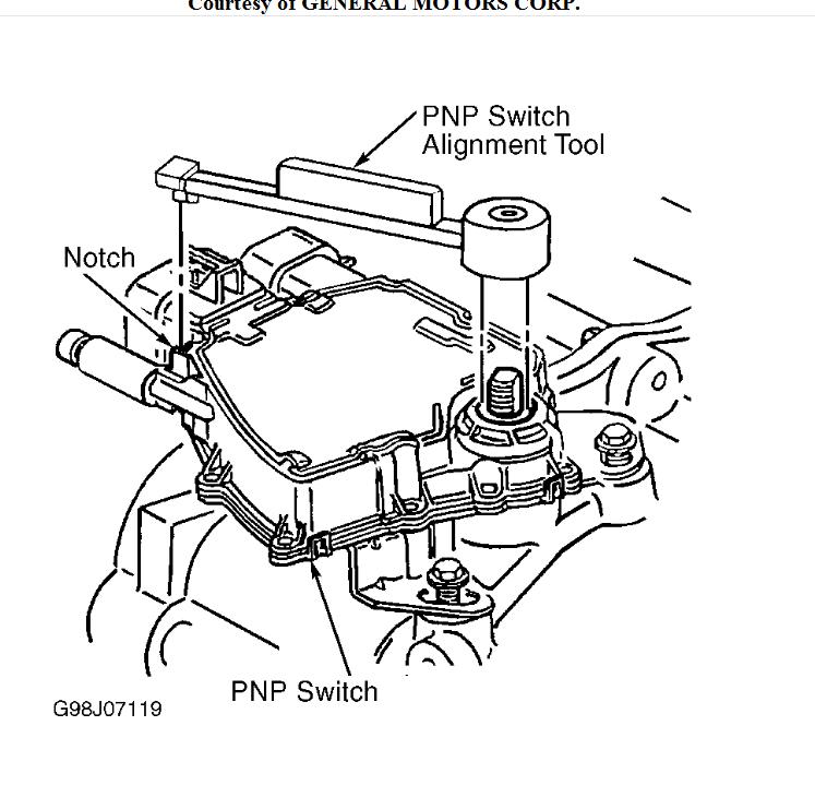

Where is the Park/Neutral switch located. Every once in a while the car will not start while in Park. It seems it's becoming more frequent. I have to push on shift lever, then it starts. I tried shifting it to Neutral, but wouldn't start. Put the lever firmly back into Park & it started. I am assuming that it's the Park/Neutral switch.

Floor shift or column shift it makes a difference.

Column: automatic

It's on the top of trans axle at shifter.
