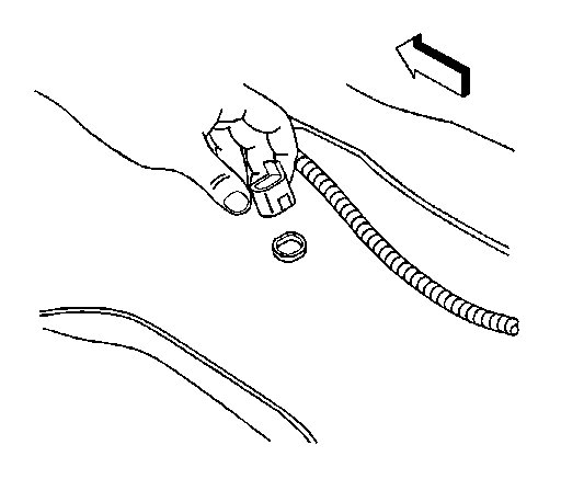

Here are the directions for replacing the front park assist sensor. The attached pics correlate with the directions.
_________________________________________________
2006 Cadillac DTS V8-4.6L VIN 9
Front Object Alarm Sensor Replacement
Vehicle Sensors and Switches Sensors and Switches - Accessories and Optional Equipment Parking Assist Distance Sensor Service and Repair Procedures Front Object Alarm Sensor Replacement
FRONT OBJECT ALARM SENSOR REPLACEMENT
REMOVAL PROCEDURE
pic 1
1. Remove front bumper fascia.
2. Disconnect electrical from the front object sensor.

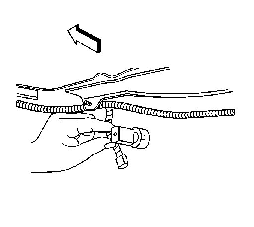

pic 2
3. Lift the locking tabs on the housing (4) and remove the front object sensor (1).

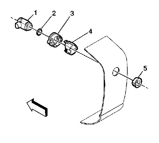

pic 3
4. Squeeze the spring (1) and remove it from the housing (2).

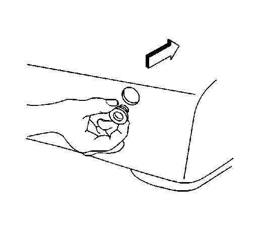

pic 4
5. Release the tabs on the housing and remove.

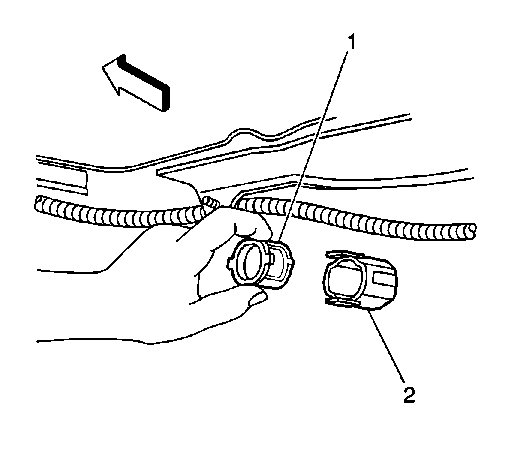

pic 5
6. Remove the front object sensor bezel by pushing it through the fascia.

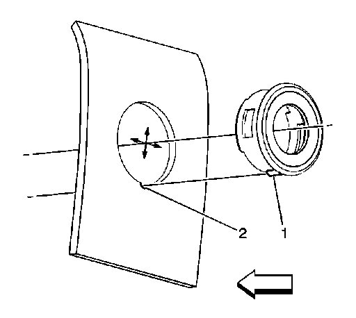

pic 6
3. Align the keyhole (2) with the key (1) and press the rear object sensor bezel flush to the fascia.
