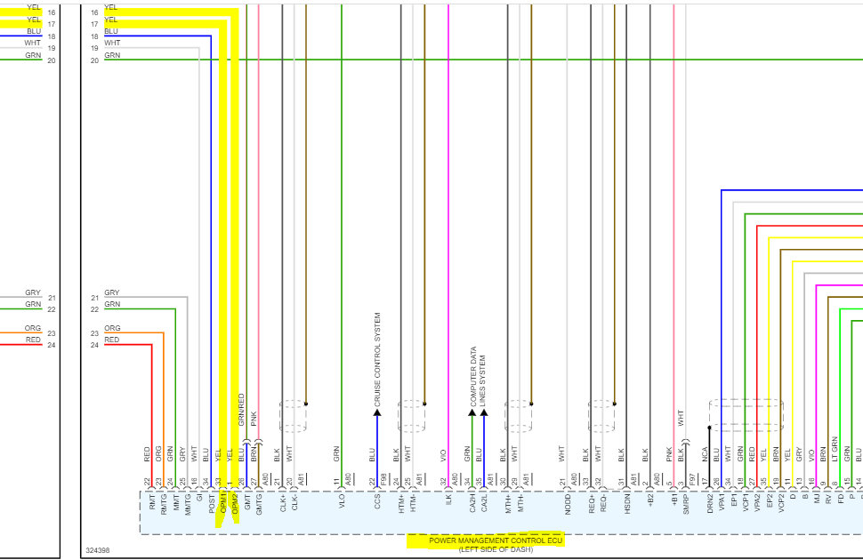

P2603 code. Followed GSIC diagnostic procedure for this code. Troubleshooting found numerous wiring faults (fixed them) and a failure at Power Management ECU output. Diagnostic procedures indicate faulty ECU. Replaced ECU with a used one - Fails again at ECU output. Replaced with a 2nd used one - Fails in the same place. I can't imagine this failure is so prevalent that I happened to get nothing but failed ECUs. I can't figure out what I could be missing.
It is probably important to note that 2 wires were open circuits (both to and from OPM relay - one supplies power to the OPM and the other was the relay trigger from the Power MGMT ECU). Additionally, and probably of some relevance. The trigger wire to the relay was one color at the ECU and another at the relay indicating a junction. However, the wiring diagrams all show 1 wire direct. Furthermore, that same wire had some resistance to chassis GND (spec is that it should be open circuit to ground). I ended up cutting the original at both ends and ran a jumper directly.

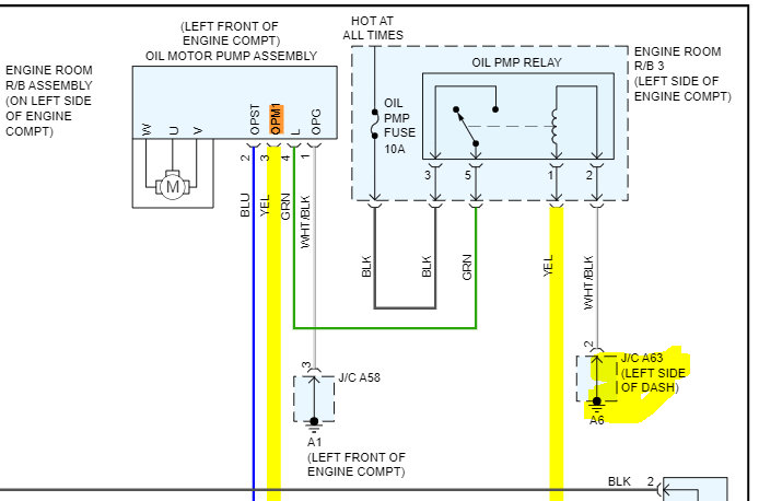

The diagnostics you have are the same as mine. The signal wire to the primary side of the relay shows yellow. Is that what you are seeing? If not, what colors are you finding?
Did you check if the primary side is getting a power signal? If it has power, does the white wire with a black tracer provide a ground to the primary side?
Are there any other codes?
See pic below.

I am also concerned that the wiring diagram is not accurate in terms of what I am seeing in the car. The relay has white wire for primary side and white/black for ground. White/black does provide ground, but I am not getting power on the primary side.
The ECU pin that is connected to the primary side is yellow, but somewhere along the line it changes to white at the relay. No power output at the ECU pin.

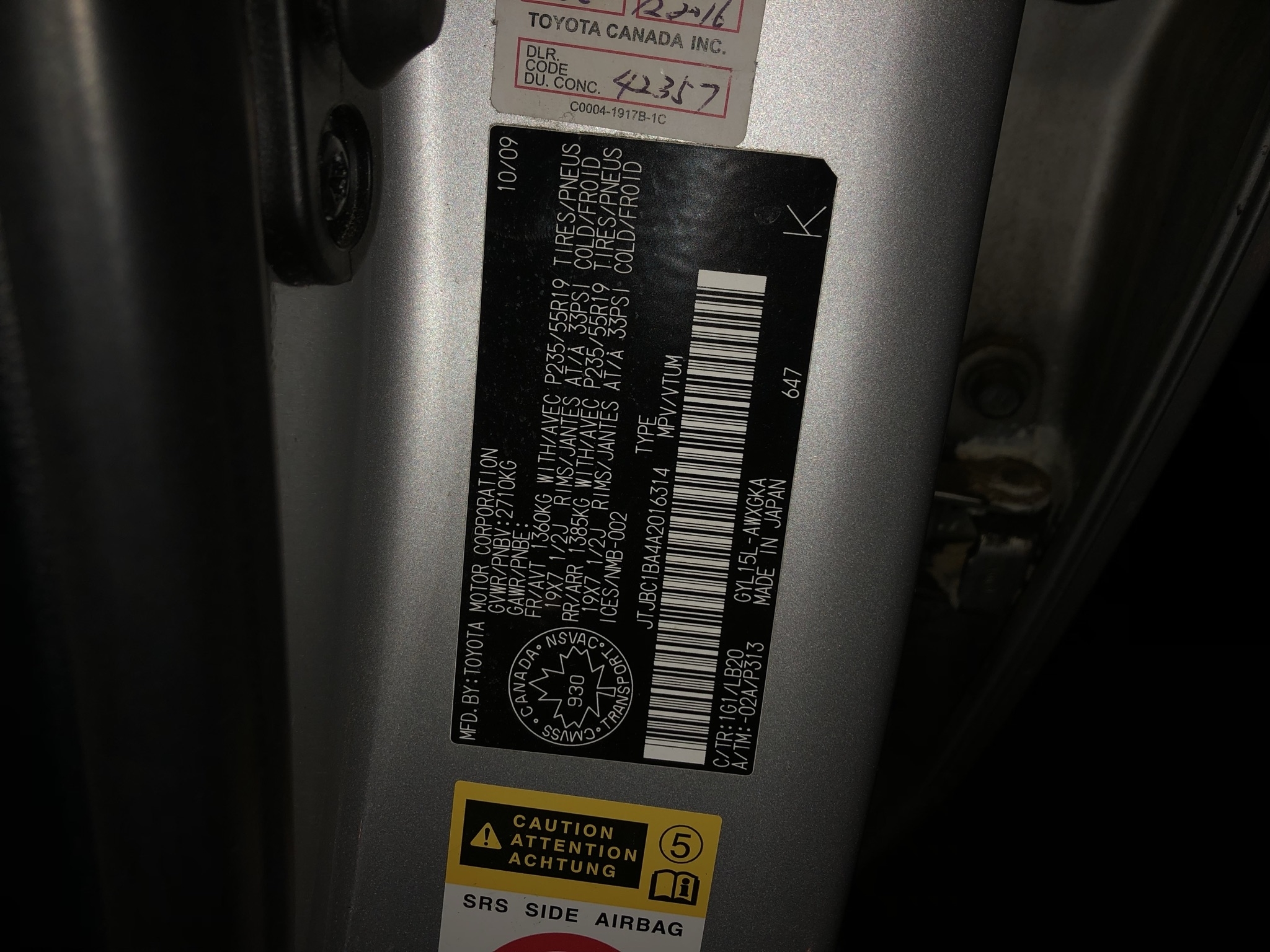

I'm sitting here thinking about this issue. By chance, could you provide the manufacturing date of the vehicle? If it is an early or late model, something may have changed.
Monday, August 15th, 2022 AT 7:19 PM
SPEEDRACER3
  • 25 POSTS
I was wondering about that myself. The black nameplate on the door jamb, with the VIN on it says 10/09 in the top right. Oct/09?
Monday, August 15th, 2022 AT 8:54 PM
  • 110,192 POSTS
It's an early model year production vehicle. No luck. I went back a year. They are totally different. Nothing is listed for OPM doesn't show up on a 2009.

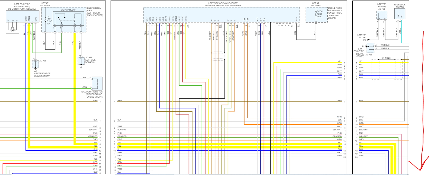

I went through two manuals and found the same thing. Something isn't adding up. According to my schematic, the wire is yellow from the ECU to the relay. See the pics below. Other than that, we are missing something.
