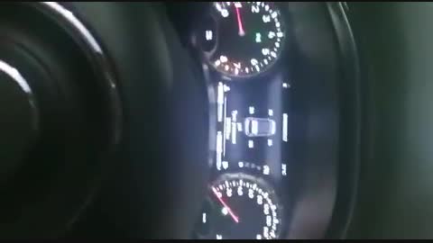

Check transmission light on and cannot change gear it only stuck on fifth? Error code p1c9d?

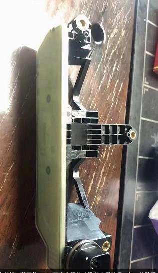

Is gear shift position sensor inside valve body on the conductor plate?

Yes, I would clean the contacts in the switch by the steering column. I don't think there are contacts inside the shift plate, I might be wrong though.

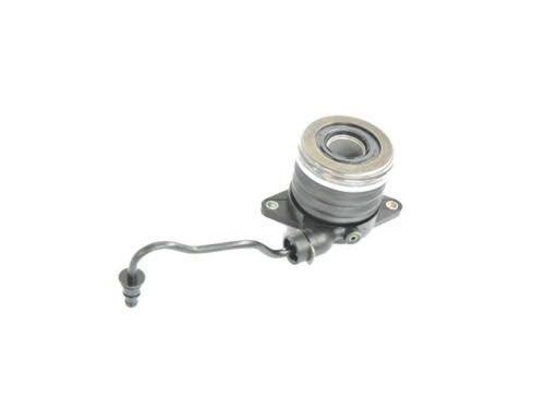

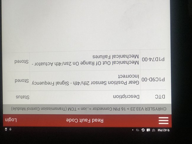

The mechanic asked me if I changed the release bearing before, I said yes because there was a leak, then he asked me if I replaced original new I told him I'm not sure if it was original or not. So, he told me maybe it's not work good and sometimes stuck and appear error code.
(Mechanical out of range on 2nd-4th actuator)
P1D74
And p1c9d (2nd-4th gear sensor position signal incorrect)
What is your opinion bro?

Those are pictures of a throw out bearing for a stick shift car?

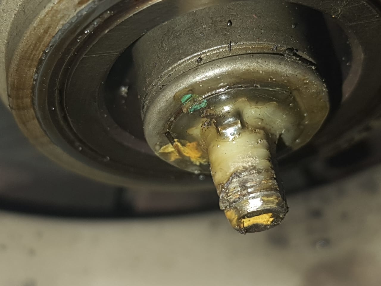

My mechanic found that the old mechanic who worked in it before making big problems by adding glue material to hold the bearing he decided to rebuild it again.

Oh man, that doesn't look good, let me know, I feel we are getting closer to fixing it.

He replaced the k1 bearing and this long shaft inside the transmission because the stupid mechanic before put some glue and internal oil seal damaged and there is some oil on the clutch, he told me he thinks after rebuilding the transmission everything will be good and valve body will not need replacing.

He told me since 1 hour it appear 2-4 gear sensor position so valve body must be replaced.

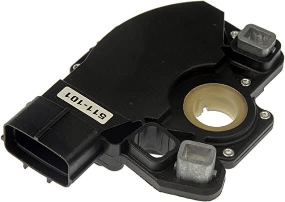

I think its transmission range sensor.
Wednesday, August 3rd, 2022 AT 11:29 PM
KEN L
  • MASTER CERTIFIED MECHANIC
  • 55,522 POSTS
Yep, that could be the problem.
Here is the part number:
Range Sensor 68197332AA $215.00

Same problem today bro, I drove for 30 minutes inside my city suddenly check transmission and start/stop light on also, but when I accelerated car does not respond to move, then I turned it off rest 30 minutes with take off battery cable(-) then I drove it home.
