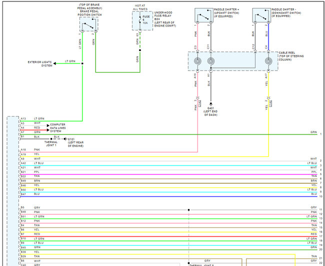

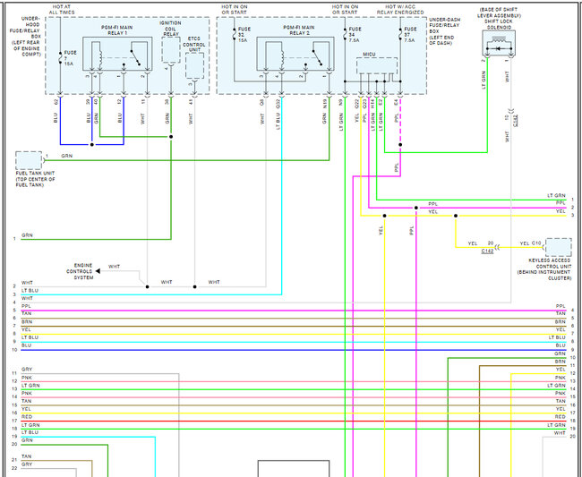

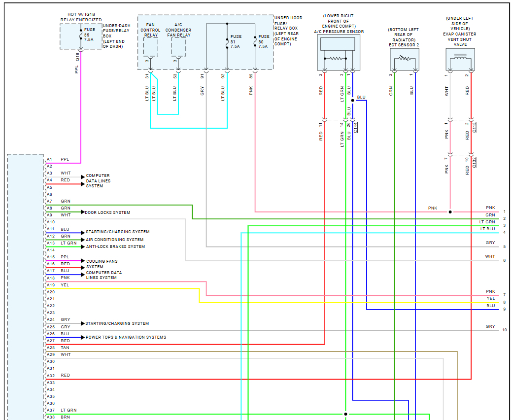

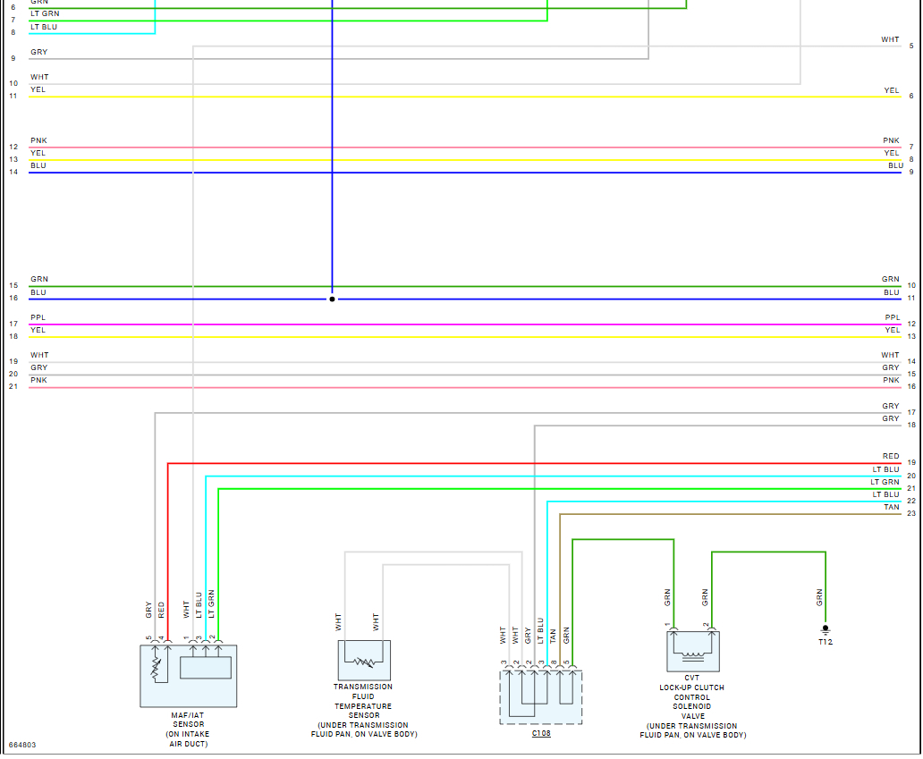

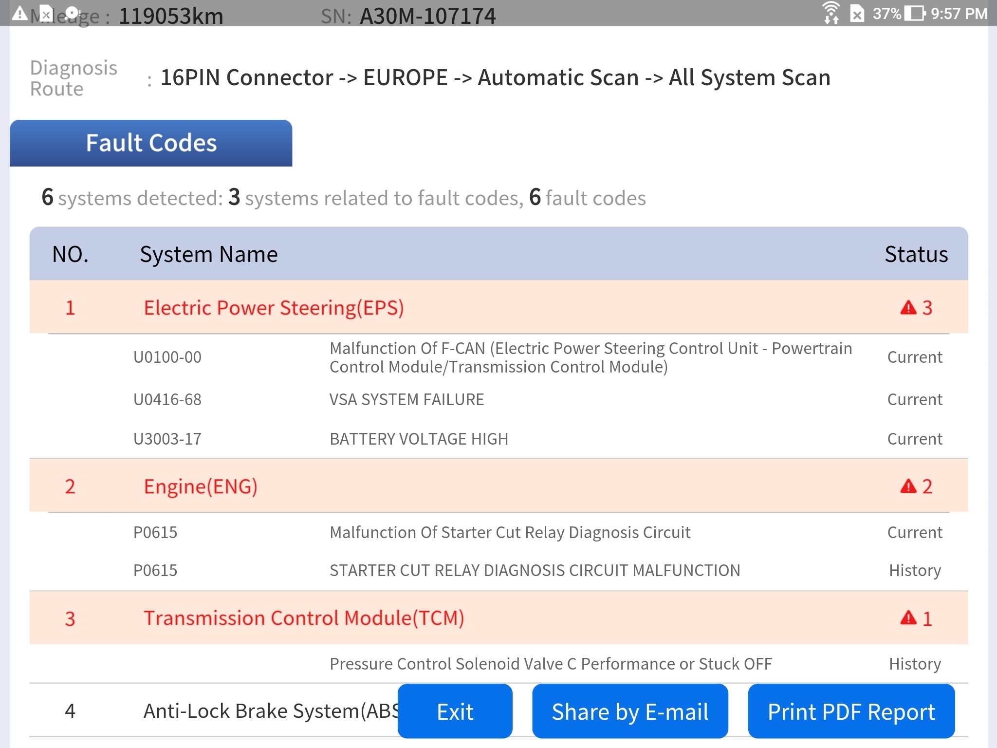

Codes P16E2, P0615, U0100-00 and U0416-68?
MALLYBOY
  • 2019 HONDA HRV
  • 2.4L
  • 4 CYL
  • 2WD
  • 119,210 MILES

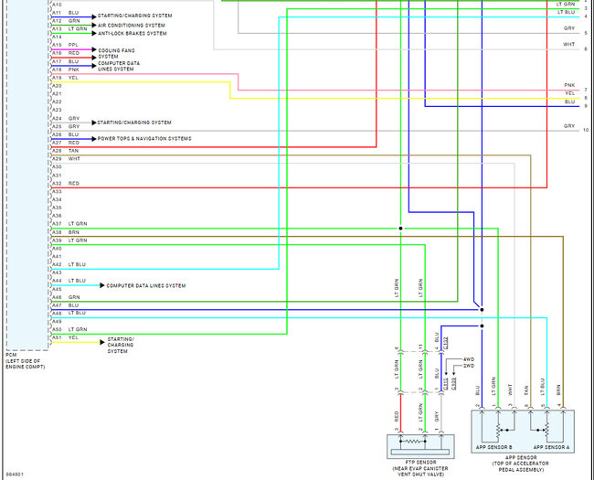

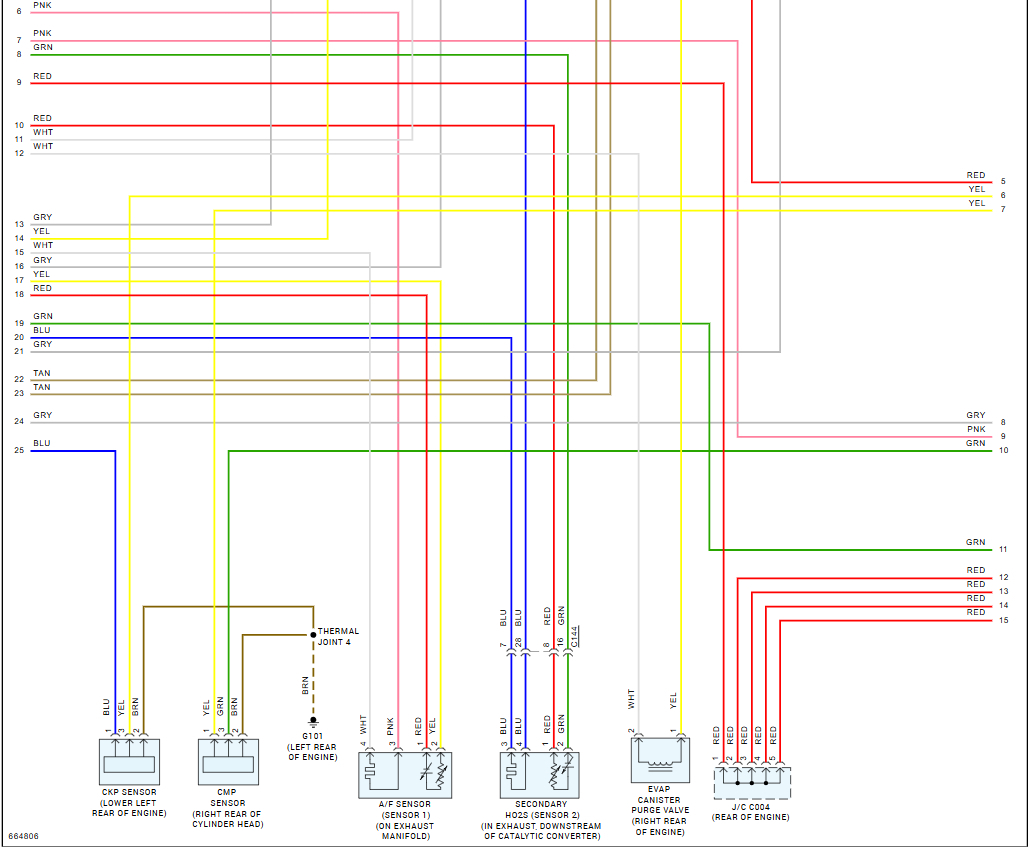

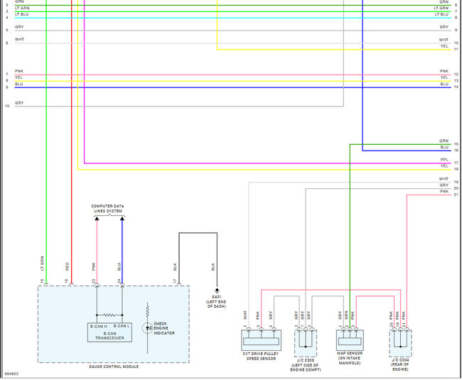

This vehicle transmission CVT chain was broken and there was no place to buy it. The transmission was replaced and the vehicle started disengaging when on drive. Please I need wire diagram from ECM to communication line to check for open circuit. Thanks
Thursday, February 27th, 2025 AT 12:53 PM

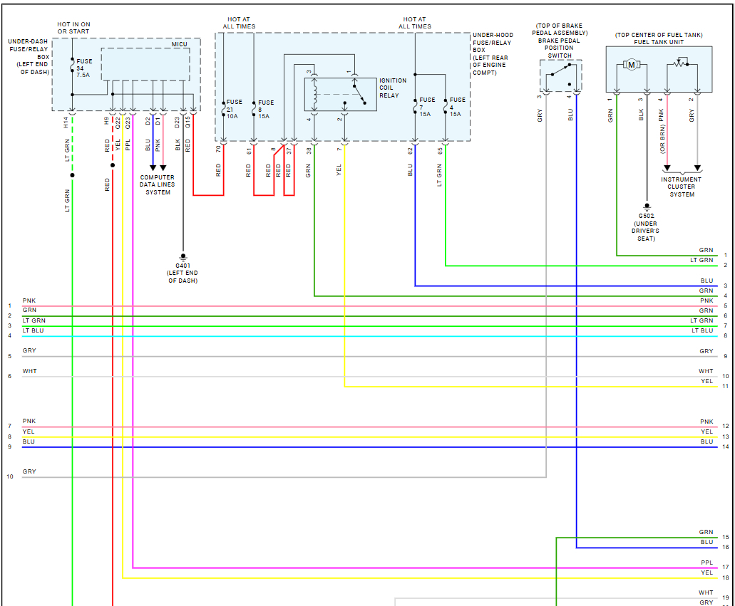

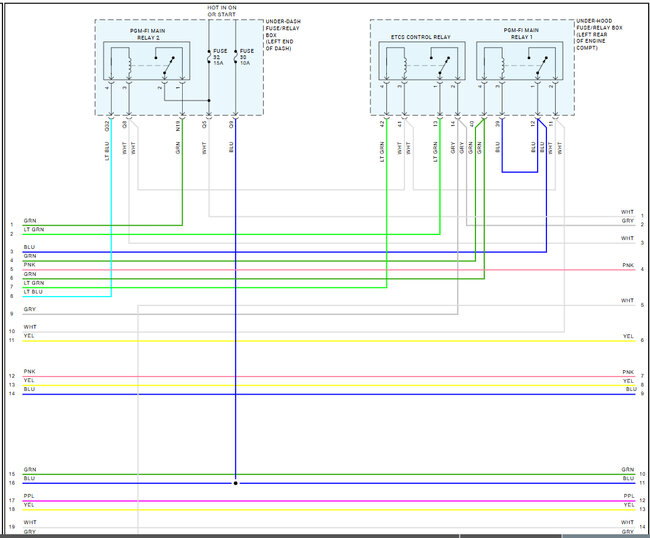

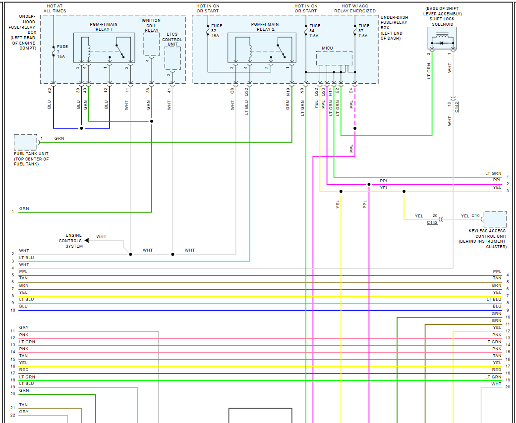

And also fuse box diagram.
Friday, February 28th, 2025 AT 2:12 AM
KEN L
  • MASTER CERTIFIED MECHANIC
  • 55,281 POSTS

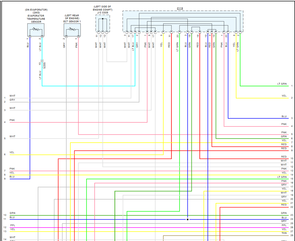

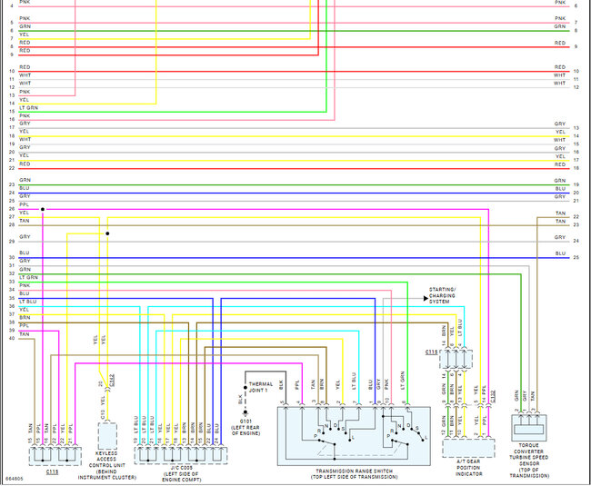

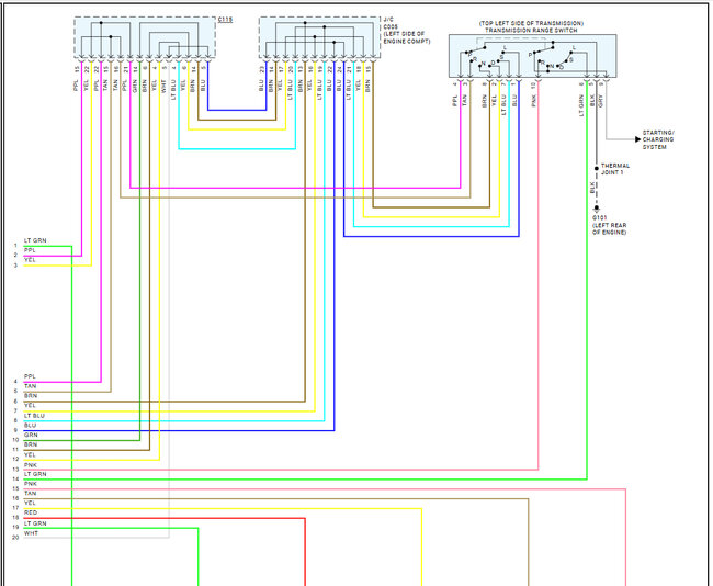

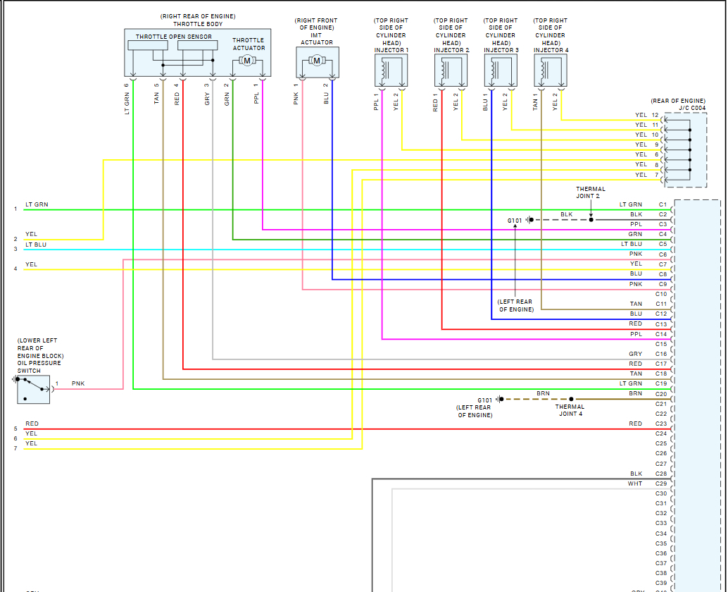

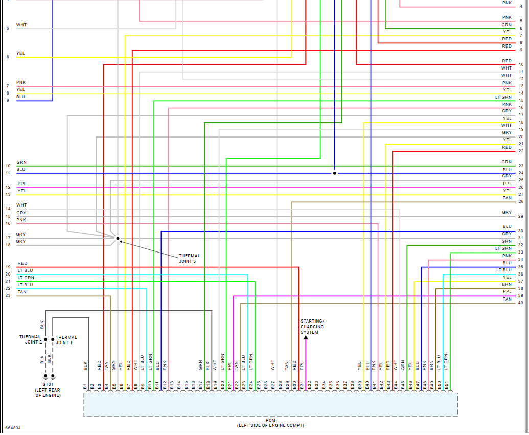

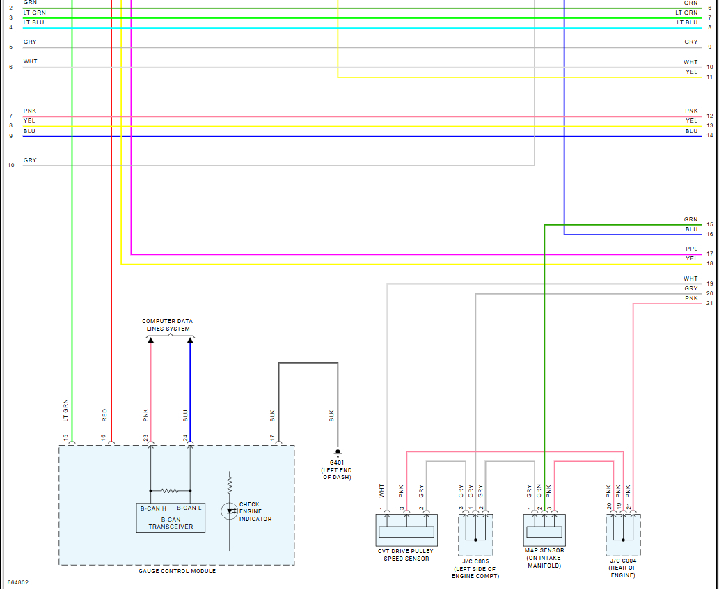

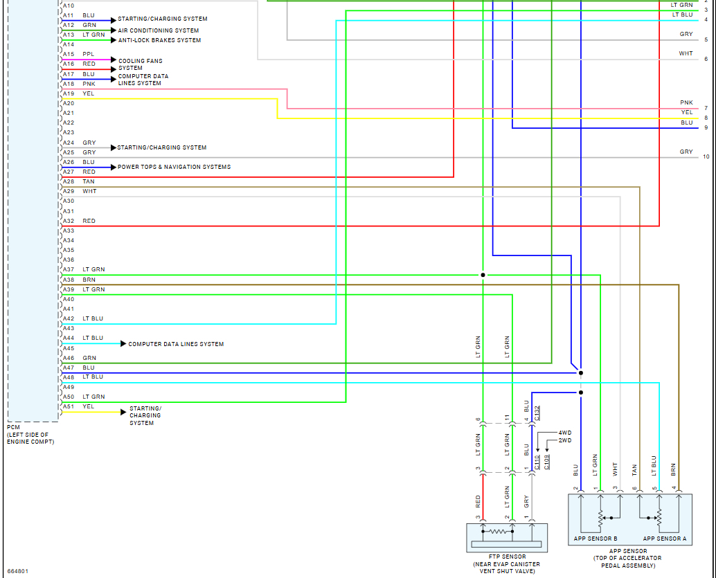

Sure, here are the wiring diagrams for the engine and PCM with a guide to help you test the connections.
Please start a new thread for the fuse panels, check out the images (below). Please let us know what happens.
Friday, February 28th, 2025 AT 7:06 PM

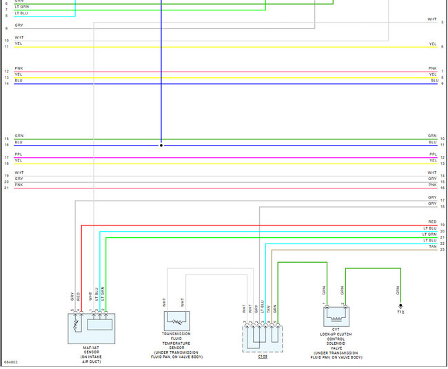

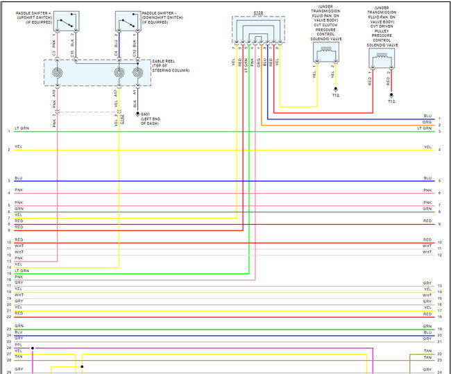

I have check the wiring of this vehicle and correct somethings, but the is still returning P0796: Pressure Control Solenoid C stuck off. Where's the TCM location? Let me replace it and see if it can correct the issue since the transmission has been replaced twice and problem still exist?
Friday, March 21st, 2025 AT 9:50 PM
KEN L
  • 55,281 POSTS

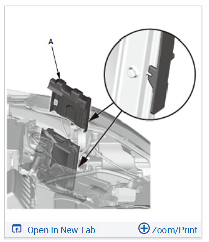

There is no TCM just the PCM. Here is the location, you can get a preprogrammed unit by searching Google or Ebay. Check out the images (below).

Now since the PCM is returning P0796, and whenever the code appears, the vehicle will disengage from Drive or Reverse until you clear the code before it begins to drive forward or reverse. Please where is the Pressure Solenoid C located so that I can replace it and see whether is solve it?
Sunday, March 23rd, 2025 AT 2:39 AM
KEN L
  • 55,281 POSTS

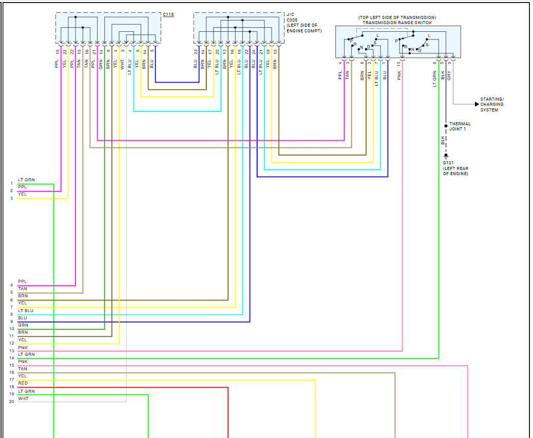

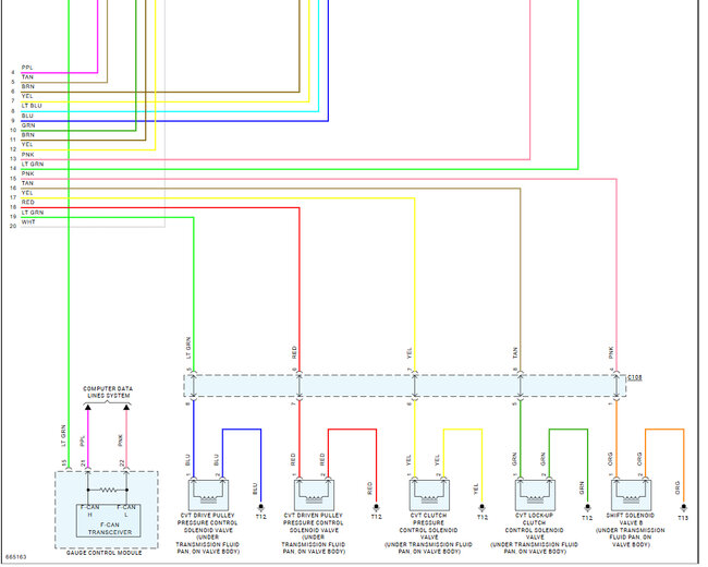

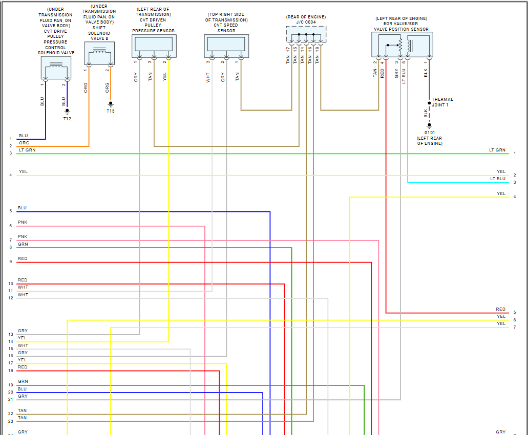

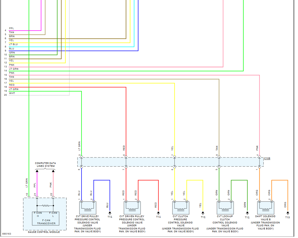

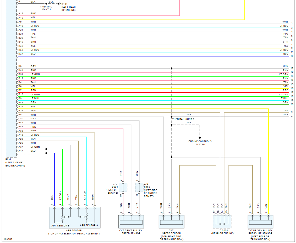

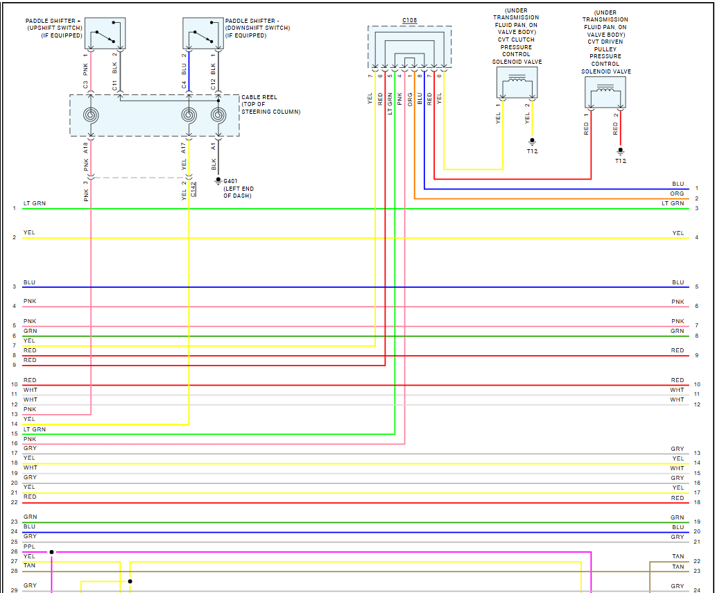

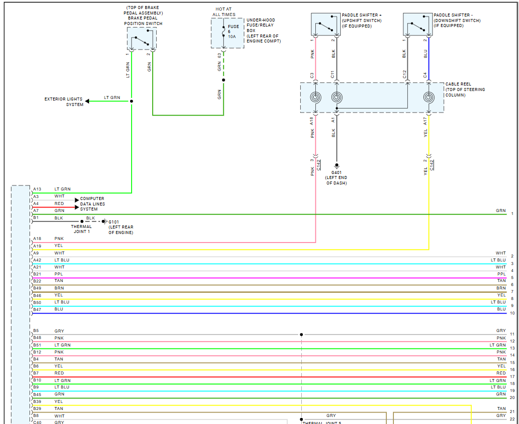

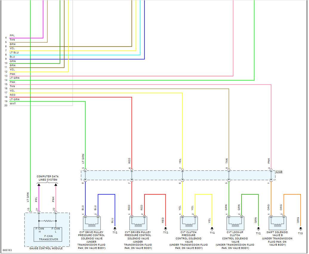

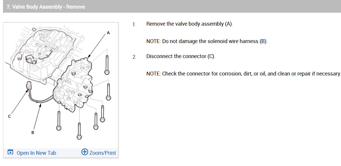

There are 3 pressure control solenoids, here are the wiring diagrams so you can see how the system works and how to remove the valve body to change it out.
https://youtu.be/-iv2yJgVXJM?si=kQgM8pDpI7jknBsC
Check out the images (below). Let us know how it goes.
Sunday, March 23rd, 2025 AT 9:57 AM
MALLYBOY
  • 338 POSTS
Thank you so far!

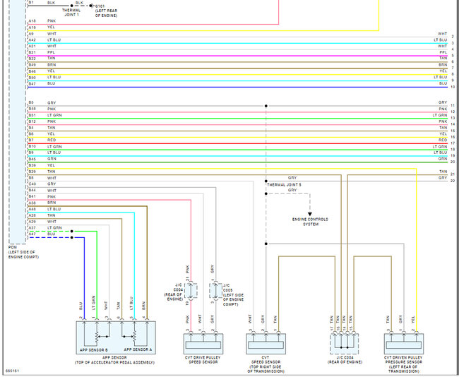

But you didn't specify the particular solenoid for it to be easy. And the diagram was not complete to help me check resistance from PCM? Send a complete diagram to help me locate it?
Monday, March 24th, 2025 AT 3:11 AM
KEN L
  • 55,281 POSTS
Sure, sorry about that, here you go, let me know how it goes. Check out the images (below).

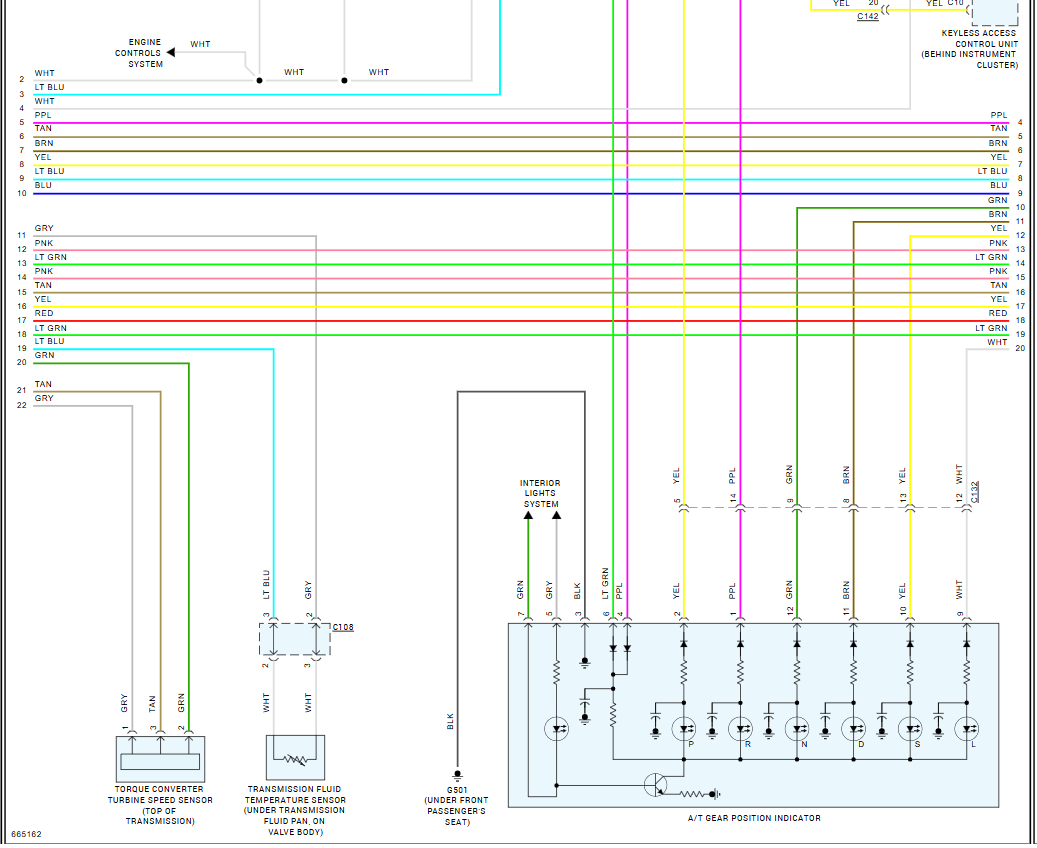

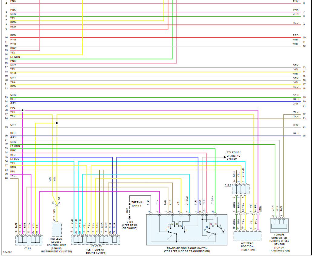

I have replace that pressure control solenoid C and when I was test-driving, the vehicle disengage from Driveand Gear position indicator was blinking at neutral and I scan and it report P0717= Input/turbine speed sensor A Circuit No signal, please where is this sensor located? I attached screenshot below.
Monday, March 31st, 2025 AT 12:50 PM
KEN L
  • 55,281 POSTS
I don't see the image, can you please try again?
Tuesday, April 1st, 2025 AT 8:51 AM
MALLYBOY
  • 338 POSTS
Thank you so far, I have come to tell you that I have solved the problem, that fault code was pointing to torque converter turbine speed sensor. The circuit was interchanged and I used diagram to trace it and solve tjr the problem.
