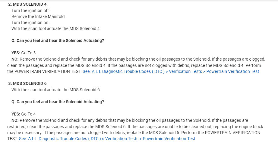

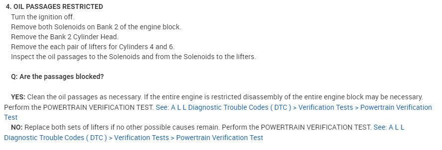

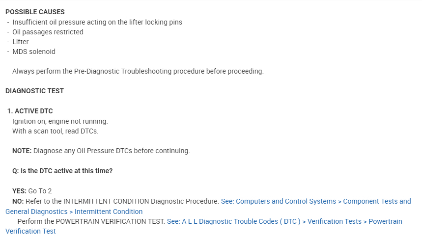

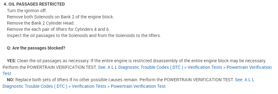

By chance, is the oil light turning on or flickering? I ask because if the sensor is failing, it can cause the P1521. Also, have you removed any MDS solenoids to see if they are contaminated or have a blocked oil passage?
Also, do you have a bidirectional scan tool that can actuate the MDS solenoids to see if they are functional?

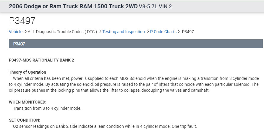

If you look below, I included the diagnostics for the P3497 code. Take a look through them and let me know if it is something you feel comfortable performing.

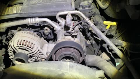

It turns out that the noise was from something completely unrelated, but just happened to start occurring at the same time as the MDS and oil trouble codes! But to answer your question, the oil light has not come on at all, and is not flickering. I have not removed any of the MDS solenoids, but I was thinking about buying the Thinkdiag2 since it seems to be the best value for a scan tool that has bi-directional testing. Not sure how to confirm the limitations of the bi-directional functions, but hopefully it would be capable to commanding-on the MDS solenoids.

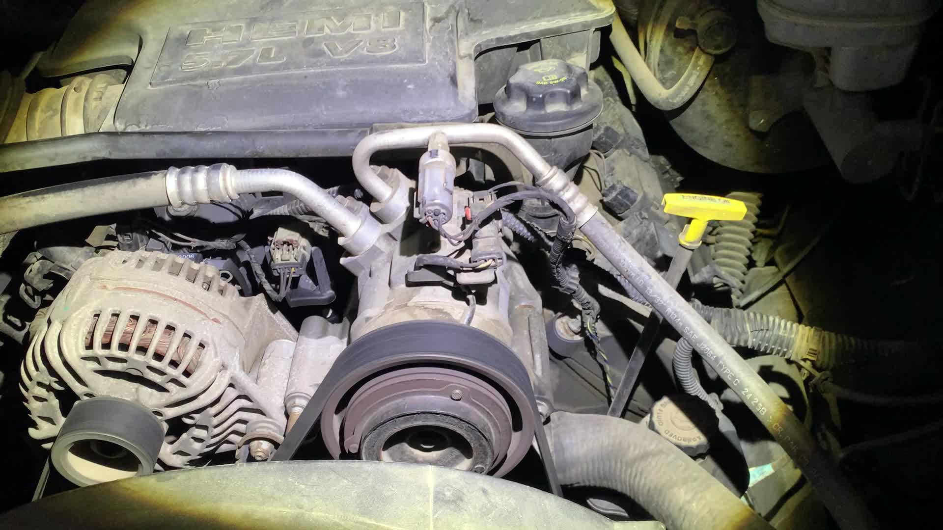

This evening I was able to start the engine cold and take a video of the exact time the noise occurred, and right in front of the engine it sounds a lot different than from inside the vehicle, so it is not really a "rumble" after all. In the video you can actually see the AC compressor clutch stop turning right when the first "rattle" sound happens, and the rattle stops the instant the AC clutch stops spinning. Then a few seconds later the AC clutch starts spinning again, and a few more seconds after that you can hear the rattle sound come back. But just like before, the rattles goes away shortly after and the AC compressor continues to spin without any noise and the AC system continues to function.
Anyway, it seems that perhaps the bearings in the AC compressor are going out?
Is there anything I can do to service this compressor clutch? Due to cost, I would really rather not replace the whole compressor, especially since that would mean evacuating the whole system, and re-charging it. In addition to the compressor cost itself.
Is there any way to either service, or just replace only the clutch on the compressor?

Wow, I agree it is related to the AC compressor/clutch. I noticed the first time it turned itself off, it seemed to lock. The remaining noises could be internal. I have a question. Has anything been done to the AC system? As far as replacing bearings, it would exceed the cost or a replacement. The only thing replaceable would be the clutch/coil. The coil is the electrical component that becomes an electromagnet when energized leading to the engagement of the compressor.
If I had to guess, I don't think that is where the issue is coming from. However, anything is possible. I feel it is within the compressor itself. If it was recharged recently, it could be overcharged or someone may have added too much PAG oil to the system. If it hasn't been serviced, that wouldn't have happened.
At this point, you could remove the clutch and inspect things for wear.
Let me know your thoughts.

Thanks for the video, you can see the clutch on the AC compressor has gone bad, also it seems like the system is overcharged, can you confirm by getting the high side reading?
This guide can help:
If the high side is between 225 and 250 PSI,then you may have too much oil in it.
Saturday, October 14th, 2023 AT 6:07 PM

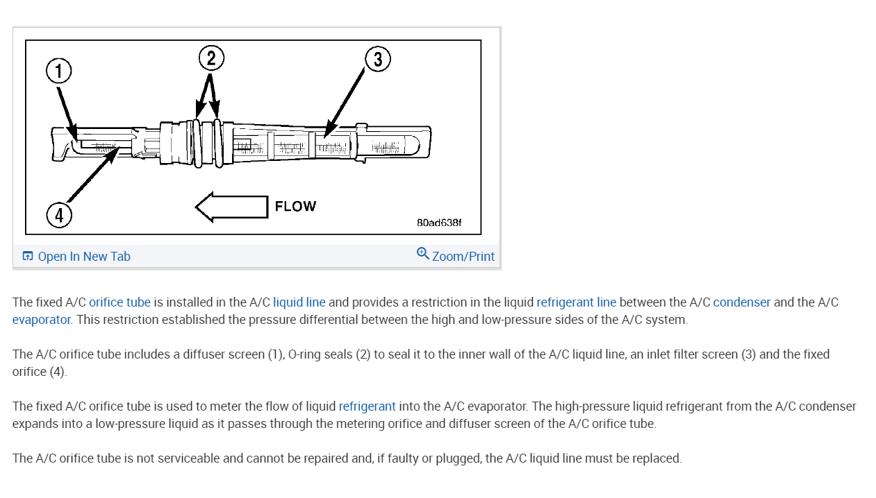

My new set of A/C manifold gauges arrived, so I checked the pressure and noticed right away that it was much too high on high side. Well over 300psi. I had it discharged and here is what I am seeing now with only a little refrigerant in it.
When first turning on the A/C with engine running, the low side goes to 10 psi and high side goes up to about 175psi, but then both low and high side slowly start climbing. The low side goes up to about 20 and the high side climbs up to 250 and continues slowly climbing up as high as 300. It takes several minutes of running to get up to 300 psi. After running
Now that the system was discharged, the low side is too low, indicating more refrigerant is needed, but the high side is still too high. The compressor is no longer stopping. It continues running and is not making any noises at all, but the AC is no longer blowing cool.
Previously before discharging it, it only blew cool and never truly cold. Now it is completely lukewarm and not cool at all. I would have thought that meant I just needed to add more refrigerant, but the high side is much too high still.
After sitting with the engine off for at least 45 minutes, the stagnant pressure on both the low and high side is about 60, but after starting the engine and turning on the AC again, the low side went to 0 and the high side to about 75. Within one minute the low side as at 6 and the high side at 150. Within 2 minutes the high side continued to climb up to 200 and the low side to 11. Another minute or 2 later the high side hit 225 and the low side was 14. Another minute and the high was at 250 and the low at 15.
What would cause the high side to keep slowly climbing and get to such a high PSI reading?

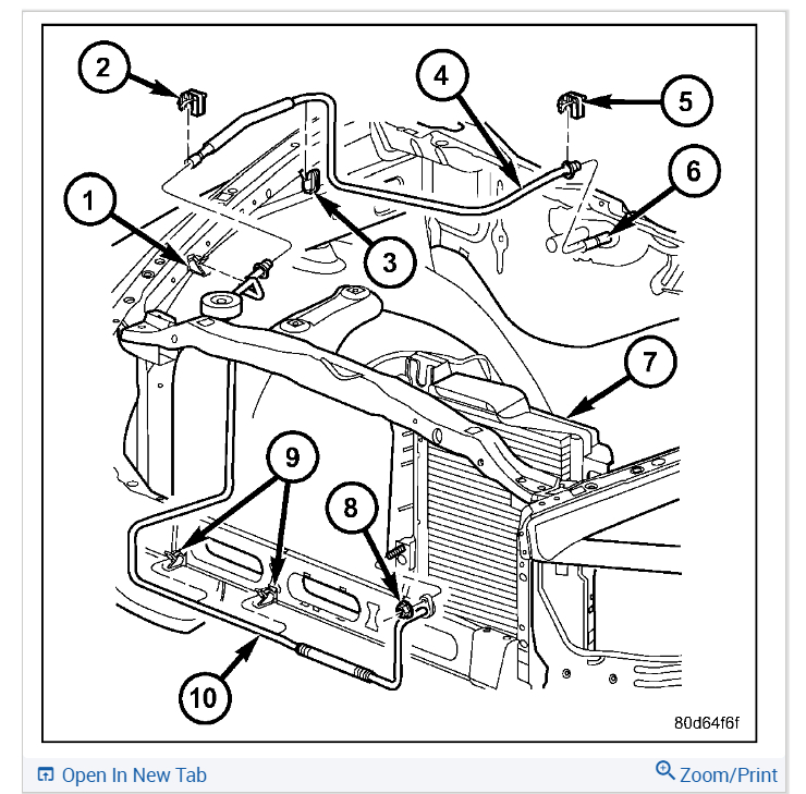

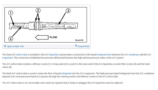

This would be a clogged orifice tube, or the cooling fan is not working. I would discharge the system to check the orifice tube if the cooling fan is working good. Check out the images (below). Please let us know how it goes.

As far as your question, yes. If the orifice tube is partially plugged, it will restrict the refrigerant from the evaporator preventing it from properly cooling.
When replacing the orifice tube, there are times when the evaporator itself may be clogged and need to be replaced.
At this point, I would focus on the orifice tube/liquid line. I feel that will take care of the problems. If Ken feels differently, I feel he will jump in.
