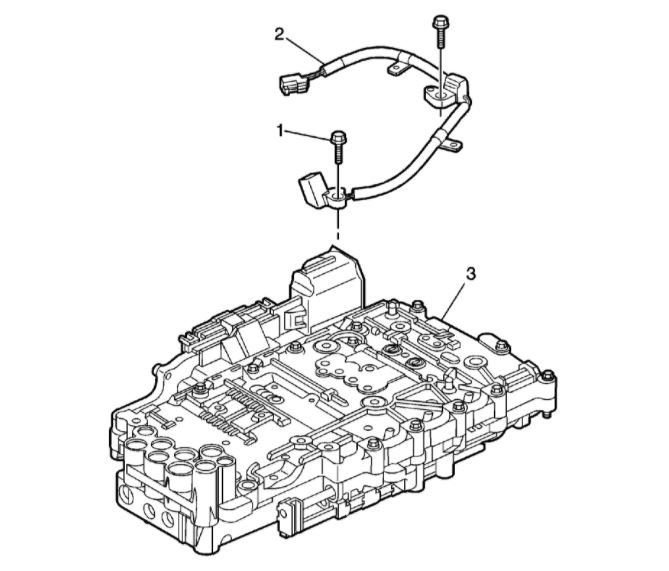

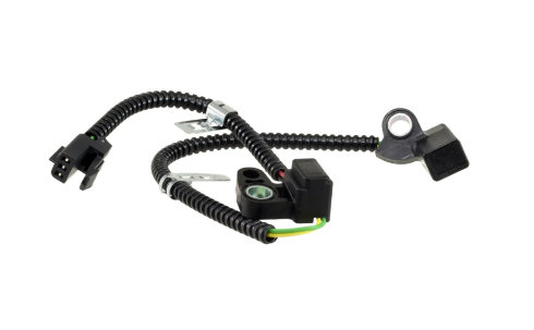

The input speed sensor is located inside of the transmission pan.
The input speed sensor (ISS) is a hall-effect type sensor. The ISS mounts to the control valve upper body assembly and connects to the control solenoid
(w/body and TCM) valve assembly through a wire harness and connector.

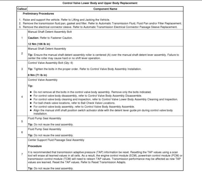

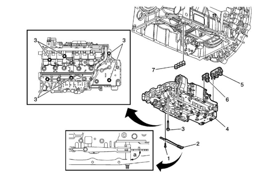

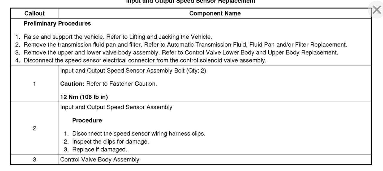

Thank you! If I were to drop the pan, the ISS should be easily accessible for replacing?
Nov 18, 2020 at 12:33 PM
Good afternoon,
I attached the procedure for the replacement for you.
The valve body has to be removed to gain access to the speed sensor.
Nov 18, 2020 at 2:05 PM
