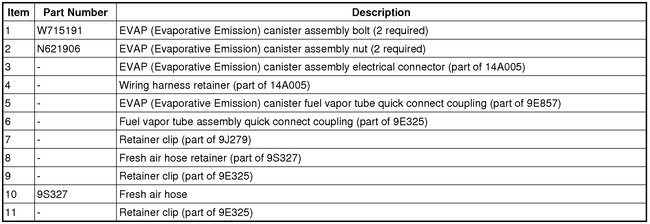

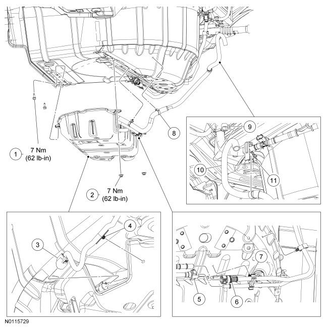

I would look closely at the evap canister under the rear of the car under the trunk area. I've replaced tons of these after people hit debris on highway or go over curbs etc. A damaged canister can also cause the fuel filler nozzle to click before the vehicle is actually full. I included a blow up of the evap canister and lines, inspect the lines at the left rear wheel well areas as well.
