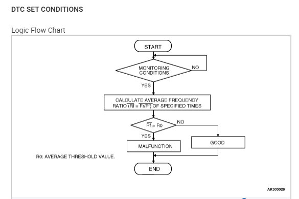

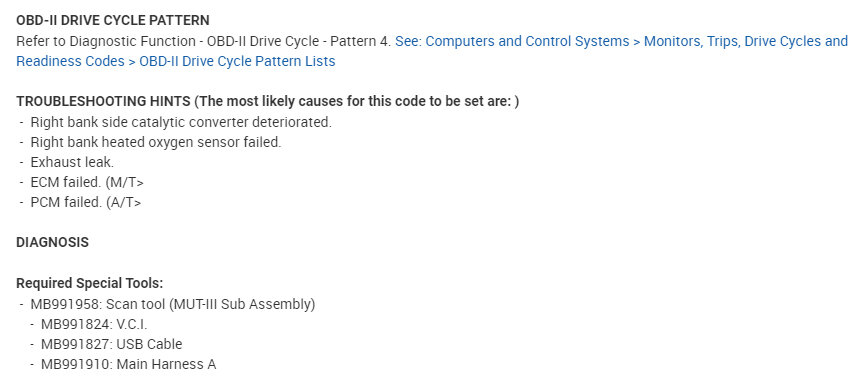

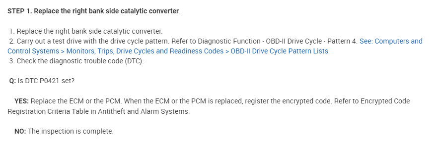

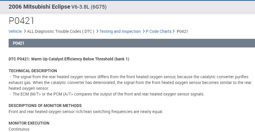

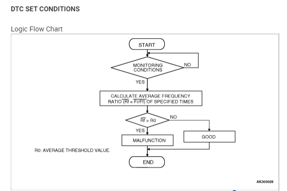

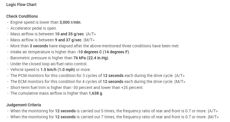

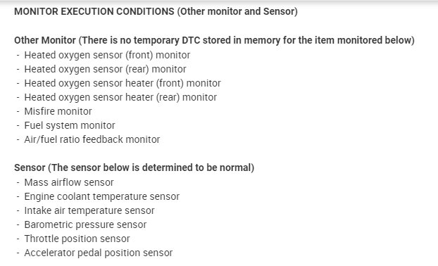

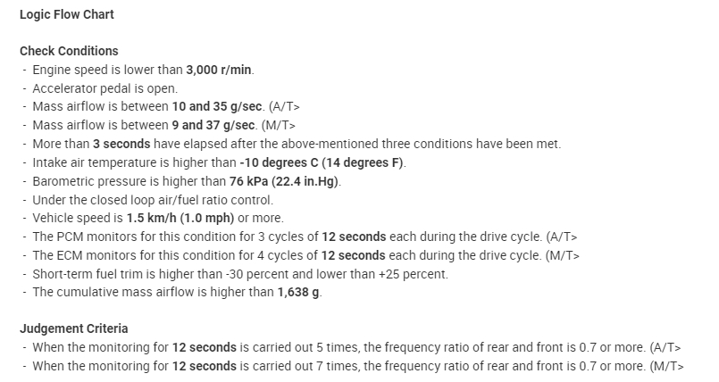

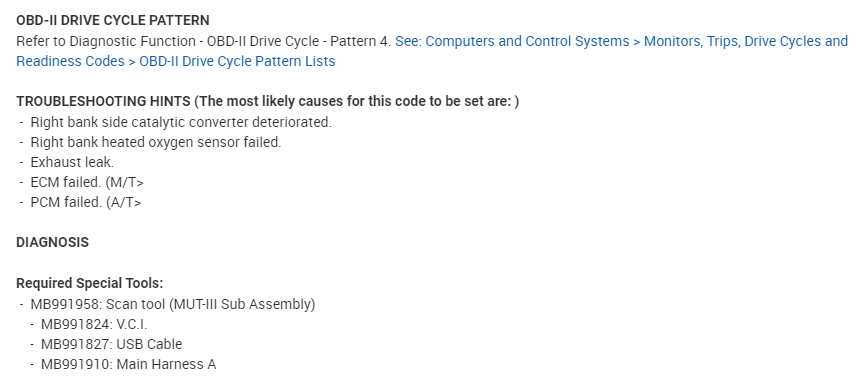

As far as the code is concerned, it is specific to the warm-up catalyst (bank 1) is not working properly. I attached information below related to this code. It explains the code, what could be possible issues, and what to check.
Is this the only code you have? Also, the sensor you mentioned shouldn't stay flat at all times. Have you checked to see if there is a wiring or connection issue?

As far as checking for an exhaust leak, the leak will need to be before the catalytic converters to affect the sensors. If it is at the exhaust manifold, often times it will sound like a ticking noise.
