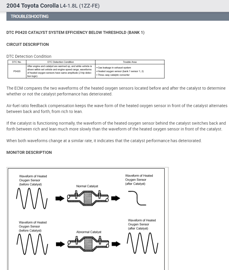

Code p0420
2004 TOYOTA COROLLA
208,000 MILES • 1.8L • 4 CYL • 2WD • MANUAL
YAZIDAN

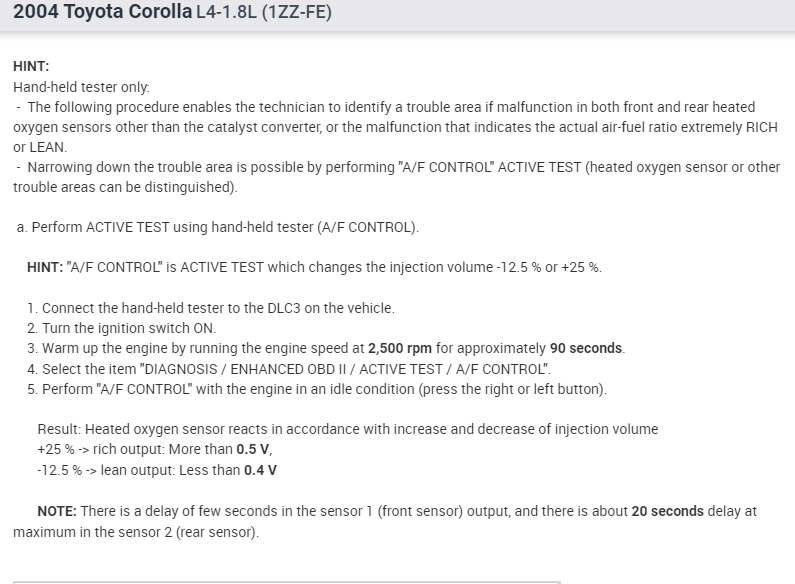

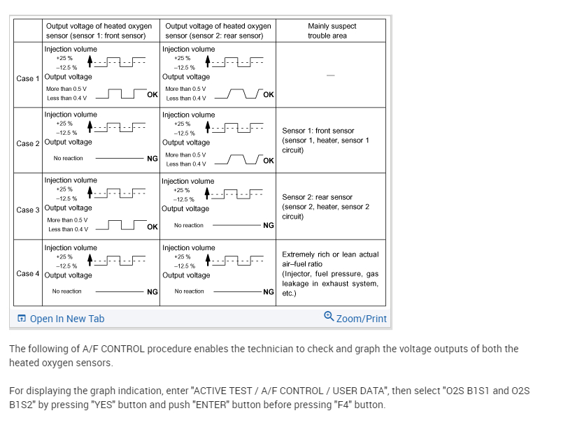

The previous owner replaced the catalytic converter last year. What can cause a catalytic converter below threshold? i checked the voltage at idle of the post o2 sensor. It was lean and steady around 0.135 V.
Thank you
Feb 27, 2022 at 3:49 PM
SQM
  • 6,383 POSTS

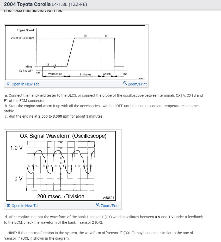

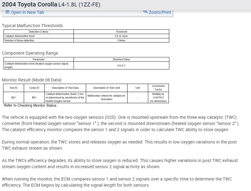

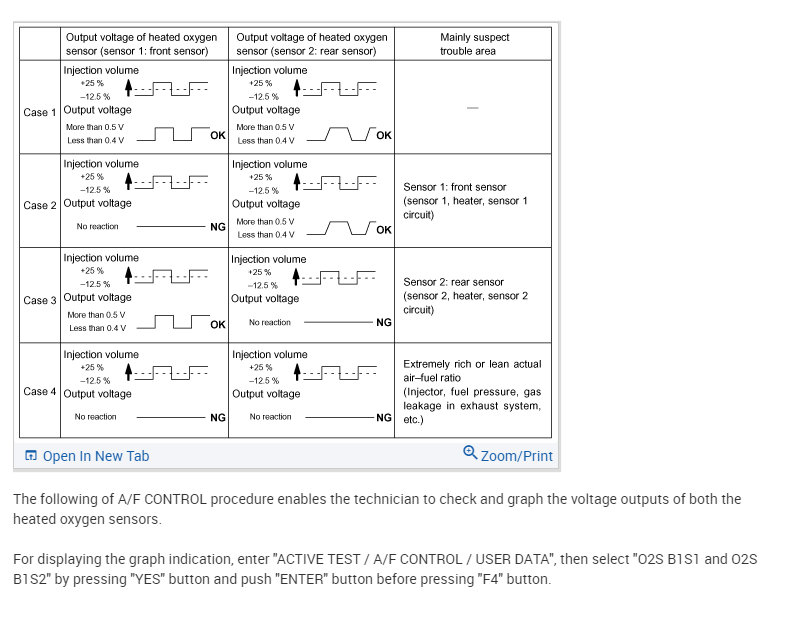

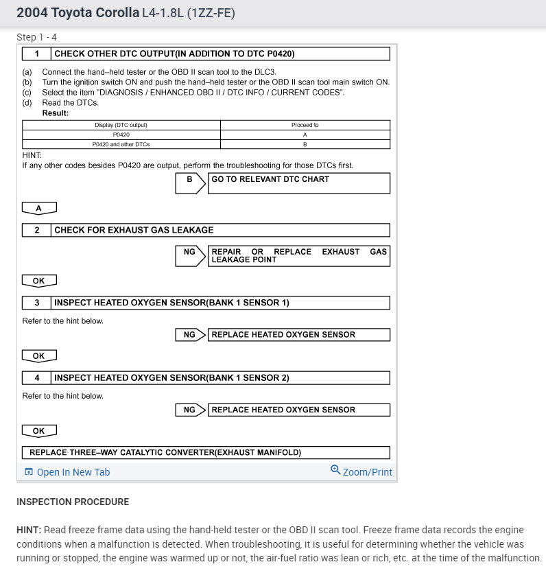

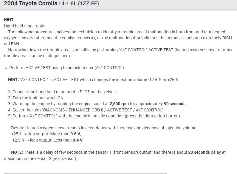

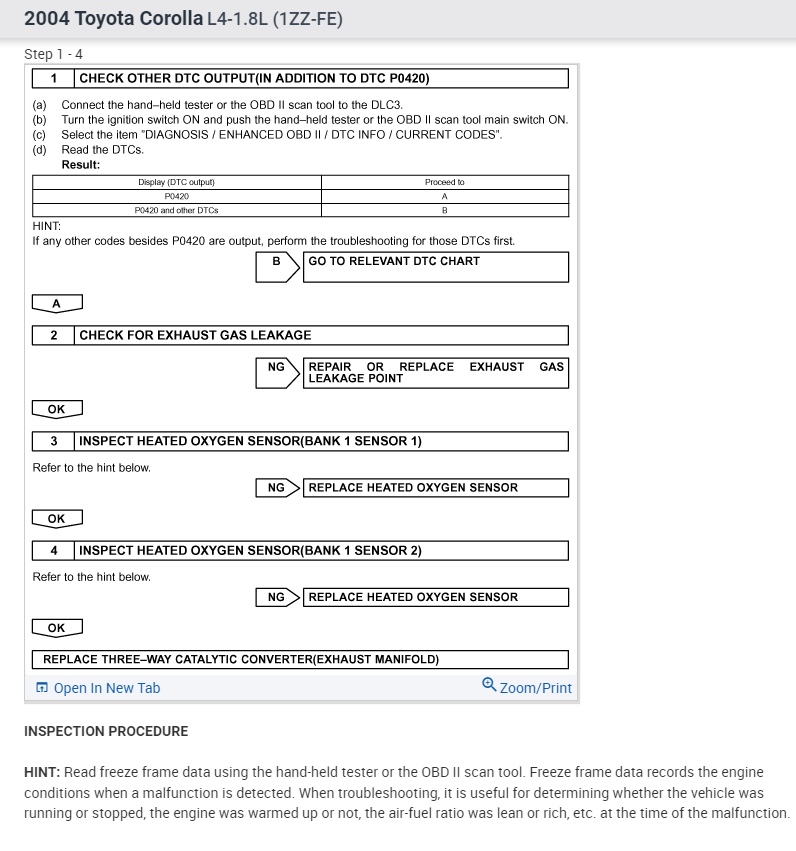

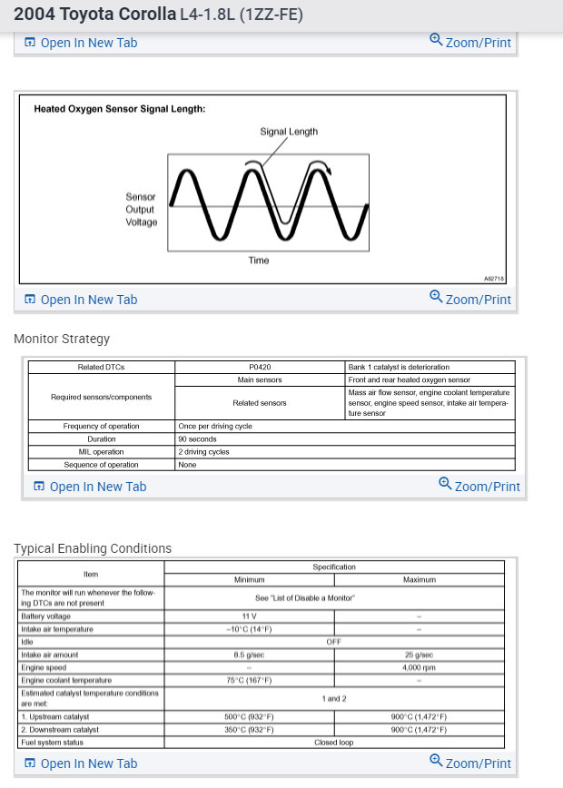

The P0420 code can get triggered due to a bad oxygen sensor, catalytic converter or an exhaust leak.
https://www.2carpros.com/articles/how-to-test-an-oxygen-sensor-02-sensor
I have attached the trouble shooting guide for the code P0420 below. Take a look at this as it provides a lot of helpful tips on what to look for.
