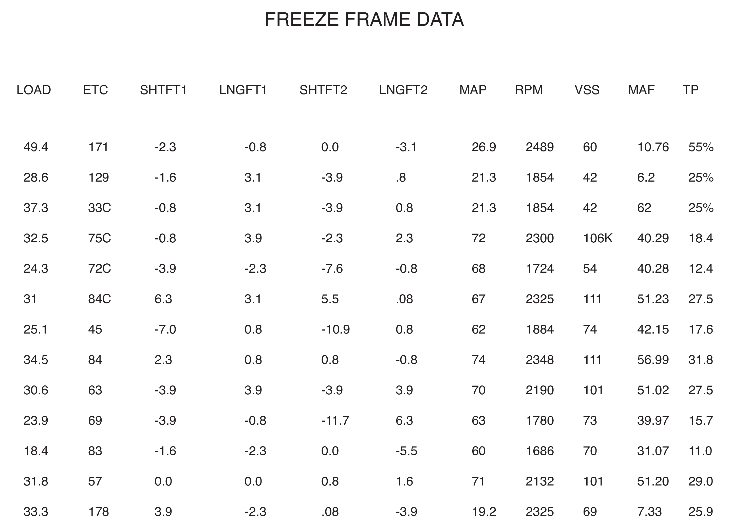

I still have a P0300 code problem going on. Runs pretty bad.
I have replaced the following: Plugs, wires, distributor cap and rotor,
Spider injectors, coolant temperature sensor, fuel pump, map sensor, MAF sensor, ignition coil, and probably a few other items along the way.
The fuel pressure is within specs.
I have not yet checked for back pressure from the catalytic converter, although it doesn't run that bad at high speeds.
I try to understand the fuel trim data and the o2 sensor stuff, but it is quite confusing to me. I have enclosed several of the freeze frame data I have accumulated, and perhaps you can see causes there. I have also enclosed a video of live data at idle.
I sure hope you can help, because I am running out of things to buy!

The fuel trims are perfect along with all other things I saw. You want the trims to be as close to 0 as possible, and yours stay well within the specs. What a negative trim indicates is that the O2 sensor is indicating the fuel mixture to be slightly rich, and the computer is trying to compensate by shortening the time the injectors are open. The opposite happens when they are positive. However, as mentioned, your's are good.
Now, have you replaced the crankshaft position sensor?

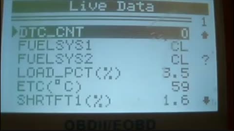

As far as the ECT reading of 60C, it is reading in Celsius and not Fahrenheit which you already know. That is equal to 140°F. That is not up to operating temp. If the engine doesn't get warmer than that, it can cause issues.
Can you let me know how long the P0300 takes to show up after the code is deleted? Do you feel any misfire while driving? Is that the only code you are getting? I ask because it is possible for a faulty crankshaft sensor will not set a code.

The two important PIDs to watch on the live data is the O2B1S1 and O2B2S1. These are the upstream oxygen sensors that your vehicle's Power-train Control Module (PCM) or "computer" uses to adjust the fuel going to your vehicle's fuel injectors. The voltage that they produce should fluctuate from 0.1V to 0.9V. It is reading the oxygen content of the exhaust. The PCM is trying to keep the air:fuel ratio at stiochmetric which the perfect combustion rate. Stoichmetric air:fuel ratio is 14.7:1. This is because at sea level it is 14.7 miles to the top of the atmosphere. So your vehicle's PCM is adding fuel until the O2 sensor reads rich(0.5V - 0.9V) and then it subtracts fuel until the O2 sensor reads lean(0.5V - 0.1V) and then adds fuel until it reads rich and so on. This way it is constantly adjusting keeping the air fuel ratio as close to stoichmetric as possible.
From the video you shot your O2 sensors were working perfectly. Did you clear the Direct Trouble Code out of the PCM when you replaced your spark plugs?

Did the Freeze Frame Data I supplied indicate anything at higher speeds when the code was set off? I put in enough information from several events. Seems like something should have stood out.

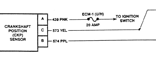

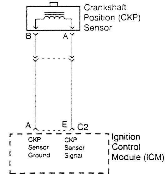

The sensor can be tested.
A) Disconnect the CKP sensor harness. Connect an LED test light between battery ground and CKP harness terminal A.
B) With the ignition ON and the engine off, verify that the test light illuminates.
If not as specified, repair or replace the fuse and/or wiring.
C) Carefully connect the test light between CKP harness terminal A and B. Verify that the test light illuminates.
D) If not as specified, repair the CKP harness ground circuit (terminal B ).
E) Turn the ignition OFF and disconnect the test light.
F) Next, connect suitable jumper wires between the CKP sensor and CKP sensor harness. G) Connect a duty cycle meter to the jumper wire corresponding to CKP terminal C and battery ground.
H) Crank the engine and verify that the duty cycle signal is between 40-60%.
I) If it is not as specified, the CKP sensor may be faulty.
J) Next, connect a AC volt meter to the jumper wire corresponding to CKP terminal C and battery ground.
K) Crank the engine and verify that the AC voltage signal is at least 10.0 volts.
If not as specified the CKP sensor may be faulty.
__________________________
To determine duty cycle, you will need a multi meter. Most have a DMM setting to measure frequency.
I attached a couple pictures with the wiring to the CKP you may find helpful.
Let us know.
Tuesday, April 9th, 2019 AT 7:01 PM

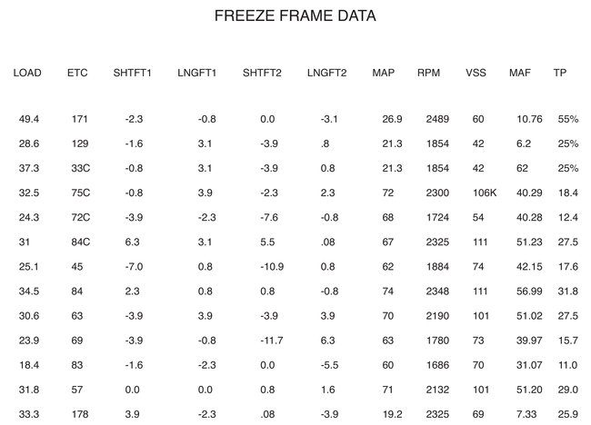

Did you see the data that I enclosed before on the Freeze Frame data from several fault codes (Po300)? (Beginning of post)
I would think that is where we might see something.
I've also enclosed below two videos....one from February 28th and one from tonight.
Maybe there is some useful information there.

I was just reviewing this one and it looks like the short term fuel trims are just fine at idle. You show them bouncing around 0 and then dropping to about -2. This is ok as the PCM will be able to adjust for this and will not directly cause a misfire. Remember that the PCM uses the IAC, MAF, MAP, Baro, to calculate what the air/fuel ratio should be. It then monitors the o2 sensors to see how it did. The goal is to stay at 14.7:1 and a short term fuel trim of zero is this ideal state. So the fact that it is bouncing back and forth from positive to negative shows that the PCM is able to add and remove fuel in order to keep it around 0.
Also, the PCM on these older engines can only control fuel to match the amount of air that is coming in. So an accurate air flow is crucial. Based on these numbers on the recordings that you have, it looks like the volumetric efficiency at idle is about 54%. This number seems off so I am thinking you have a MAF sensor issue but I see you replaced it. So let's run this test at wide open throttle so we can see what the VE is at that point. A healthy engine should be between 75-90% efficient at WOT.
If you can take that scan tool and write down these numbers while doing a WOT stab, it should help point us in a good direction. DO NOT hold it at wide open in order to get all of the numbers. Do one at a time and record the highest number that you see for each.

Multi cylinder misfires codes with no specific cylinder misfire code, is saying that the PCM is not seeing a crankshaft acceleration after it fires the spark plug on various cylinders. However, it is not a consistent misfire. Meaning any given cylinder gives the PCM the expected acceleration but then on the next stroke it does not. Usually, these are related to fuel delivery or air delivery.
It could be a restricted converter so if you just pull out the upstream o2 sensors and run it and see if it smooths out. If it does, then a restricted converter is your issue. If it does not, can you reinstall the o2 sensor and perform the wide open throttle stab and record the numbers above?

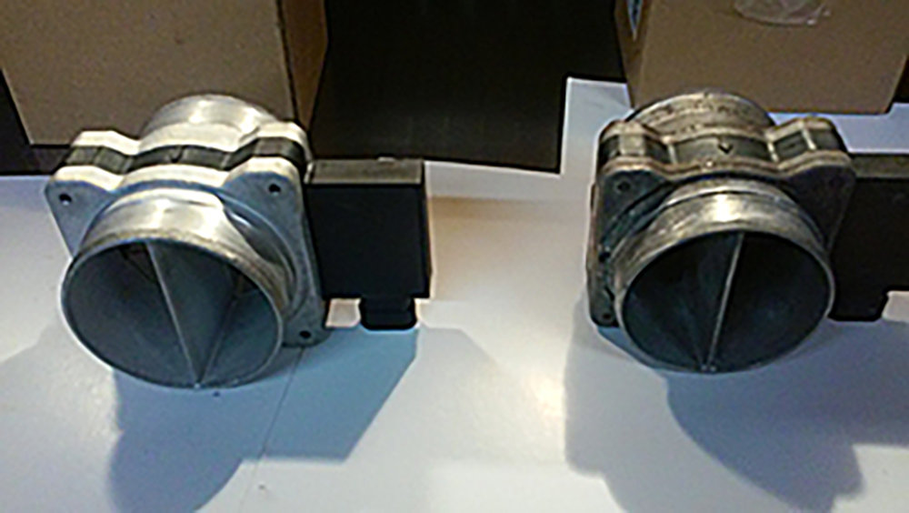

Speaking of MAF sensors:
Check out the enclosed photos.
I ordered one just to be on the safe side in case the one in the truck was faulty.
The one they sent idled at 6? So I asked to return it as I was told to expect it to be close to 4.3 at idle. Well, they sent the one that is currently in the truck, and never asked me to send back the one I questioned.
Now I have a total of three and I don't know if any are good?

That is great. Based on these numbers you volumetric efficiency is 68%. This is not horrible but it is a touch low.
What this means is there could be a restriction in the air intake system, a malfunctioning MAF, or exhaust restriction. Most likely exhaust because you replaced the MAF and your short term fuel trim are a touch on the negative side.
Before you go any further, remove the air filter and inspect the intake snorkel then just run it at idle and see if it clears up a little. I assume it is missing at idle based on what you said earlier. Also, remove the upstream o2 sensors and see how it runs.
Lastly, if you can find your compression readings that you mentioned earlier that would be great. Hopefully you have them on all six cylinders.

To answer your question about the MAF. I am concerned about this. In my experience it should be around 2 g/s at idle and then climb when you accelerate. Your MAF is around 5.5-6 g/s at idle. This means the PCM is seeing a larger amount of air coming in and it thinks it needs to add fuel in order to achieve the 14.7:1 ratio. Hence your short term fuel trim being a little rich and the PCM commanding it to go lean. I think this command to go lean is actually what is causing your misfire.
Anyway, removing the o2 sensor and running it will prove out a clogged converter. It could still be carbon on your valves that is restricting flow but this is unlikely to cause a bad misfire as you describe.
