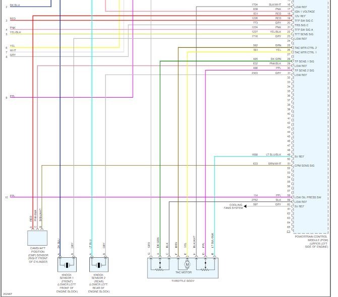

Vehicle started losing power almost felt like driving into a strong head wind. Then next day P0172 fault code came up. Changed mass air flow sensor, cleaned throttle body, check fuel pressure and did the leak down test, and changed upstream O2 sensor to rule out. Motor starts right up hot or cold and idles fine. Does not seem to shift smooth but thinking it’s related to lack of power. Going for vacuum lines next but any other input would be appreciated.

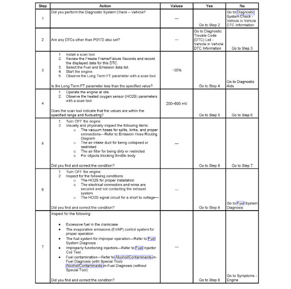

Good morning,
The code is rich running in the fuel mapping.
The most common cause is the purge valve for the emission system.
DTC P0172
CIRCUIT DESCRIPTION
The powertrain control module (PCM) controls the air/fuel metering system in order to provide the best possible combination of driveability, fuel economy, and emission control. Fuel delivery is controlled differently during Open Loop and Closed Loop. During Open Loop, the PCM determines fuel delivery based on sensor signals, without heated oxygen sensor (HO2S) input. During Closed Loop, the PCM adds HO2S inputs and level of purge to calculate the short and long term fuel trim adjustments. If the HO2S indicates a lean condition, the fuel trim values will be greater than 0 percent. If the HO2S indicates a rich condition, the fuel trim values will be below 0 percent. The short term fuel trim values change rapidly in response to the HO2S voltage signals. The long term fuel trim makes coarse adjustments in order to maintain an air/fuel ratio of 14.7:1 The fuel trim diagnostic will conduct a test to determine if a rich failure actually exists or if excessive vapor from the evaporative emission (EVAP) canister is causing a rich condition. This DTC is continuously monitored during engine operation. If the PCM detects an excessively rich condition, DTC P0172 sets.

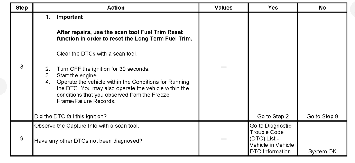

- Clear the MIL and the DTC with a scan tool.
DIAGNOSTIC AIDS
- Fuel contamination, such as water and alcohol, will affect the fuel trim.
- The system will go rich if the injectors are supplying too much fuel.
- Using the scan tool, review the Failure Records. If an intermittent condition is suspected, refer to Intermittent Conditions. See: Computers and Control Systems > Initial Inspection and Diagnostic Overview > Intermittent Conditions

I would not blow off a compression issue.
I attached a wire diagram for you of the throttle actuator.

Unfortunately no. What I don’t understand is the fault code is bank one running rich but yet the throttle body doesn’t open. Is this to keep you at reduced power? Because of the fault code?
Saturday, April 13th, 2019 AT 1:29 PM
No, low power is not from the code. That comes from the throttle actuator or pedal sensor. There is a code associated with that.
