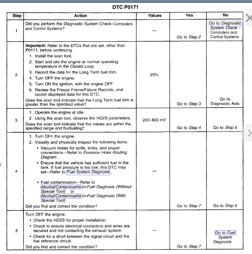

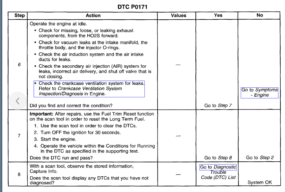

Can you help me with which direction I should go?
my freeze frames read:
fuelsysa- CL
load_pct- 23.1
ect (c°)- 39
shrtft% 0.8
longft%- 14.1
MAP (kpa)- 80
rpm-2030.00
MAF(g/s) -40.73
TP (%)- 19.2
Monday, June 15th, 2020 AT 2:52 PM
MECHANIC
18,907 POSTS

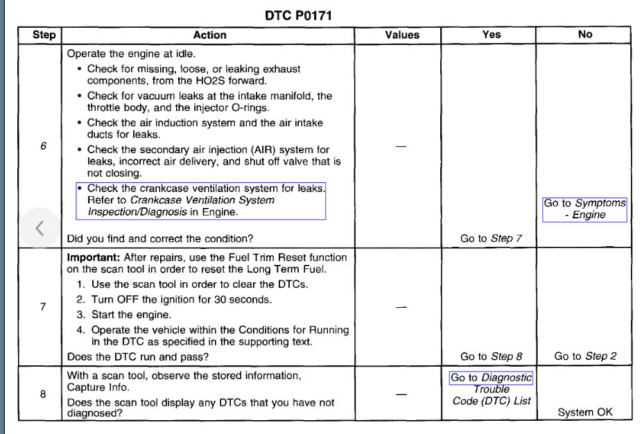

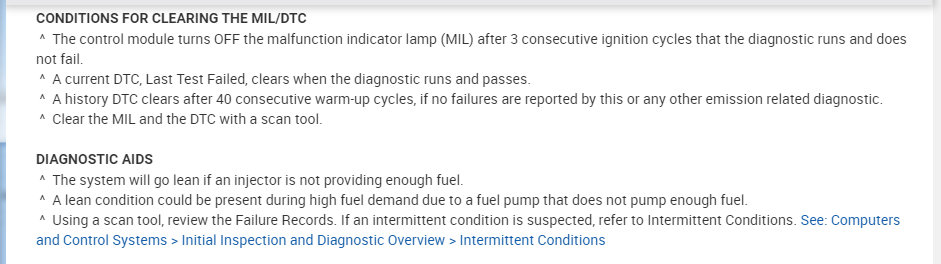

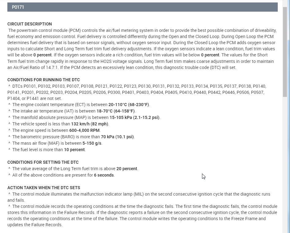

There are a number of things that can cause this. First and foremost is a vacuum leak.
However, we need to run through the testing shown in the attachments.
Also, here is a guide that goes through most of the same things but just a different format. Let me know what you find with the testing and we can go from there. Thanks
https://www.2carpros.com/articles/repair-lean-mixture-codes-p0171-or-p0174-on-some-manufacturers
