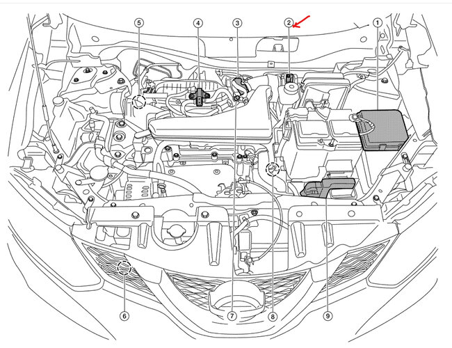

This is a sign the MAF sensor has gone bad. Here is the location of the MAF sensor which is near the brake master cylinder. Check out the images (below). Let us know if you need anything else.

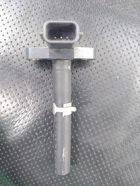

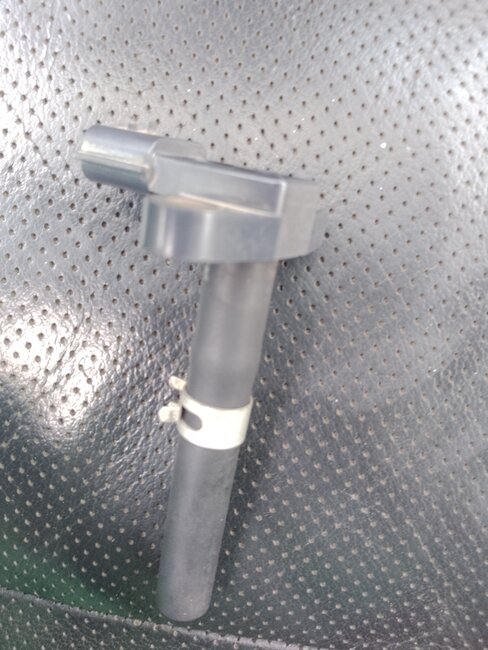

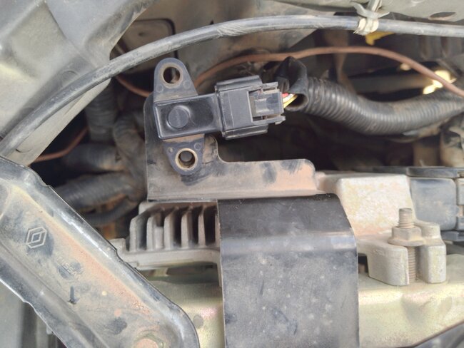

I saw one sensor close to the radiator, with three terminals. I measured the voltage at the sensor connector while the engine is running. With the sensor detached, the first pin was 5v, second pin was 13.5v, third pin was 0.1v (ground).
Could it be the sensor?
Apr 10, 2025 at 12:06 PM
  • 54,503 POSTS
I see the vacuum hose going to it, does it connect to engine vacuum? If so, this can be the MAP sensor.
Apr 11, 2025 at 10:02 AM
BLESSING EWOBOR
  • 753 POSTS
That is the way it has been, it is not connected to anything.
Apr 12, 2025 at 8:04 AM
  • 54,503 POSTS
I would think is should be connected to engine main vacuum. Is there an open vacuum port on the engine with nothing on it?
Apr 13, 2025 at 9:49 AM
BLESSING EWOBOR
  • 753 POSTS
If you look at the sensor, a small rubber hose is attached to it. The hose is not connected with anything.
Apr 13, 2025 at 10:51 AM
  • 54,503 POSTS
Yes, I got that, I was hoping you could look around the engine intake to see if you can find an open vacuum port it should be plugged into?
