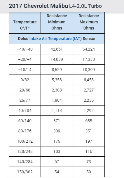

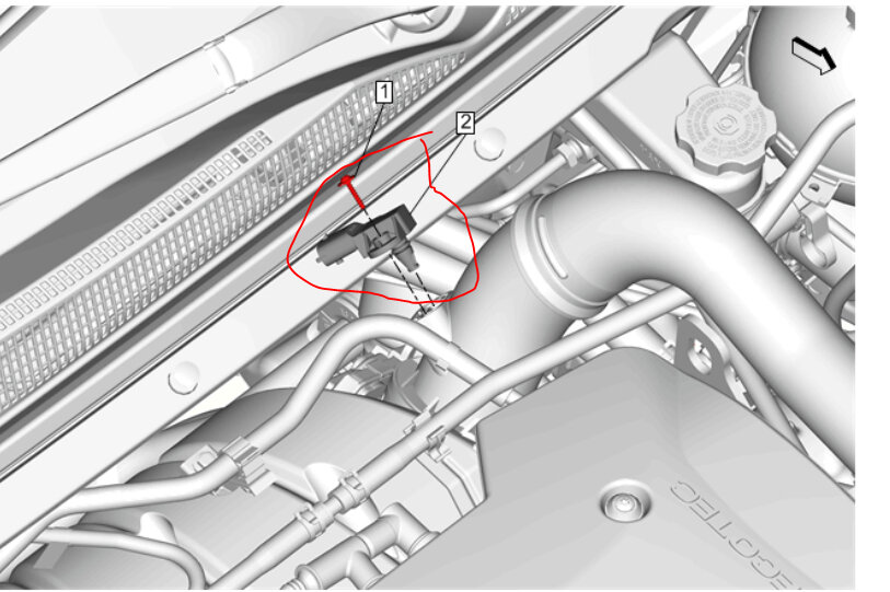

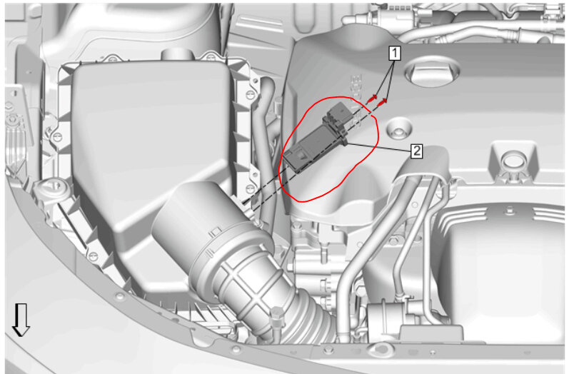

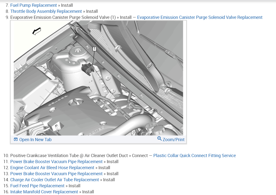

The Diagnostic Trouble Code (DTC) P00AC the Mass Airflow Sensor (MAF) or the Intake Air Temperature Sensor (IAT).
Test the IAT sensor's resistance using a multimeter at different temperatures to ensure it is within the specified range. See pic 1 below for the manufacturer's specifications.
Also, inspect the IAT to see if there is any dirt, air leaks, or wiring issues. See pic 2 for the location. Do the same with the MAF. See pic 3
On some of these vehicles, the IAT is integral with the MAF, so if the IAT isn't located where it shows, pic 3 shows both.
Keep in mind, an air leak can cause this as well, so you may want to check for air leaks between the air filter box and the throttle body.
Let me know what you find.

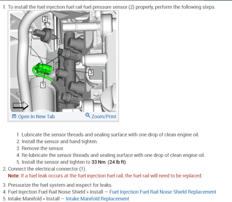

My Malibu first of all started out displaying “ reduced engine power “ it would drive fine until I would get on the gas pedal a little hard, I was going through my fuses under the hood and noticed a burnt wire smell but couldn’t find the source when I tried starting the car it would just turn over so I tried again and suddenly did nothing at all, I did find that the burnt wire smell was coming from the ecm so I had it replaced and programmed by a GM dealership after I took it back home it ran fine but then it started rumbling and about to stall, I shut it off but now it won’t start again just turns over, I scanned it and came up 3 codes the first two I replaced with GM certified parts which was the camshaft and crankshaft position sensors the 3rd code was P00CA which is the Fuel pressure regulator High control circuit High voltage, my question is do I need to replace the fuel pump or is there something else I should check into first besides checking the wiring?
Friday, August 18th, 2023 AT 11:27 AM (Merged)
KEN L
  • MASTER CERTIFIED MECHANIC
  • 55,512 POSTS

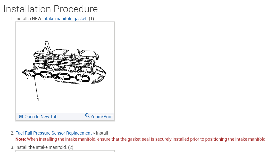

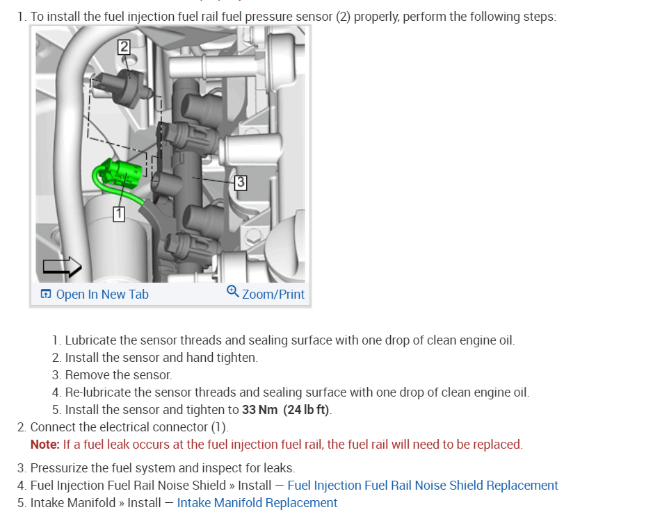

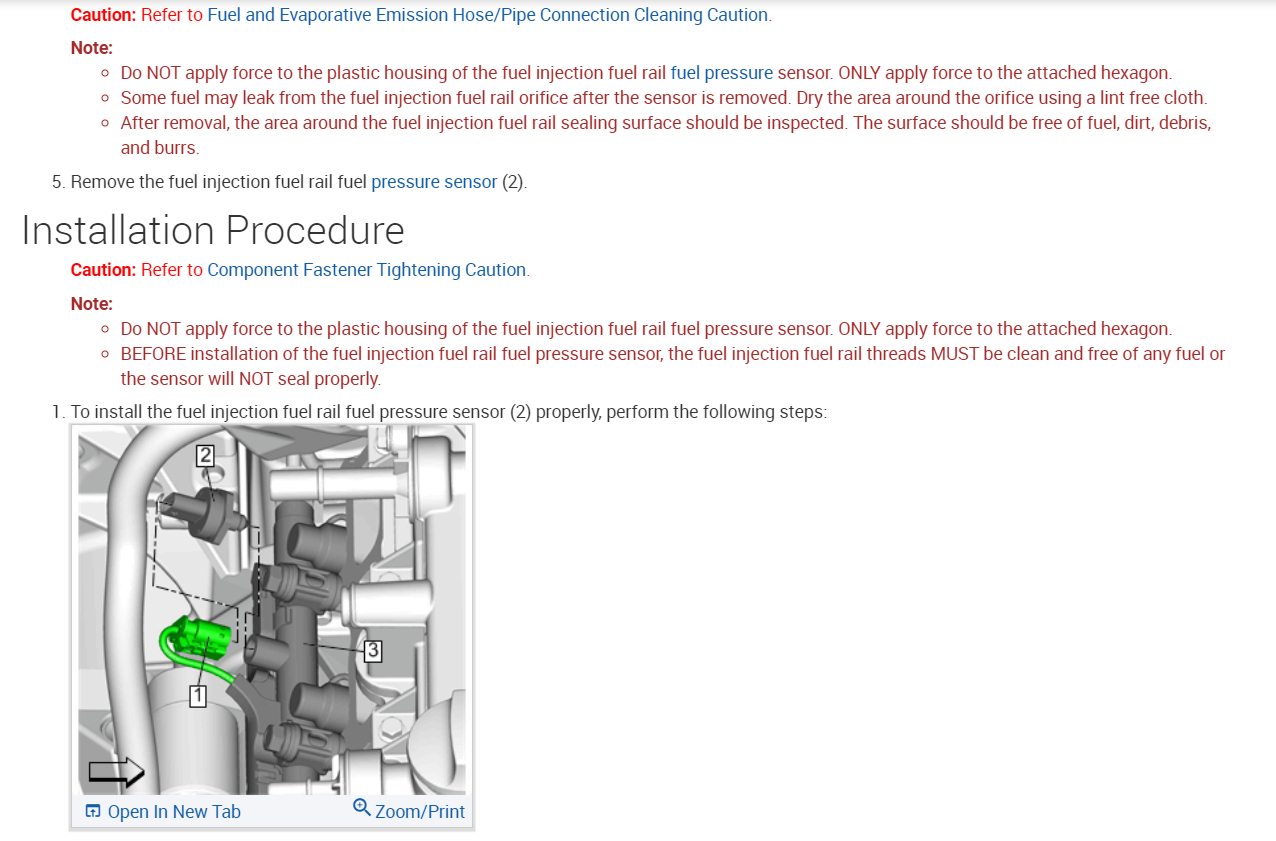

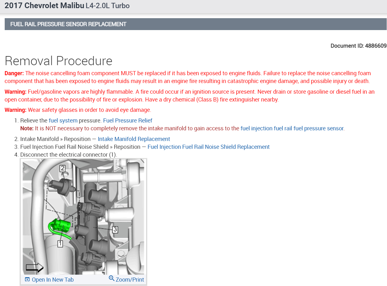

The diagnostic trouble code (DTC) "P00CA" in a 2017 Chevrolet Malibu refers to a potential issue with the "Fuel Rail Pressure Sensor Circuit Range/Performance." Here is the location of the sensor so you can change it out. Check out the images (below). Please let us know if you need anything else to get the problem fixed.
Friday, August 18th, 2023 AT 11:30 AM

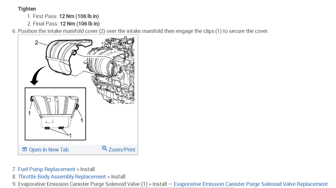

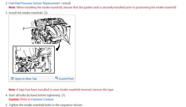

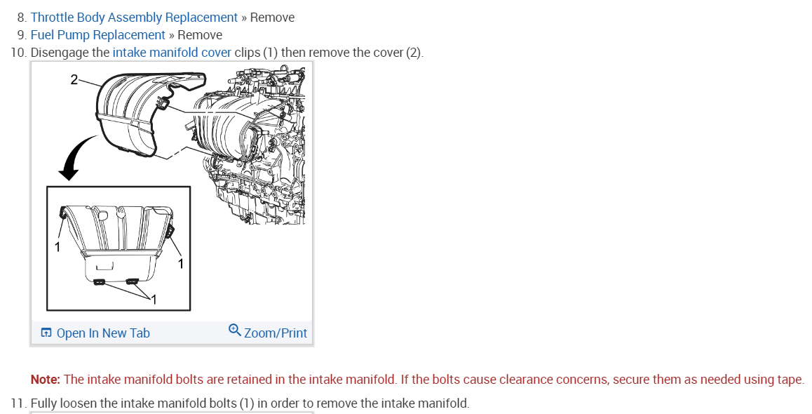

K THOMAS
  • 17 POSTS

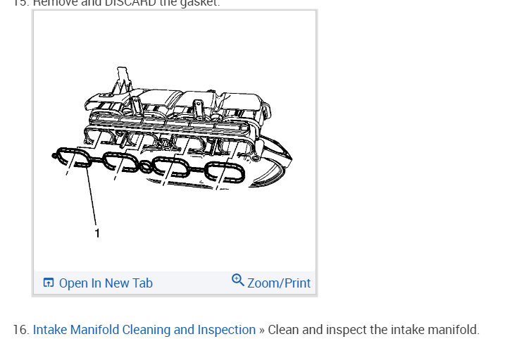

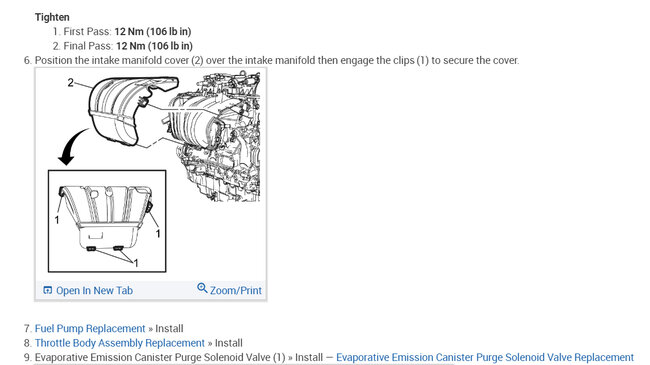

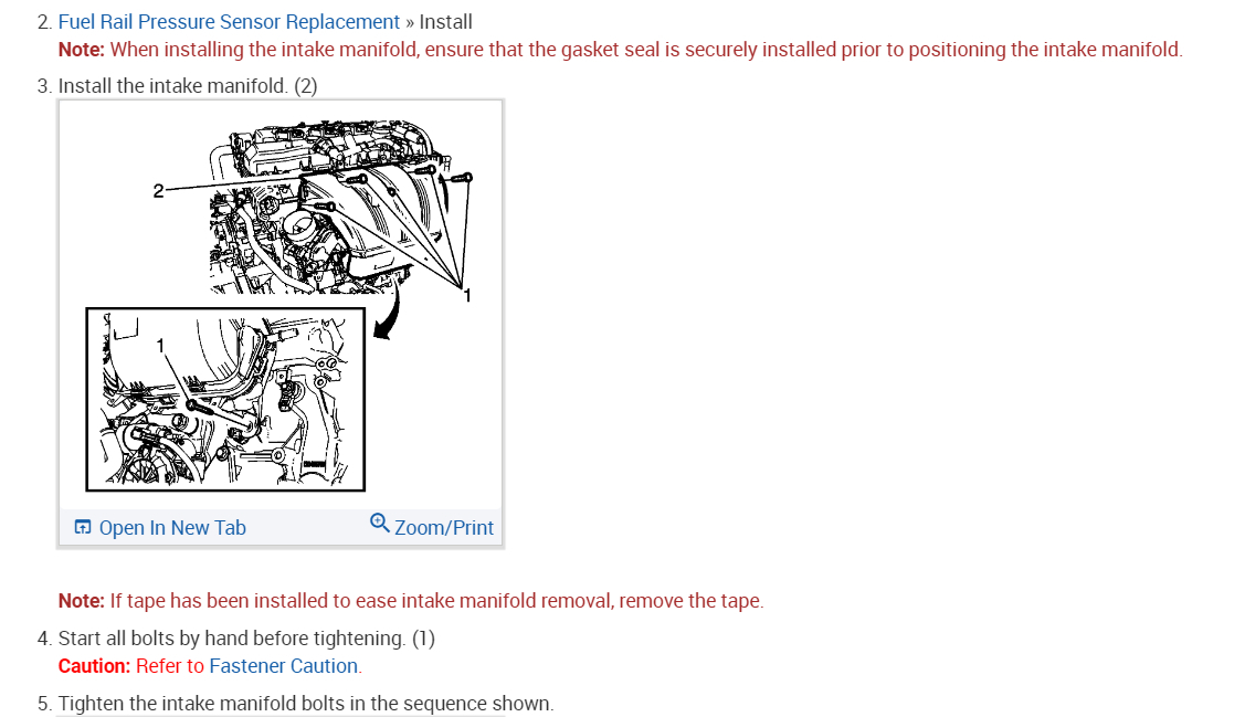

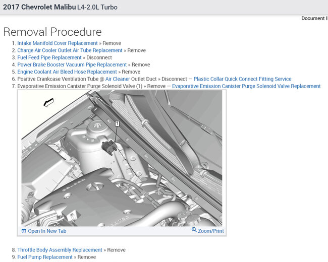

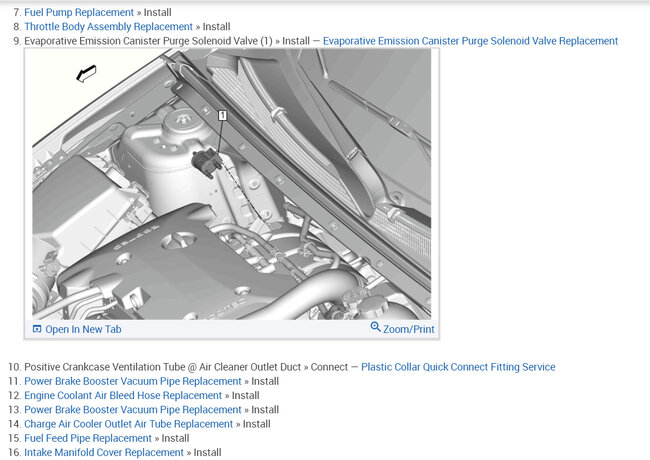

Could you send more pics of how to get to the sensor like how to remove certain parts?
Friday, August 18th, 2023 AT 6:57 PM
K THOMAS
  • 17 POSTS
Like the intake manifold.
Friday, August 18th, 2023 AT 7:00 PM
KEN L
  • 55,512 POSTS

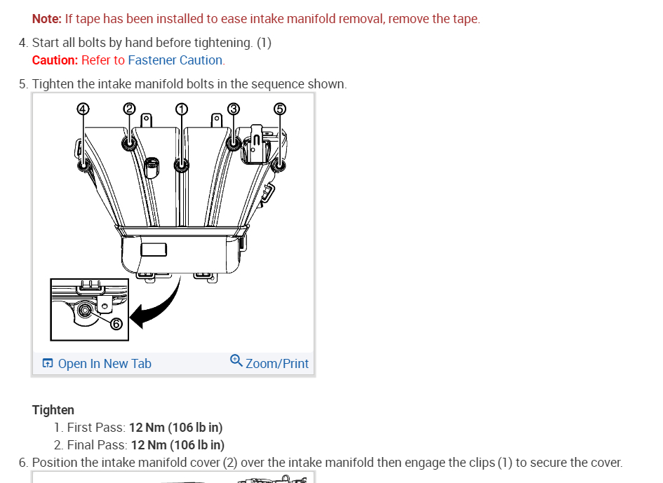

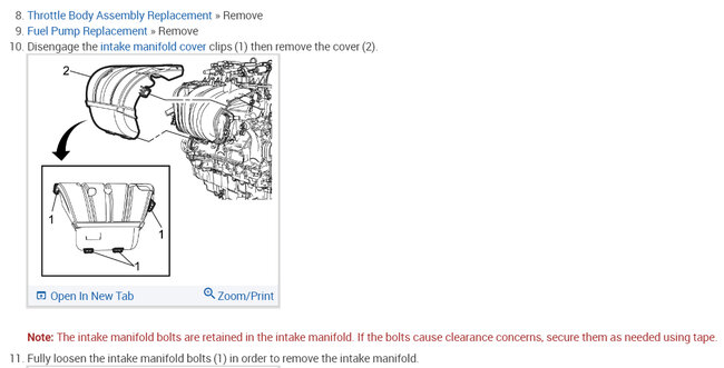

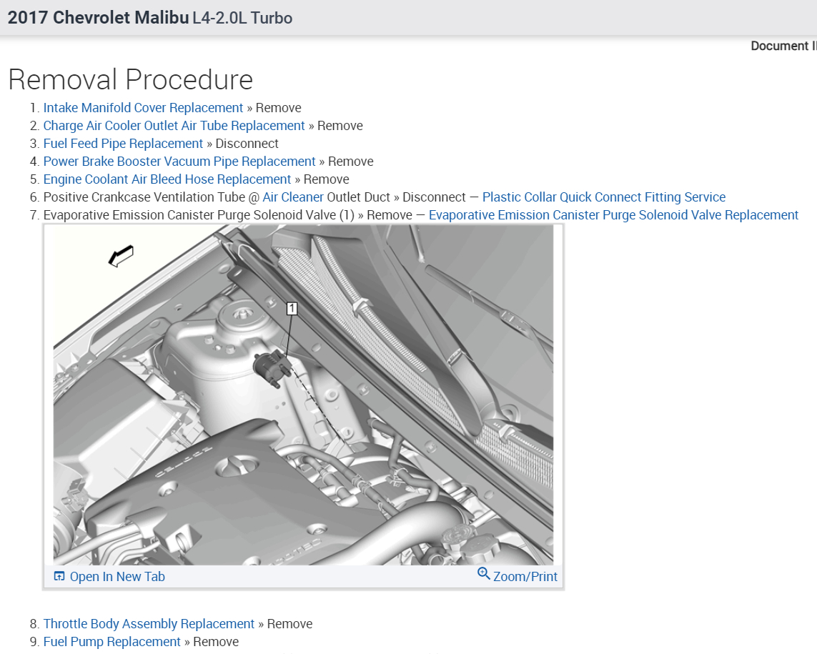

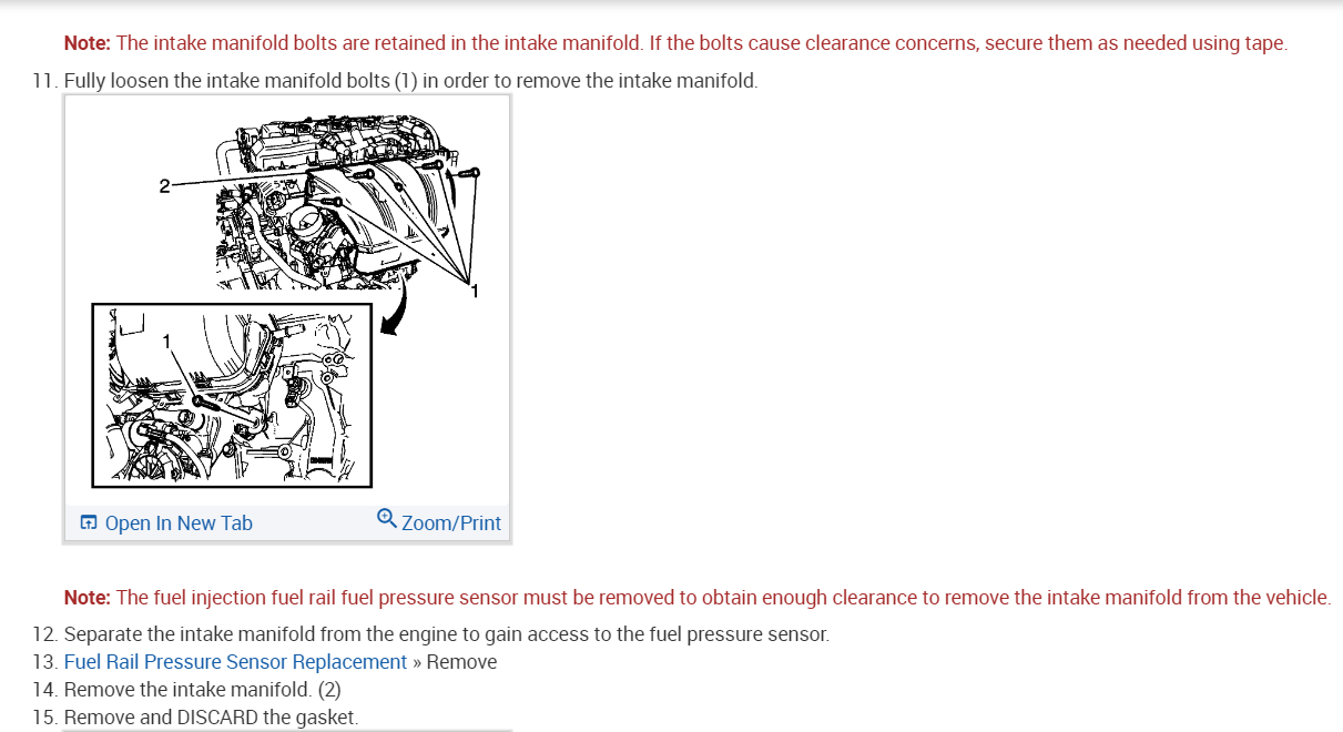

Here is the location of the sensor so you can change it out and how to remove the intake manifold to get to the sensor. Check out the images (below). Please let us know if you need anything else to get the problem fixed.
Saturday, August 19th, 2023 AT 11:08 AM
K THOMAS
  • 17 POSTS
I figured it out but after I got everything put back together and even put in a new battery, I tried starting the car and all it did was just turn over, I waited a few minutes and tried it again and now it doesn’t even turn over, the battery is completely charged, I’m at a loss here and about ready to roll the thing off a cliff, any suggestions? Also is there a fuel pressure regulator or is that the same as the sensor?
Saturday, August 19th, 2023 AT 11:16 AM
KEN L
  • 55,512 POSTS
Yes, the sensor helps vary the voltage to the pump. So, is it not cranking anymore? Is the security light flashing?
