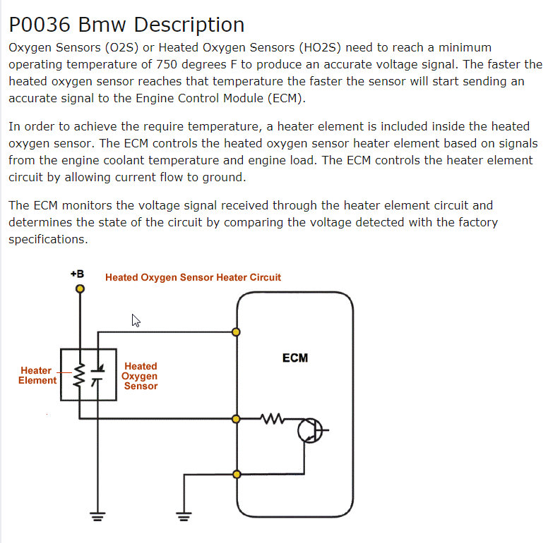

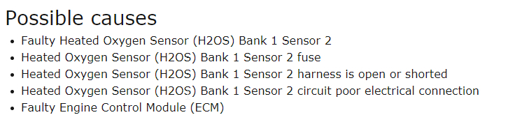

This code says it is bank 1 sensor 2, which means the downstream sensor. I would start with checking the heated o2 sensor fuse and connector at the sensor. If these are ok and do not have water in them or the fuse is blown then I would just replace sensor 2 as that is normally the issue.
However, this code is saying that the sensor is taking too long to warm up. The ECM monitors how long it takes to warm up and when it takes too long it sets the code.
Also attached are the possible causes. Unfortunately, BMW does not provide a specific test for this code because usually it is accompanied by others and those would take precedence.

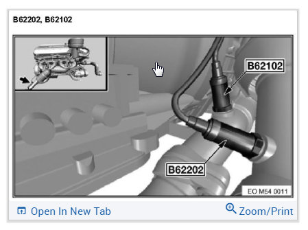

I included the location on the o2 sensor. They are pretty easy if you can see them. Looks like they are in the open so just unplug them and unscrew them. They may be hard to get out because they get rusted and seized. So when reinstalling them use some anti seize on the threads just to try and prevent any issue in the future.

Hi Kenny, thanks for the feedback, that's great, just to double check I am replacing bank 1 sensor downstream being it after the catalytic converter?
Tuesday, July 9th, 2019 AT 6:56 PM
Yes. That is the one the code appears to call out specifically.
