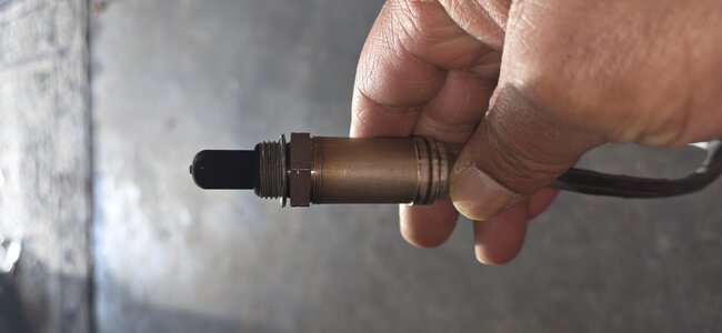

Need help. What else is causing this code? I changed my sensors again this time with ntk top and bottom. My wires are not damaged on both sensors they look good, and my car drive good. What else can I change to fix before emission?

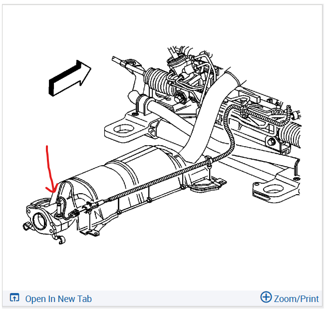

We need to make sure you are changing the correct oxygen sensor. Also, you need to check the EMISSONS 1 fuse - 15 AMP in the fuse panel under the hood. Also, make sure to clear the codes once the repairs have been made.
P0036 - HO2S Heater Control Circuit (Bank 1 Sensor 2)
Here is the location of the sensor to be changed out. Check out the images (below). Please let us know what happens.

These are the sensors I have now brand new and yes, I changed all the fuses somewhere old but that department good, but this code still remains. Drove home just now from work it came back on p0036 nothing else and my car still perform as usual no major problems but I'm getting loss now maybe a wire I just don't know where to start checking.

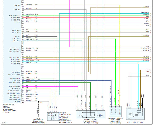

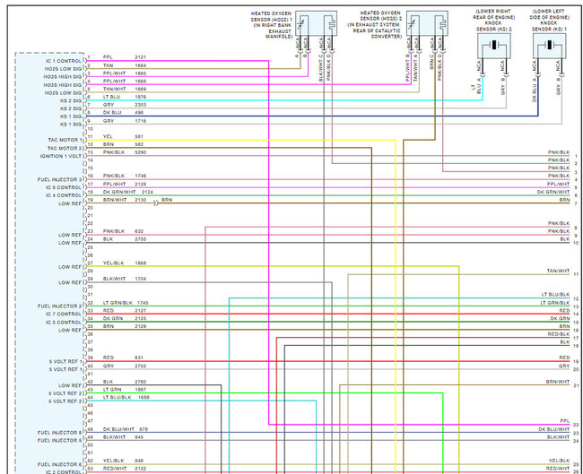

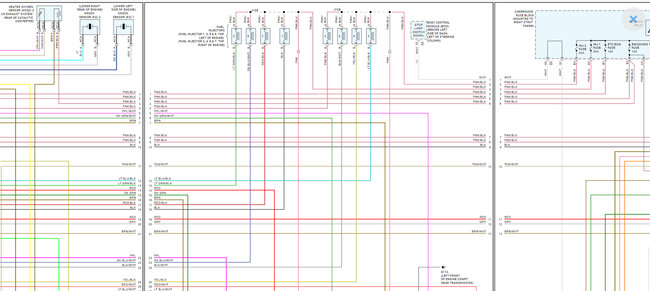

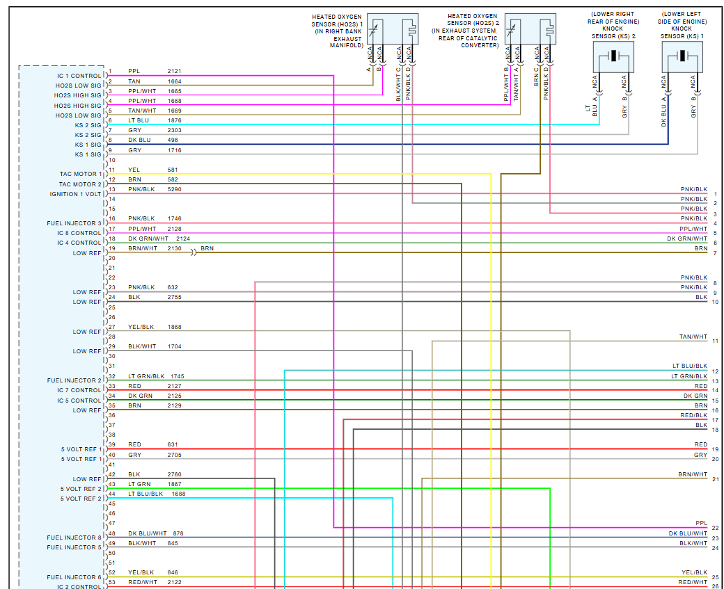

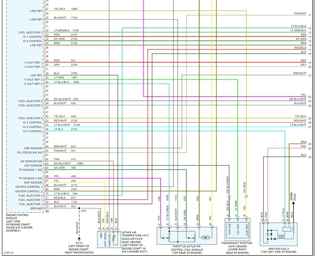

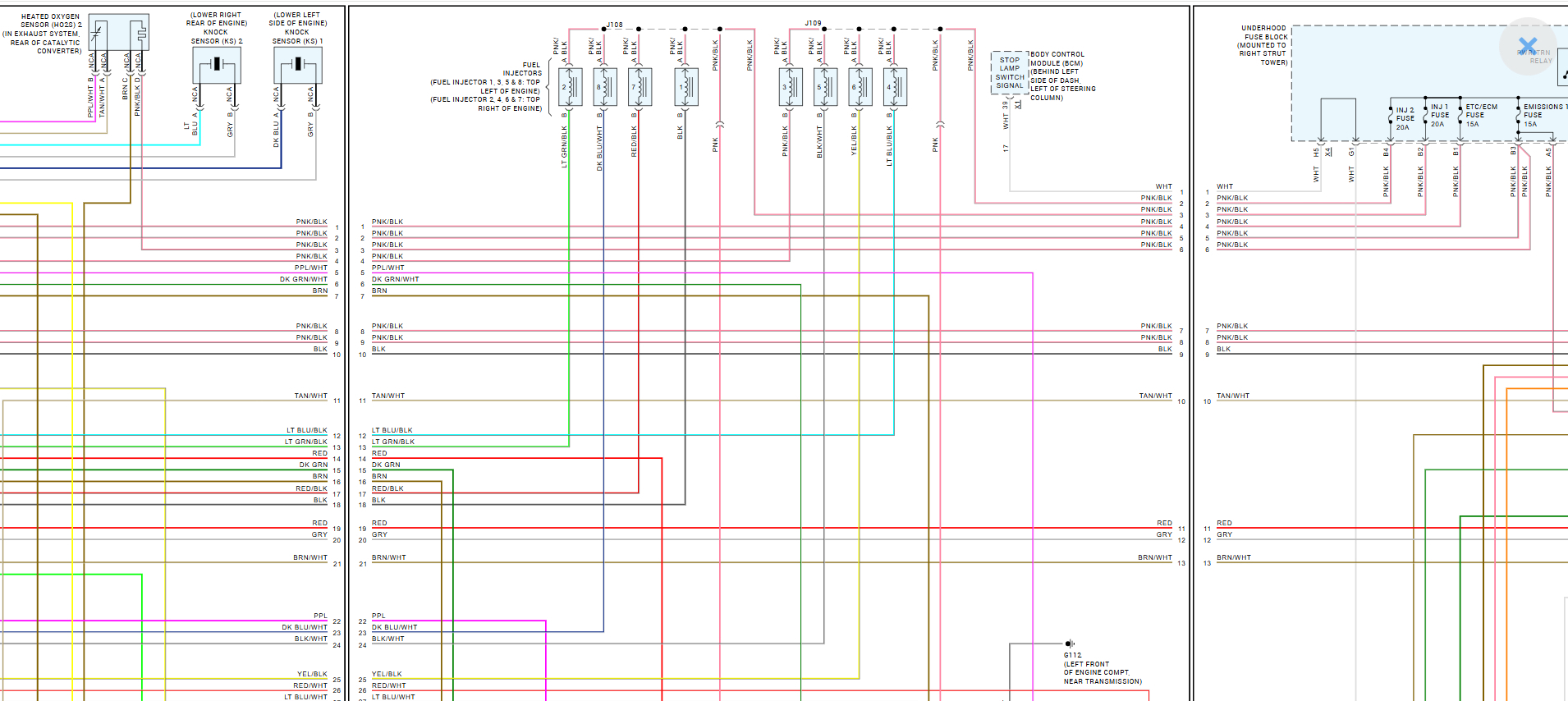

Okay, then this will be a wiring issue or the PCM is bad. Here is a guide to help you check the wiring with the wiring diagrams in the images below.
Check out the images (below). Let us know what you find.

Sorry for late hit back but found out it was burned out wiring touching down there around oil pan. It's good now.
Sunday, June 22nd, 2025 AT 7:51 PM
KEN L
  • MASTER CERTIFIED MECHANIC
  • 55,281 POSTS
Yep, that will do it, a wiring issue or the PCM is bad were the only choices. Glad you got it fixed, thanks for letting us know and visit back anytime.
