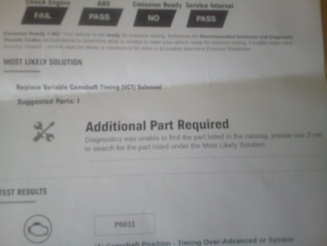

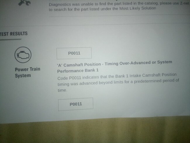

I had AutoZone do a ODBII scan and it threw 2 P0011 codes for the intake camshaft position system performance. Their system recommended replacing the engine variable timing solenoid all 4 of them.
I went on Amazon and saw them made or different materials. Which would be recommended?

Here is a pic of the read out in case I'm miss interpreting it. Thanks

I don't see the image; can you try reloading it? Most of the time the problem will be the oil control valve stuck open, or the camshaft actuators is stuck in the advanced position.
P0011 - "Intake Camshaft Position Timing - Over-Advanced (Bank 1)"
Also, make sure the engine oil is clean and full. The camshaft depends on oil pressure to work correctly.

Here's pics I hope it says they are loaded. IMG_20250328_131935_009. Jpg
IMG_20250328_132004_769. Jpg

Yep, over advanced, I would get all four oil control valves and install them. Clear the codes and let's hope it is not the actuators themselves. Please let me know how it goes.

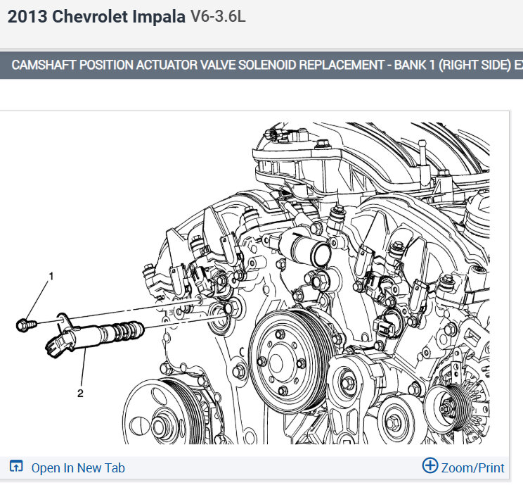

I am not sure what they are showing in the video. It does not look like the same car, here is what it looks like. Check out the images (below).
Friday, April 4th, 2025 AT 10:13 AM
DAVENOOB
  • 312 POSTS
Yep that's what I thought as well. Okay, I will update later today when done.

Where's the location of the the other 3 vvt?
Friday, April 4th, 2025 AT 1:18 PM
DAVENOOB
  • 312 POSTS
Nevermind I found them. Replaced the 2 that go to the 1 bank and car idles properly. Check engine light still on how do I clear it?
