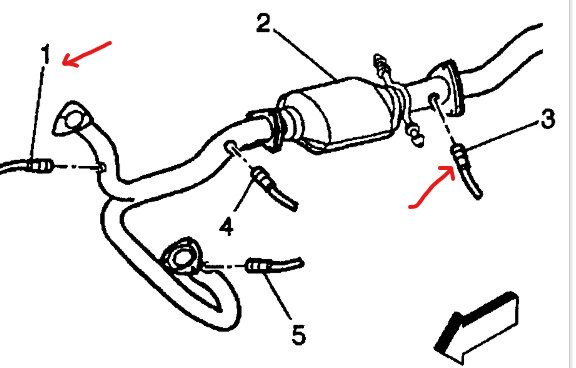

My o2 sensors one upstream one downstream both have 13.3 to 13.6 volts on the sensor side of the plug with the car running. Both sensors have heater resistance of 3.5 to 4.5 ohms. measured with the plug disconnected. My Chilton manual says 3.5 to 14 ohms is the acceptable range.
Please respond and I will to make sure the computer is working o.k. google chrome is the only browser that works on a lot of websites I use. When you respond I will give you the trouble codes.

Hello Bruce, Can you please give us the codes numbers, this will help to make sure we are fixing the correct problem. Here is the location of the bank 1 sensor 1 location and sensor 3. Check out the images (below). Please let us know what happens.

Ken your recent link in my e-mail worked thanks. The above diagram doesn't apply to my truck. Sensor 3 is right sensor 1 is wrong. Bank 1 sensor 1 is on the driver side head pipe. Is there a way to clean the o2 sensor? Mass airflow cleaner? propane torch? There is 4 sensors on my exhaust. I am going to swap sensors from one location to another and see if the codes follow the sensor. I am looking at code: PO 133, PO143, PO 147. Bank 1 sensor 3 stayed at 24mv for about 7 seconds and then 7mv for 7 seconds. The hotter my truck gets the leaner sensor 3 gets.

Yep I see that now on the image, #2 is the sensor the number 1 sensor bank 1, sorry about that. I would not try to clean the sensor I would replace it, does the truck have an exhaust leak? If so it will cause problems for the sensor.
P0133 — Bank 1 Sensor 1 O2 Sensor Slow Response
P0143 — Bank 1 Sensor 3 O2 Sensor Circuit Low Voltage
P0147 — Bank 1 Sensor 3 O2 Sensor Heater Circuit Malfunction
Sensor 3 is a heater circuit problem so cleaning it will not help, the other codes are response problems so the sensor may not be the problem at all if the tuck has an exhaust or vacuum leak. But I would check the wiring as well which can cause these codes. Here is a video so you can check for the vacuum leaks.
