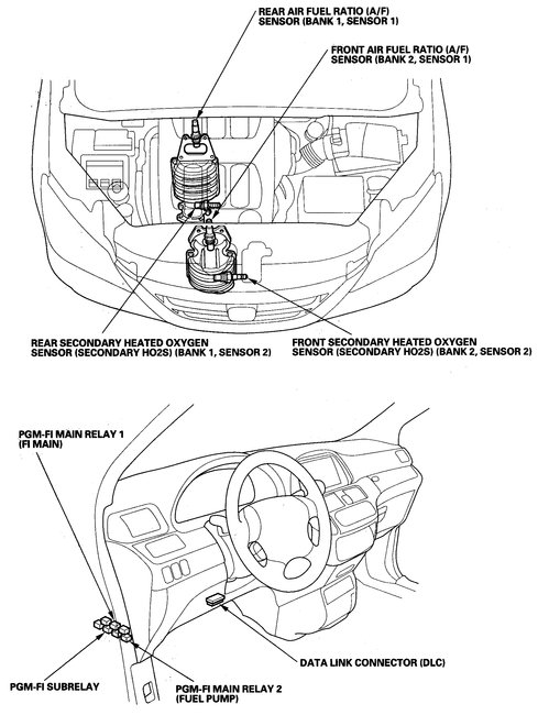

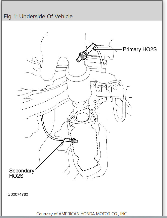

How many sensors does my van EXL model 3.5 liter have?
Some say two downstream front and rear, and two upstream front and rear, (front and rear are the same up and downstream) that’s true?
Saturday, May 4th, 2019 AT 2:41 PM
18 Replies
  • 110,192 POSTS
Welcome to 2CarPros.
That is correct. There are a total of four. You have two upstream and two down stream. Each bank of the engine (there are two banks) has two sensors. I attached a picture showing locations.

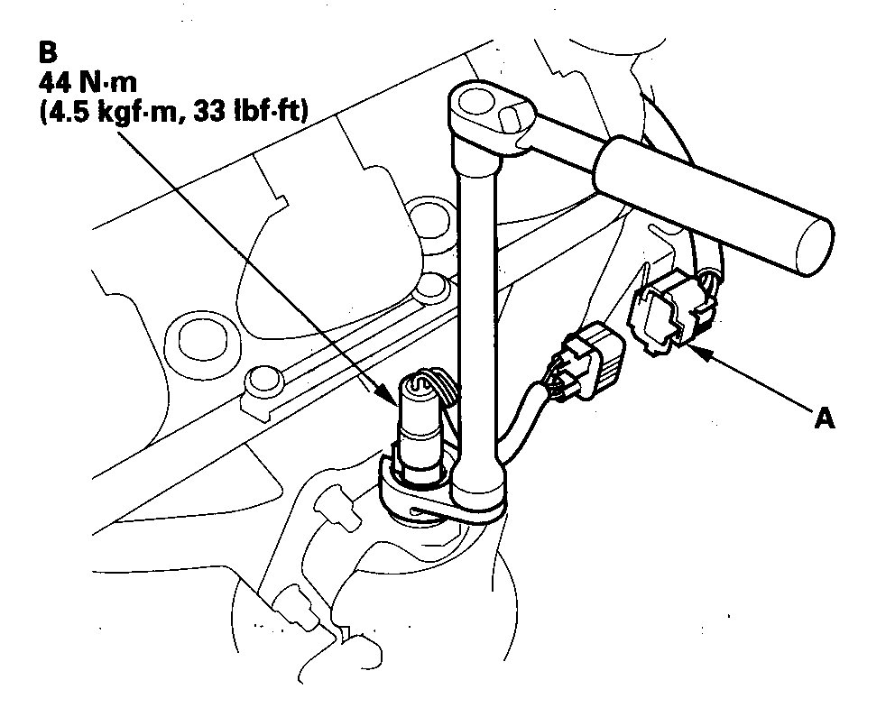

Here are the directions specific to your vehicle. The first set of directions and pictures 2 and 3 show how to replace sensor 1 for both the front and rear banks.
__________________________________
Special Tools Required
O2 sensor socket wrench, Snap-on YA8875 or SWR2, or equivalent, commercially available
Front Bank (Bank 2)
1. Disconnect the front A/F sensor 6P connector (A), then remove the A/F sensor (B).
pic 2
2. Install the parts in the reverse order of removal.

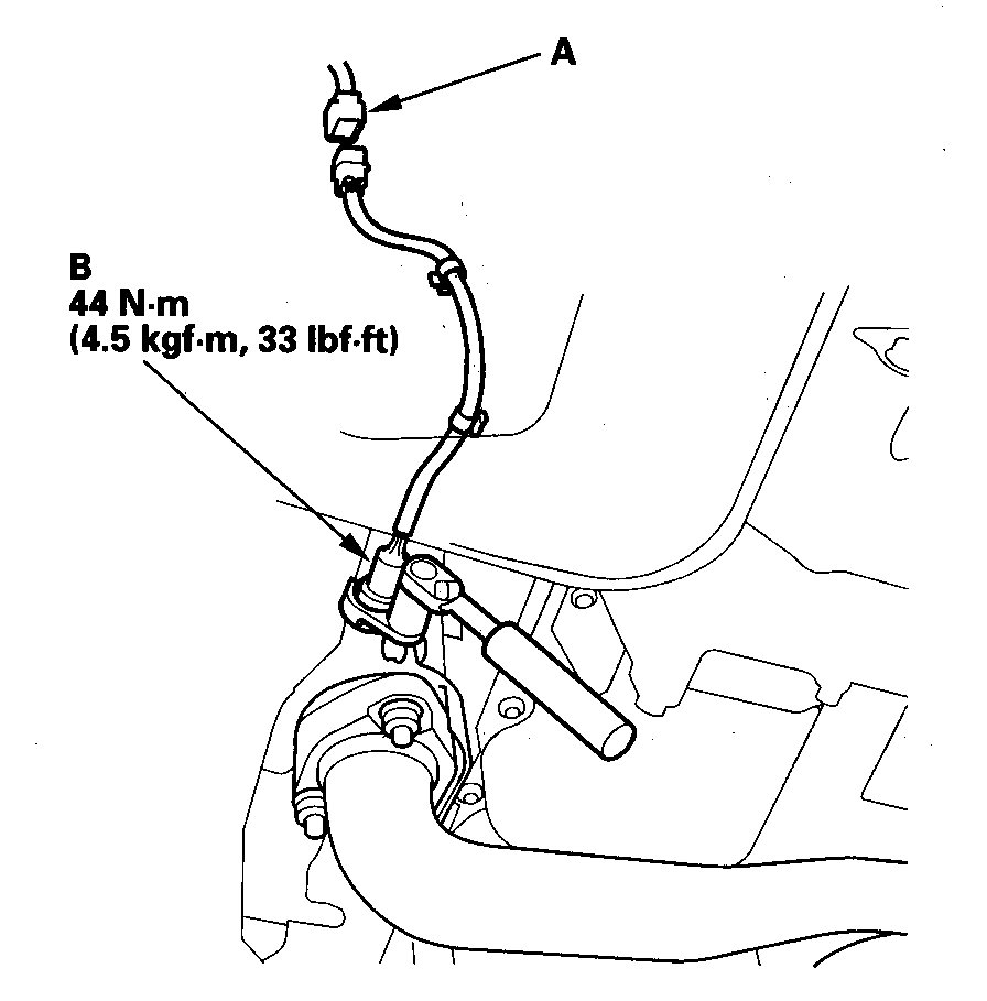

Rear Bank (Bank 1)
1. Disconnect the rear A/F sensor 6P connector (A), then remove the rear A/F sensor (B).
pic 3

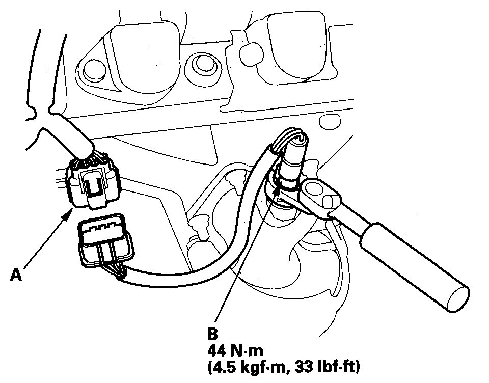

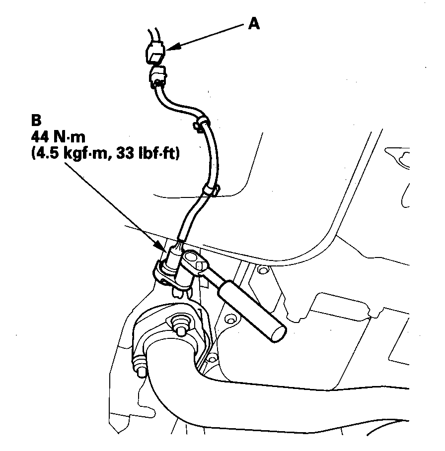

Here are the directions for sensor 2. Each bank has one. These are the heated sensors. Pics 4 and 5 correlate with these directions.
__________________________________________
Secondary HO2S Replacement
Front Bank (Bank 2)
1. Disconnect the front secondary H02S 4P connector (A), then remove the front secondary HO2S (B).
pic 4

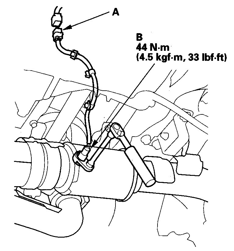

Rear Bank (Bank 1)
1. Disconnect the rear secondary HO2S4P connector (A), then remove the rear secondary HO2S (B).
pic 5

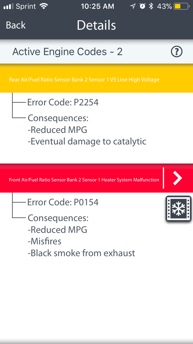

KEVIN MILES2
Hi Steve.
Thanks for responding to my posting.
Here are the exact wording of the codes:
Rear Air/Fuel Ratio Sensor Bank 2 Sensor 1 VS Line High Voltage
Error Code: P2254.
Front Air/Fuel Ratio Sensor Bank 2 Sensor 1 Heater System Malfunction
Error Code: P0154.
Consequences: Black smoke from exhaust.
I have also included a screenshot of the code reading.
+2
Wednesday, December 30th, 2020 AT 12:22 PM (Merged)
STEVE W.
  • 15,671 POSTS
If those are the correct codes the description for both are wrong.
P2254: Front A/F Sensor VS Circuit High Voltage B2S1.
P0154: 02 Sensor No Activity Circuit B2S1.
What it means is that the sensor is shorted to supply or bias voltage and is staying there.
I would check the wiring for the sensor and be sure it is not damaged or chewed on. If the wiring looks okay then the easiest test would be to replace that sensor.
The sensor in question will be the first one at the top of the exhaust manifold closest to the radiator when you open the hood.

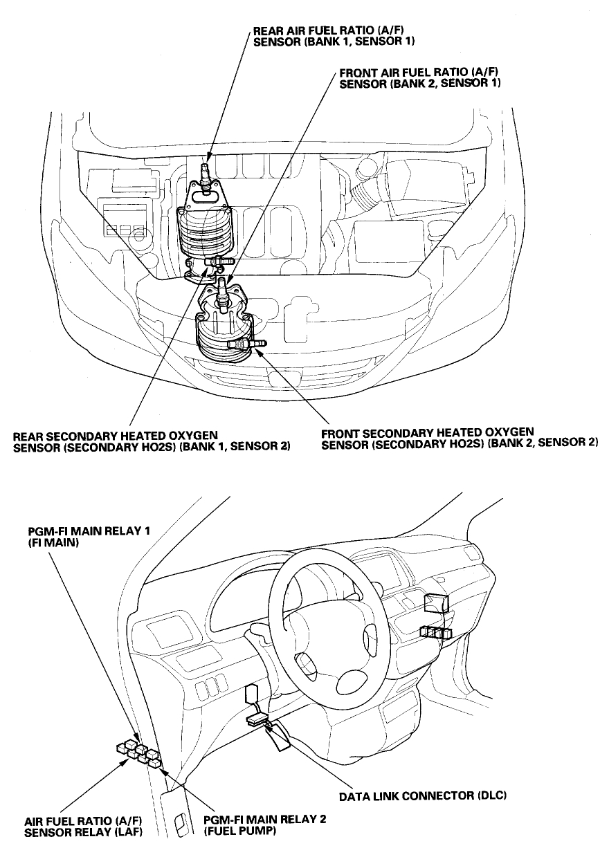

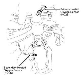

I replaced the Bank 1 Sensor on the vehicle, but I cannot locate the Bank 2 location to replace it. I still got the code to replace the Bank 2 sensor. I need help. Thank you.
+1
SCGRANTURISMO
  • 4,897 POSTS
The upstream O2 sensors for both bank 1 and bank 2 are going to be located in the exhaust manifold before the catalytic converter. Both downstream O2 sensors for bank1 and bank 2 are going to be in the exhaust pipe after the catalytic converter. I have included a diagram for you in the diagrams down below.

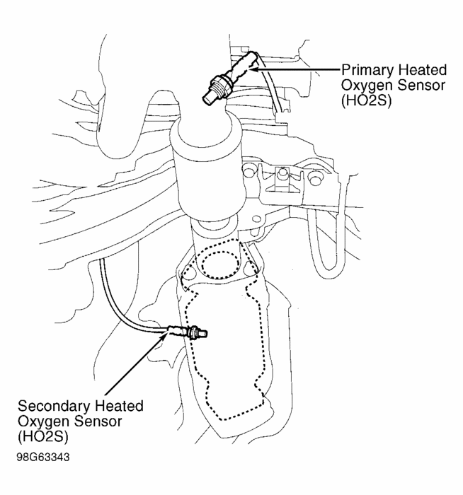

Location of the oxygen sensor on a 2001 honda odyssey van
+2
Wednesday, December 30th, 2020 AT 12:23 PM (Merged)
  • 75,992 POSTS
Primary Heated Oxygen Sensor (HO2S)In exhaust pipe, forward of catalytic converter.
Secondary Heated Oxygen Sensor (HO2S)On catalytic converter. Check out the diagrams (Below). Please let us know if you need anything else to get the problem fixed.

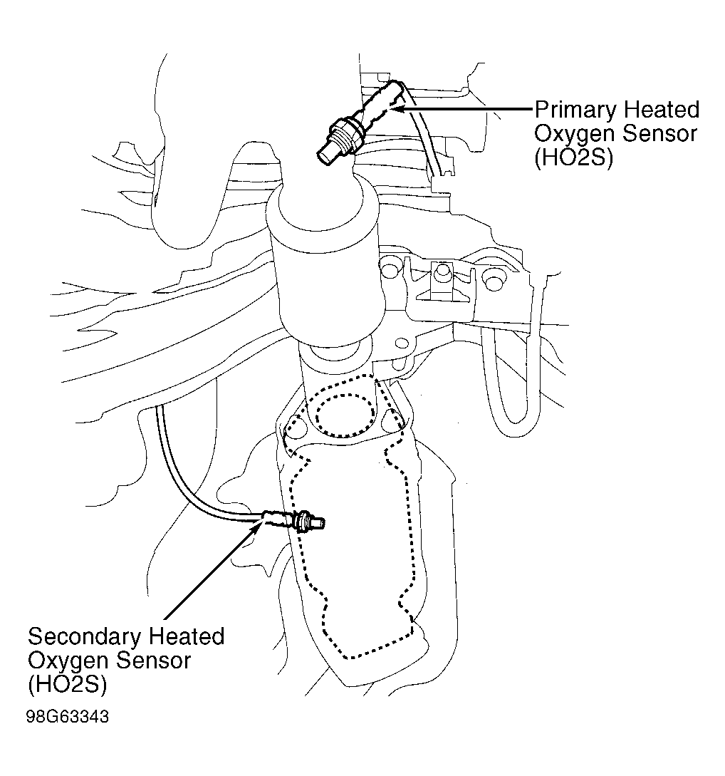

GUARDIAN1225
  • 2001 HONDA ODYSSEY
How to replace the oxygen sensor?
+1
  • 75,992 POSTS
https://www.2carpros.com/forum/automotive_pictures/12900_ox_3.jpg
https://www.2carpros.com/articles/how-to-replace-an-oxygen-sensor
