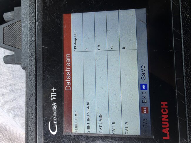

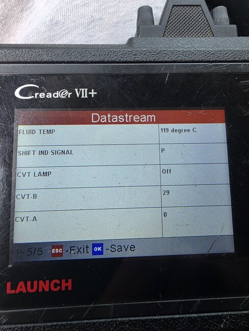

The other day my CVT overheated while driving on the freeway and went into safety/limp mode, I checked the temperature for the ATF and it showed (-113C°) I added a auxiliary transmission cooler and it climbed to (123C°) during normal street driving it hasn't gone into fail safe mode yet but i want to troubleshoot it before I deem the transmission trash and replace it .
I've added some stats for reference
I read that the cvt-b count is how many times it has overheated, but I've only recently acquired this car and have encounter the safety mode once .

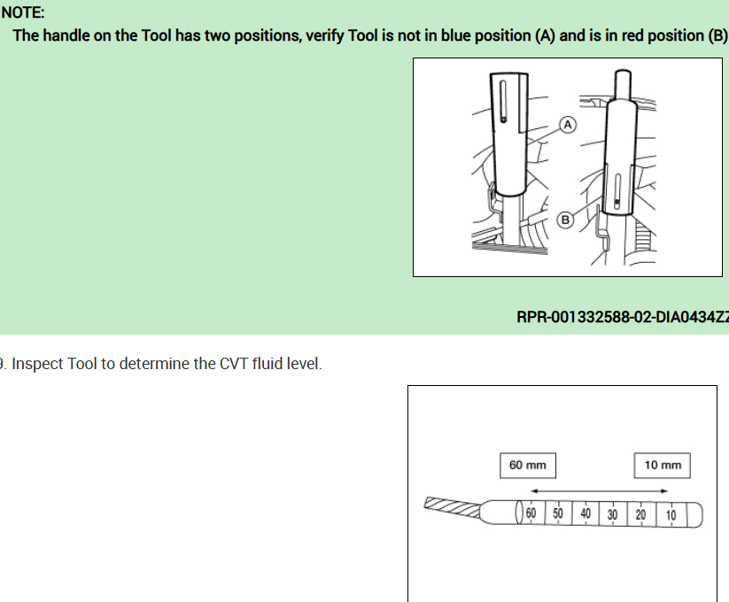

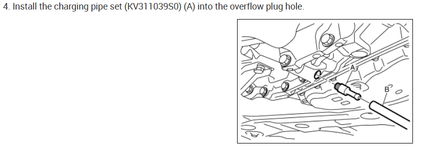

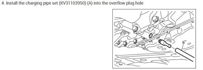

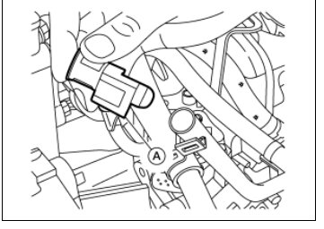

Yep, this happens when the belt inside the transmission start slipping, I would try changing the transmission fluid, here is a guide to help with instruction in the images below for your car.
https://www.2carpros.com/articles/how-to-service-an-automatic-transmission/
Make sure the fluid is the correct Nissan-spec CVT fluid. For this vehicle, it typically requires Nissan NS-3 CVT fluid or equivalent that specifically states NS-3 compatibility. Do not use regular automatic transmission fluid. Check out the images (below). Please let us know what happens.
