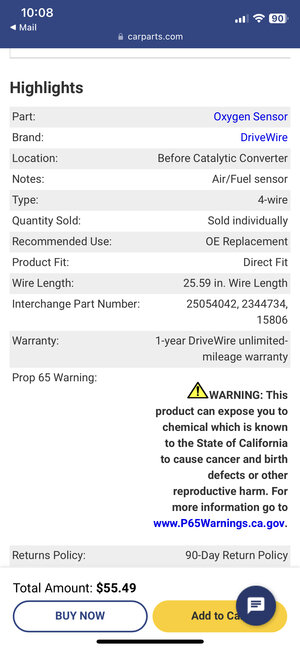

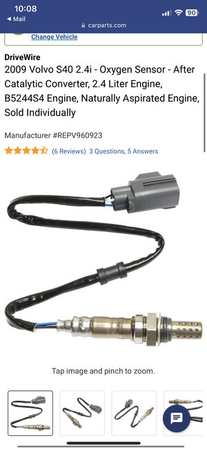

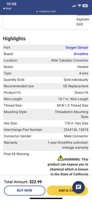

Got the car with some codes, mass flow air sensor and 02 sensor bank 1.
Purchased parts had them installed, the 02 sensor was the wrong one and would reach the connector, so awaiting the new part. As soon as I start the car it immediately goes into the red zone and gives me the warning that says the engine temperature is too hot and to turn it off immediately. Wasn't having that issue prior to removing the 02 sensor. Now I know it’s not plugged in as it won’t reach, so when the new one is able to be connected with this issue go away? Oil was changed as well as all fluids. Prior to any of the parts arriving, I drove the car 2 hours consecutively without this issue or warning?

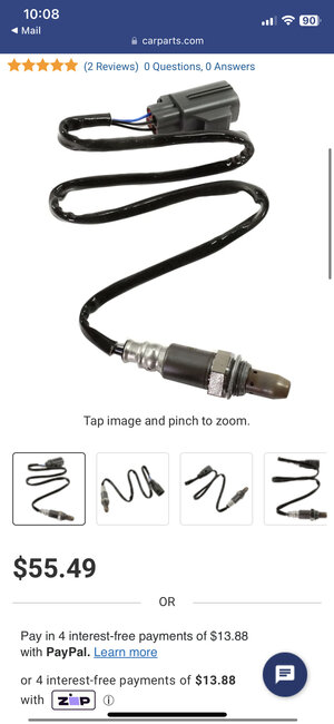

Okay so, I looked at the parts and the 02 (that was too short to reach) is the one that produces heat (after Catalytic converter 02 is what is says in the description and the note says “heat)
The one I actually needed was the “before catalytic converter 02”
Could that have been the issue?

Yes, there are two 02 sensors, usually one before the converter and one after. Did you get the O2 sensors yet? and have you put them on? After you do will probably have to rescan the car and reset the computer.
