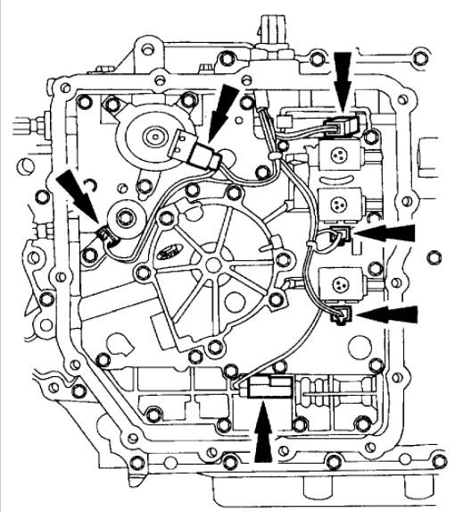

I was wrong bout the location of that solenoid here is what the data says.
Shift Solenoids (SSA, SSB, SSC)
Three on/off solenoids are used for electronic shift scheduling. The three solenoids are located in the main control valve body. The solenoids are two-way, normally open style. Shift solenoids SSA, SSB, and SSC provide selection of first through fourth gear by controlling the pressure of the three shift valves. It looks like they are changeable though the book calls for 2.5 hours to change them. It might be a good idea to do a transmission service changing the oil and filter. They sell a kit to do these services.

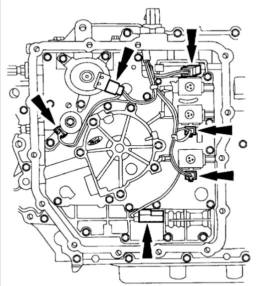

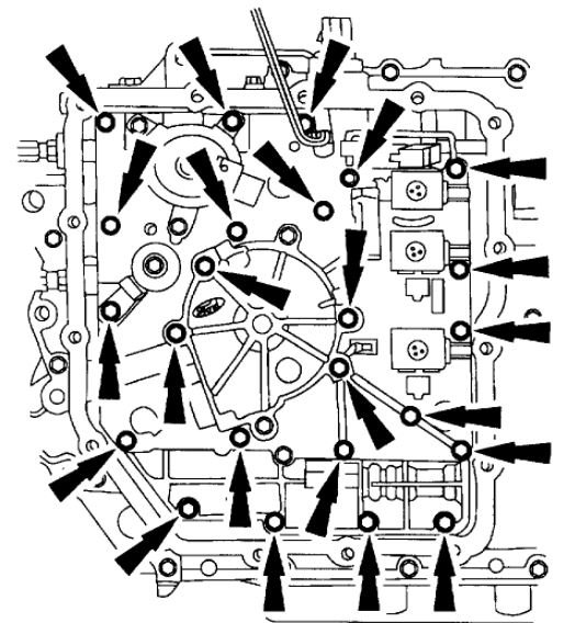

So you had the transmission pan off and you were able to get the internal filter out and changed. The unit that it is connected to is the valve body. It's pretty complicated in there and is probably something I would be able to teach over the computer and there is a whole series of specialty tools needed. I uploaded the diagram to show you what I am talking about. It's under the side cover that the filter was on. The first one is just the bolts that hold it on, the second one is the solenoids in question. With your filter change done what is the transmission doing exactly now how is it acting. Is the light still flashing but its driving okay?
