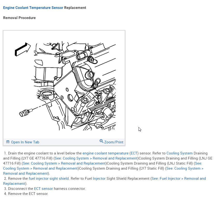

My vehicle's temperature gauge will be at normal temperature then after ten minutes of driving it falls to cold. then says the engine is overheating and it will slow down to 20 mph. is that the temperature control or the gauge cluster failure?
Jul 6, 2019 at 10:23 AM
  • CAR REPAIR CONTRIBUTOR
Hi JamesJones,
This sounds like a temp sensor issue. The cluster is just a display meaning it shows the temp that the PCM is telling it to. So either the PCM is sending erratic signals or more likely the temp gauge is failing and it is sending the bad signal to the PCM, then the PCM is reacting based on that info.

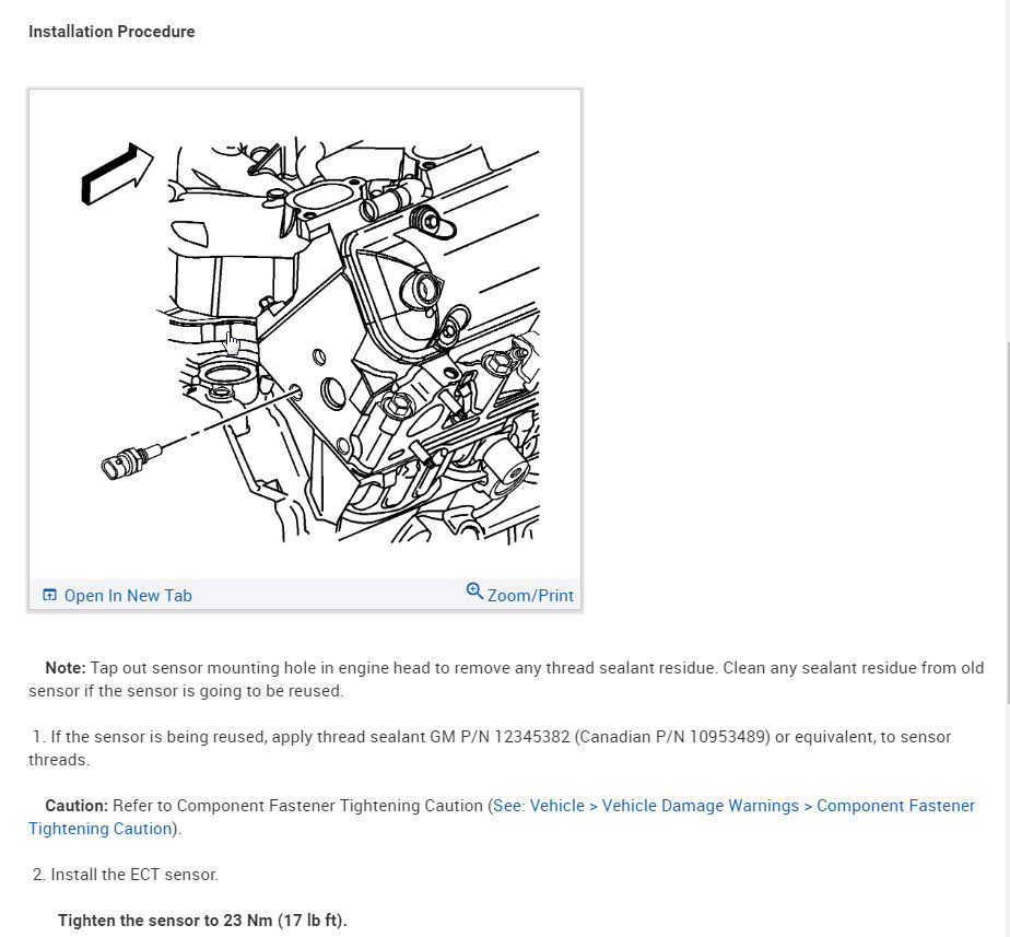

Here is the procedure on how to replace it. If you want to try and confirm this, we would need to check and see if there are codes. If so, they will point us toward the sensor or a different place. Another way is to hook up a meter to the sensor and monitor the voltage output. If it erratic like the gauge then you know the sensor is the issue.
Let me know what you find and we can go from there.

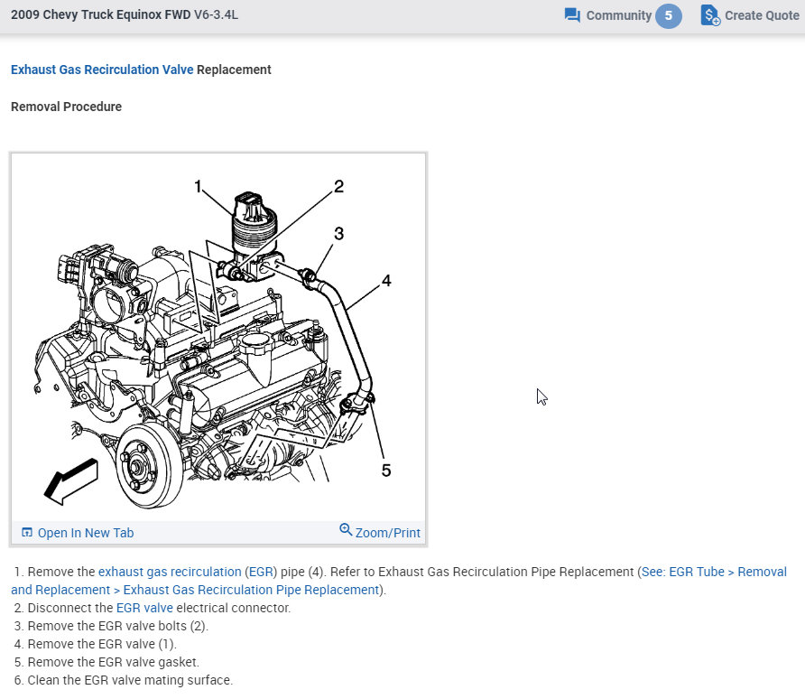

I hope buddy. now I have to change the EGR valve. lol
Jul 1, 2021 at 1:03 PM
Here is the procedure just in case. However, the hard part is past. The EGR is pretty easy especially compared to changing out that connector.

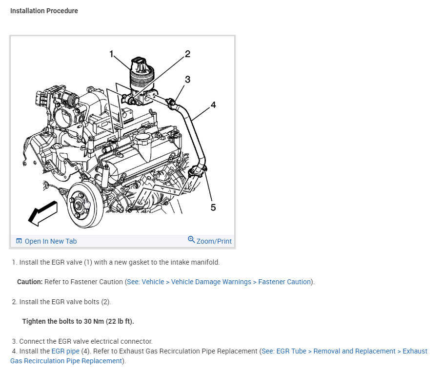

Well, I just decided to put a new EGR valve on so the stable track light went off and the equinox seems to be running really good now so I’m really glad that went smoothly and fixed it.
Jul 1, 2021 at 1:04 PM
Awesome. Good job James. Thanks for updating us. That will help others that have a similar issue. Thanks for using 2CarPros.
