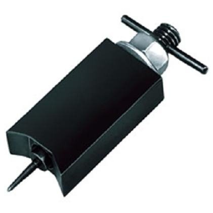

That special tool is shown in the first photo. The point is threaded into the center of the roll pin, then the silver nut is tightened to draw the pin out.

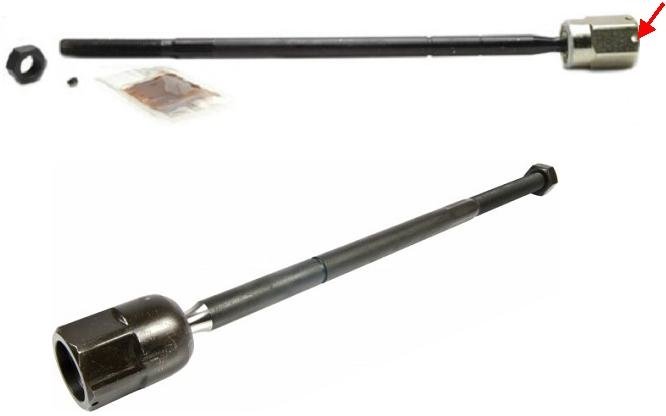

The second photo shows one style of replacement tie rod end at the top. The red arrow is pointing to where the roll pin would be. With this replacement, that hole is threaded, and a small Allen-head set screw is run in to stop the end from unscrewing if it comes loose. This design will have multiple threaded holes so you'll be sure to have access to one of them when the end is fully-tightened. When you have the roll pin design, if you want to pull that roll pin out, you have to unscrew the end a partial revolution until the pin is accessible. That will happen long before it gets close to the threads on the rack.

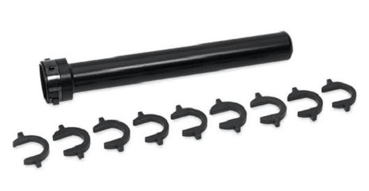

The third photo shows two sizes of special tie rod end sockets. One of these will slide over the hex part of the body, then you use a standard 1/2" ratchet to remove and install the tie rod end.
The bottom tie rod end in the second photo is for the same applications, but the design of the hex head is different. The socket can't slide over the body to reach the hex. For this design, the most common socket is shown in the fourth photo. You select the appropriate crow's foot wrench and slip that over the hex, then the socket slides over that and engages it so you can unscrew the end.
If your new tie rod end comes with the roll pin and you see it is going to be inaccessible once it is tightened fully, leave the end a partial revolution from fully-tight, tap the roll pin in, then finish tightening it. That roll pin is a long way from the threads on the rack assembly when the end is tight.
