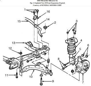

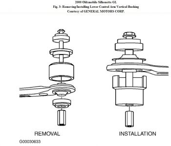

Clunking noise mostly when turning
Saturday, March 27th, 2010 AT 12:02 PM
MERLIN2021
MECHANIC
17,250 POSTS
Check the lower control arm bushings, they were a bad design, and I have seen many of them!
