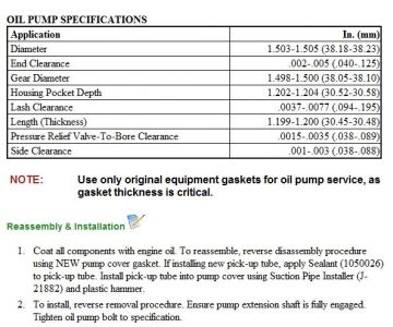

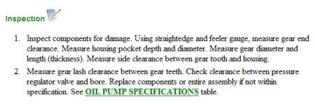

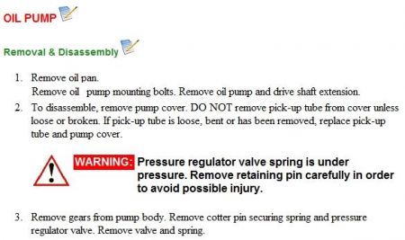

BLUELIGHTNIN6
MECHANIC
16,542 POSTS
Monday, May 24th, 2010 AT 3:48 PM
