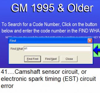

my serv eng soon light is flashing code 41 and i cant find the code translations for my car. can you help define the code and shoot me down a list of things to check? thank you

https://images.2carpros.com/forum/automotive_pictures/62217_Delta_1.jpg
Remove the ignition module and have the parts store test is, also check the wires in the distributor, they tend to get brittle with age.
