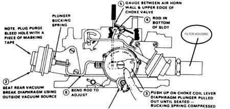

I think I got some bad gas and need to replace the fuel filter. Where is it located?

If this is a carbed engine, the fuel supply line to the carb screws into the fuel filter housing. The fuel filter housing screws into the carb.
