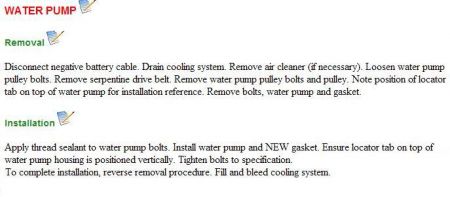

1999 Oldsmobile Cutlass 6 cyl Front Wheel Drive Automatic
is it hard to replace water pump myself on this car?
