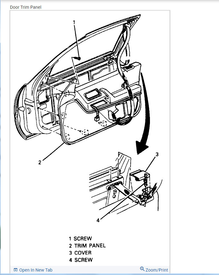

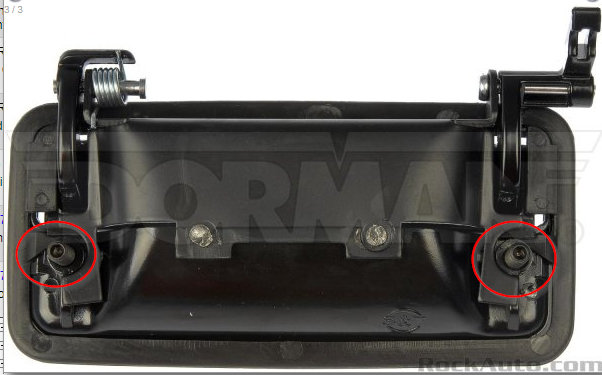

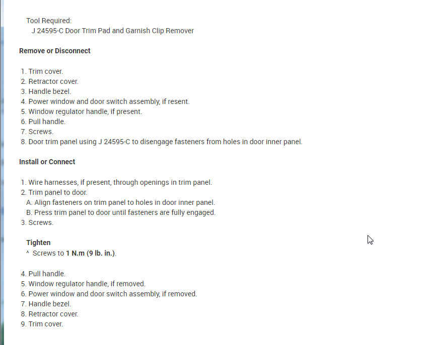

I need information on a 1993 Oldsmobile Cutlass Supreme S Coupe driver side handle removal and reinstallation.
Jan 7, 2021 at 4:18 PM (Merged)
  • CAR REPAIR CONTRIBUTOR
I am attaching the process for the door panel. Unfortunately the manual doesn't have a complete process for the handle. However, the picture attached of the inside of the handle shows where the two nuts are that need to be removed. All you have to do is remove the panel and then remove those two nuts from the inside of the door and the handle will come out from the outside of the vehicle. Then to replace it, just put the new one in place and connect the release rod then put the nuts back on.
Check the diagrams below. Let us know if you have other questions. Thanks
