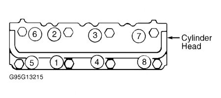

What are the torque settings for head bolts on a 1995 Olds Cutlass Supreme 3.1 Ltr?
Tuesday, October 27th, 2009 AT 10:02 PM
MECHANIC
110,192 POSTS
Start at 33 Ft. Lbs. and then another 90 ° turn. Here is the torque sequence:
