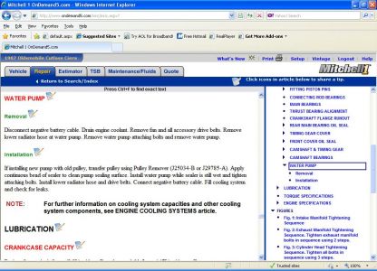

How do you take the pulley off the water pump
