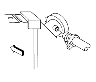

i need to change the radiator an I need instructions on how to do it please

Drain the coolant from the radiator. Refer to Draining and Filling Cooling System.
Disconnect the coolant recovery reservoir hose.
Remove the radiator hose clamps.
Disconnect the upper radiator hose from the radiator.
Remove the upper fan shroud.

Disconnect the radiator hoses from the radiator.

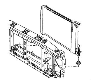

Disconnect the engine oil cooler lines from the radiator (if equipped). Refer to Engine Oil Cooler Line Replacement (RWD) or Engine Oil Cooler Line Replacement (4WD). See: Engine Oil Cooler Service and Repair Engine Oil Cooler Hose/Pipe Replacement
Disconnect the transmission oil cooler lines from the radiator, if equipped. Refer to Engine Oil Cooler Line Replacement (RWD) or Engine Oil Cooler Line Replacement (4WD). See: Engine Oil Cooler Service and Repair Engine Oil Cooler Hose/Pipe Replacement
Lift the lower fan shroud just enough to disengage the locating tabs.
https://www.2carpros.com/forum/automotive_pictures/12900_r4_2.gif
Remove the radiator by lifting the radiator up and out of the vehicle.
Inspect all sealing surfaces for deterioration or signs of leakage.
Installation Procedure
Place the lower fan shroud in position under the cooling fan. Refer to Fan Shroud Replacement.
Install the radiator onto the rubber mounts in the vehicle.
