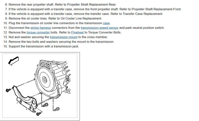

Engine problem
1999 Oldsmobile Bravada 6 cyl Wheel Drive Type unknown Automatic 105000 miles
What does it mean when your car makes a clicking noise while pressing the gas?
Jan 11, 2008 at 4:15 PM
  • CAR REPAIR CONTRIBUTOR
  • 54,249 POSTS

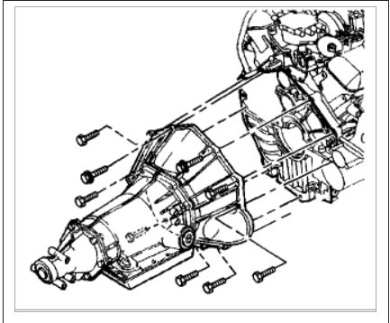

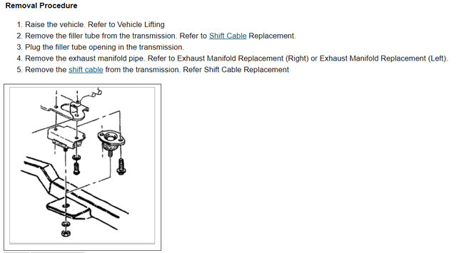

This click noise can be caused by one of two things either you have a loose spark plug or a broken flex plate which means you will need to remove the transmission.
Here is a guide to help you check the spark plugs
https://www.2carpros.com/articles/how-to-change-spark-plugs
This will show you how to remove the transmission to replace the flex plate diagrams (below)
Jan 11, 2008 at 4:23 PM
PLUTO
Yep I checked the plugs they where okay it was the flex plate it cost me 450.00 to have it fixed. Thanks for your help I love this site.
