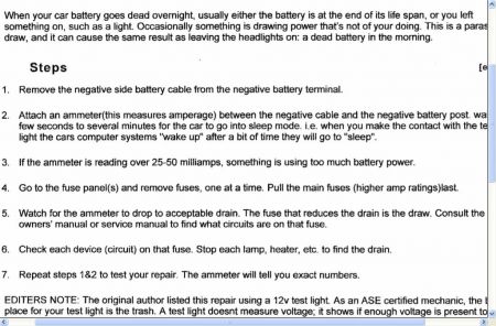

Hi mikidcarhelp and welcome to 2carpros Could be an excessive parastic draw that's draining the battery-Do below
https://images.2carpros.com/forum/automotive_pictures/12900_parastic_draw_1_38.jpg
