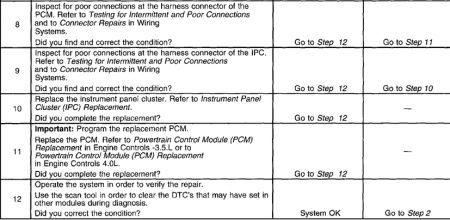

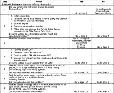

what is the problem should I replace the whole speedomter or the vehicle speed sensor switch. Speedometer does not work
