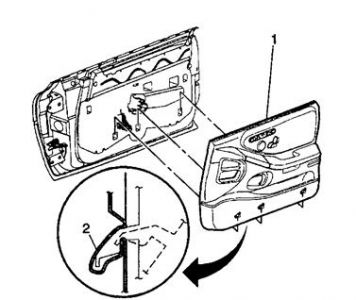

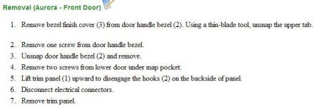

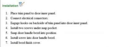

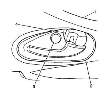

hOW TO REMOVE DRIVER SIDE INSIDE DOOR PANNEL

Sunday, March 29th, 2009 AT 11:29 PM
