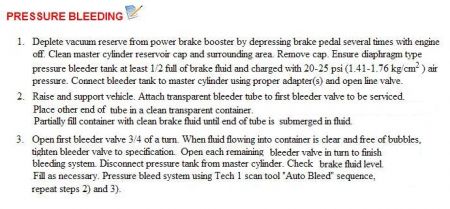

I replaced the brake pads and rotars on the front wheels and bled the brakes from the front to the back. No air is now coming out of the bleed valves. The brakes are still mushy and it sounds and fells as if there is still air in the lines. Is there any additional proceedure that I missed here?

Once the brakes have been manual bled, you will then have to pressure bleed them using a scan tool . Pressure bleeding steps are below...
https://www.2carpros.com/forum/automotive_pictures/261618_Noname_1347.jpg
