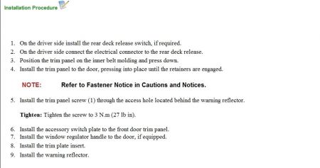

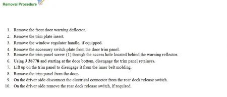

How do you remove the panel to get at the window mechanism
Saturday, September 4th, 2010 AT 11:57 AM
BLUELIGHTNIN6
MECHANIC
16,542 POSTS
Saturday, September 4th, 2010 AT 12:51 PM
