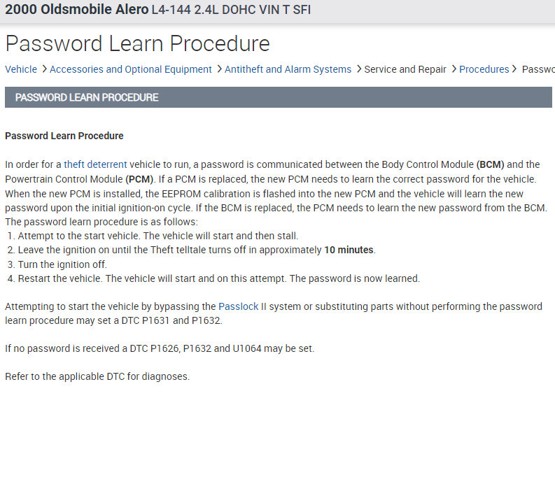

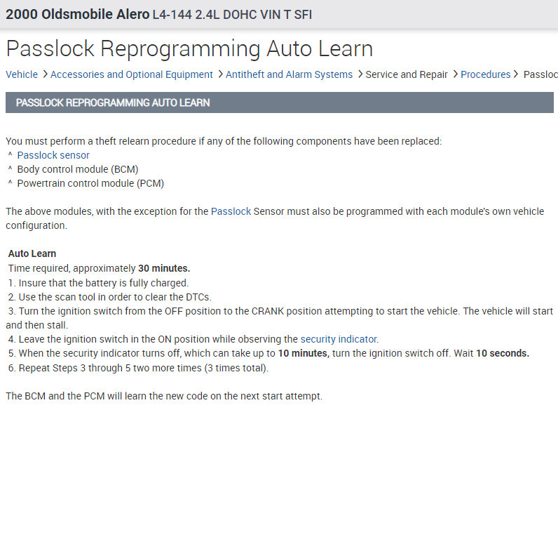

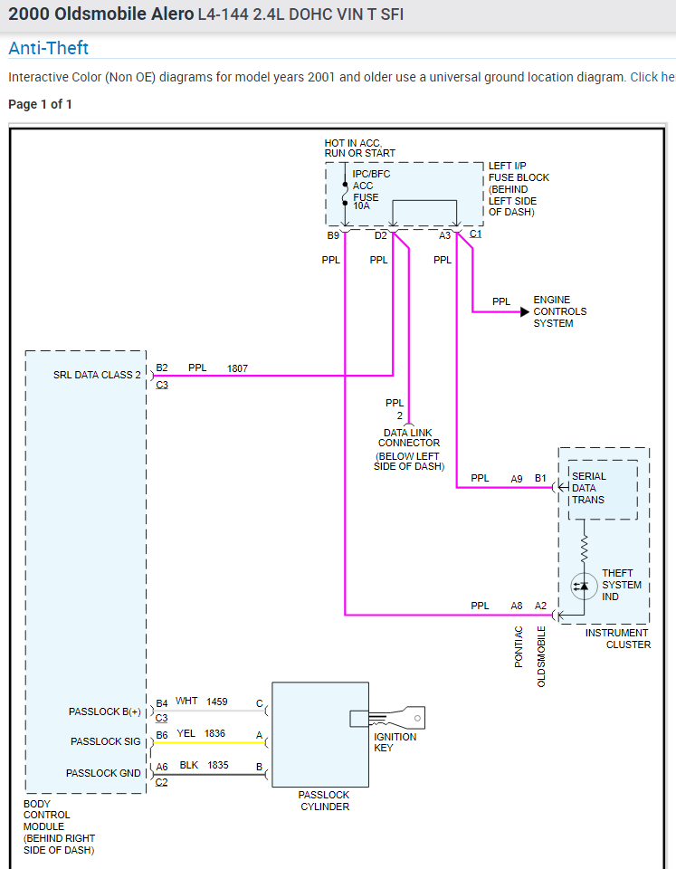

Car wont start at times but at times it will it will turn over, but like I said sometimes it wont start. But when it does not start the security light stays on. If you leave the ignition on after about 10 minutes it will start. Do you know why this is?

It sound like an issue with the anti-theft module of the car.
Some times resetting the system can fix this issue.
Try this procedure:
Unlock the car using the key fob.
Then use the key to lock and unlock the door.
Put the key in the ignition and crank the engine.
Hold down the panic button and try to start it.
This should reset.
You can also try disconnecting the battery for at least one minute, that can reset it as well.
Here is a helpful article:
https://www.2carpros.com/articles/how-to-reset-a-security-system
This should reset the system.
