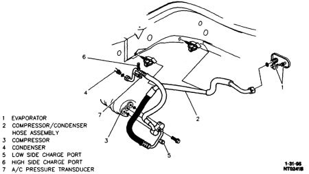

I am having a hard time locating the port that allows you to add r134. Can You Help!

Charge A/C @ low side charge port.See below:
A/C Hose Routing And Service Port Locations - 2.4L
