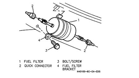

where is the fuel filter located:

My info says it is located under the front of vehicle, along right side body rail. I looked at three different databases for the filter location. Two databases said it was at the rear of vehicle. Mod said it was at the front. It appears to use quick connect fittings. Make sure no pressure on fuel system before taking any lines loose. If using a drop-lite, don't lay it where gas can get on it.
