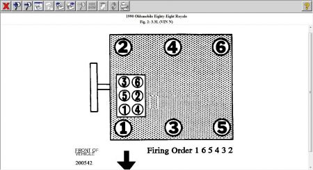

Need firing order

You sure its an 8cyl all am coming up with is for a 6 cyl 3.8L

You are correct v6
my bad!

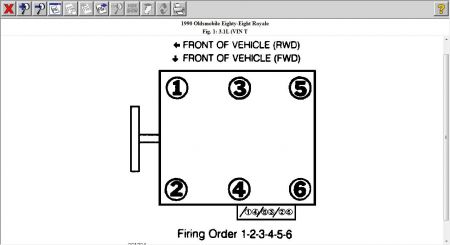

Pick your engine
