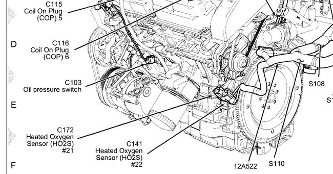

Where is oil sensor location?
Saturday, October 27th, 2018 AT 9:58 PM
14 Replies

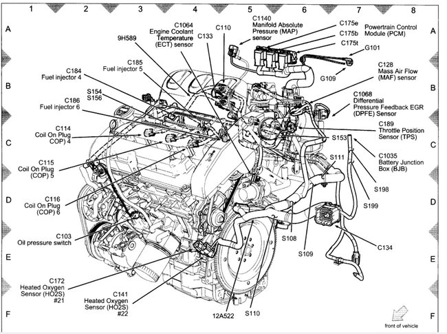

Good morning.
There are two engines for your year. I attached pictures of the location for both the 4 cylinder and V6. Check out the diagrams (Below). Please let us know if you need anything else to get the problem fixed.
-1

Need to put in new oil pressure sensor. Oil light sometimes comes on while idling. Where is the sensor?

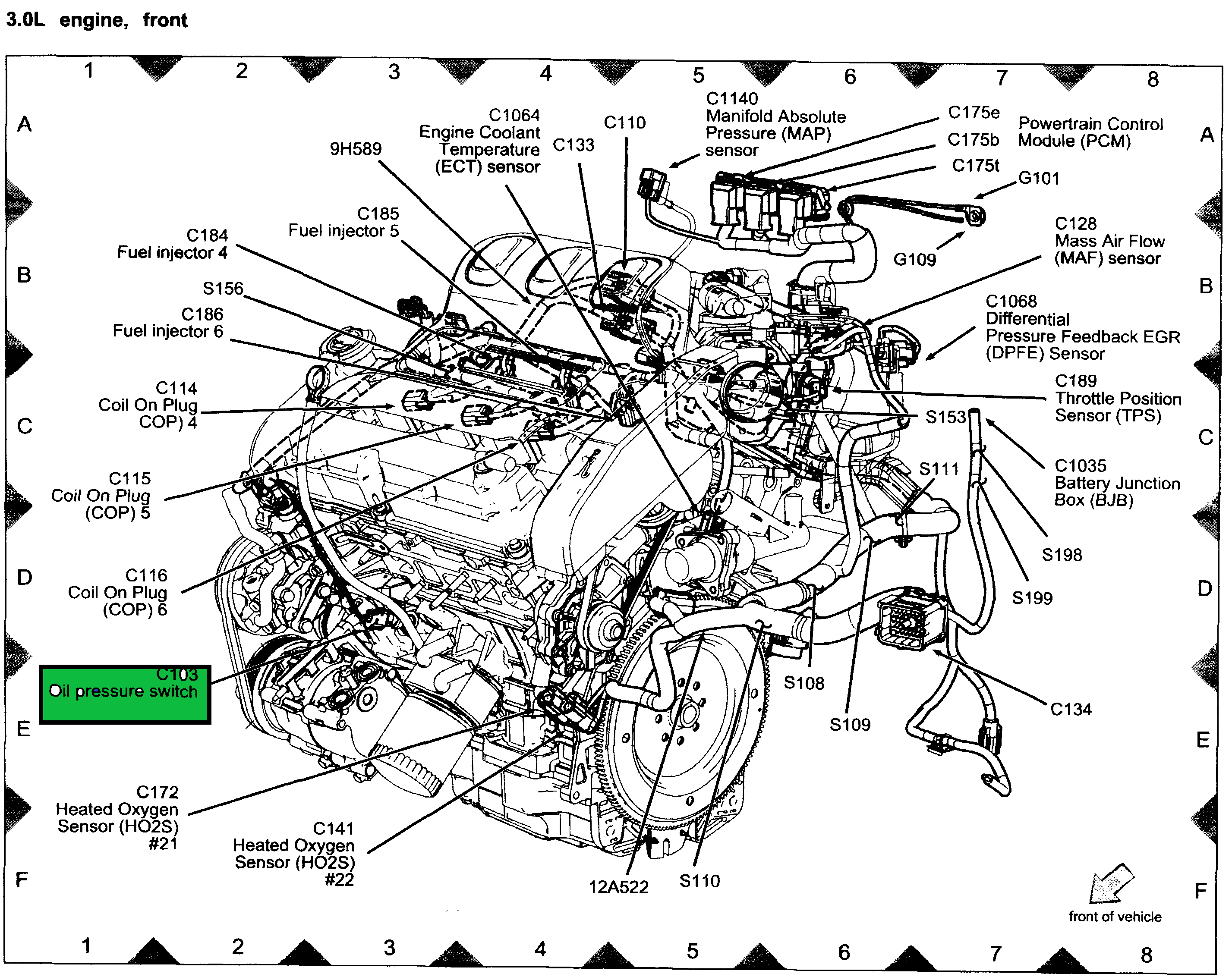

It's near the oil filter location. I've attached a picture.

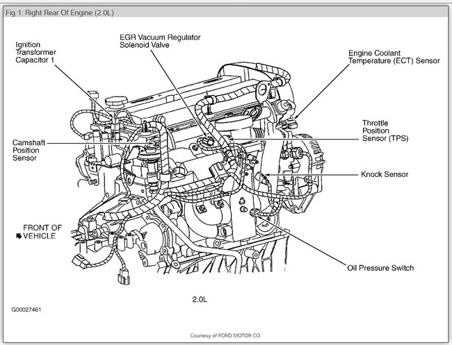

Where is the oil pressure sensor location on 2001 Ford Escape v-6

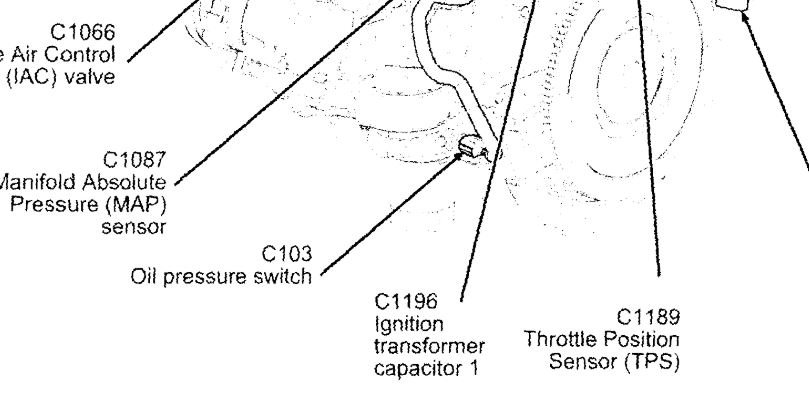

Oil Pressure Switch (2.0L)On right rear near the starter under a bracket, here is a diagram (below) to help show you. I have also included the location for the V6 engine as well. Check out the diagrams (Below). Please let us know if you need anything else to get the problem fixed.
