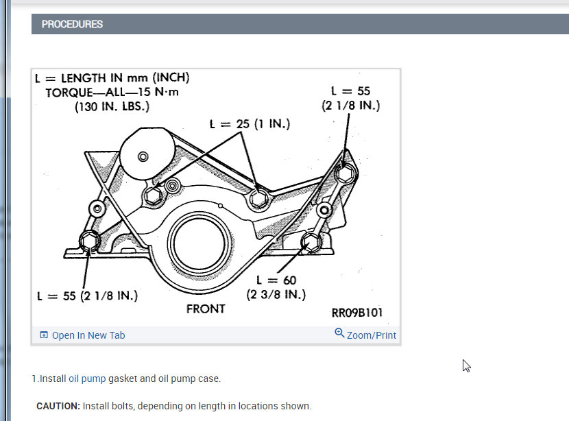

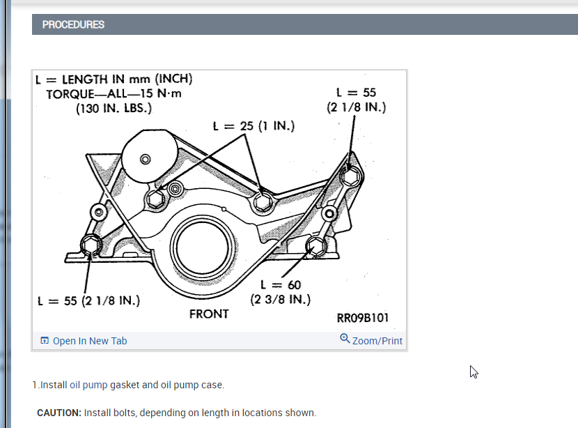

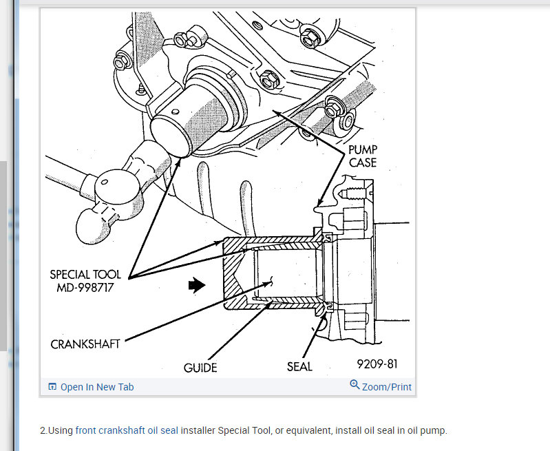

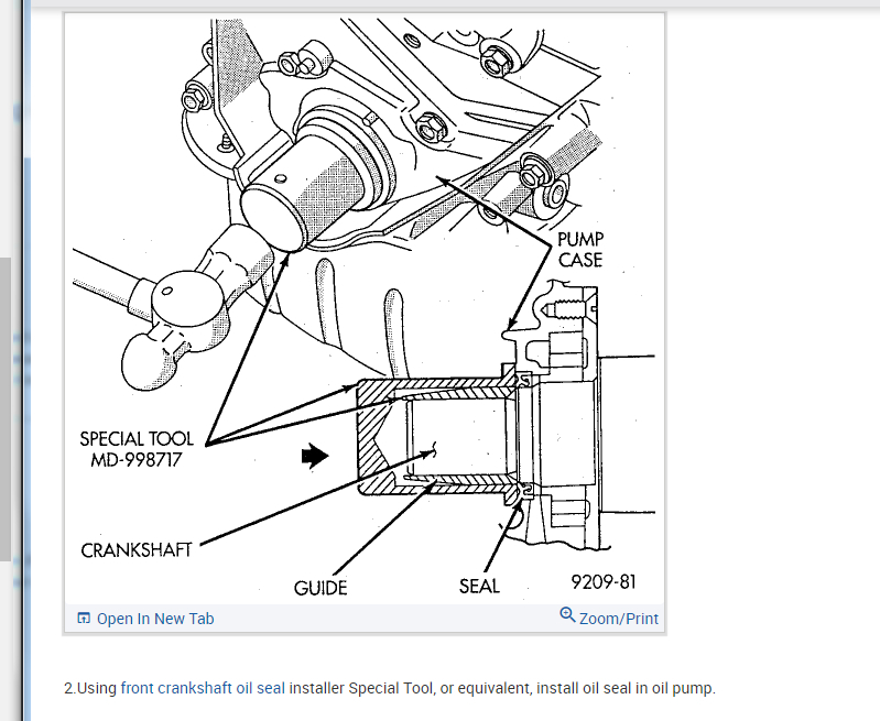

Oil leaking out from bottom front!
Tuesday, December 24th, 2019 AT 9:17 AM
MECHANIC
18,907 POSTS
More then likely this is the crank main seal but here is a guide that will help with oil leaks:
https://www.2carpros.com/articles/engine-is-leaking-oil
However, if this is the crank seal here is a guide that will help with replacing this:
https://www.2carpros.com/articles/front-main-seal-replacement
Also, I attached the procedure from the manual below that will help replace this. Let us know if you have other questions. Thanks
