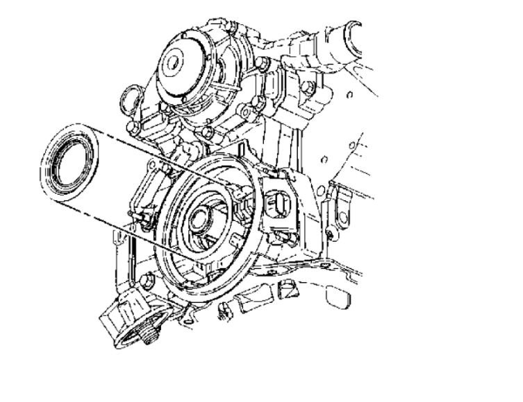

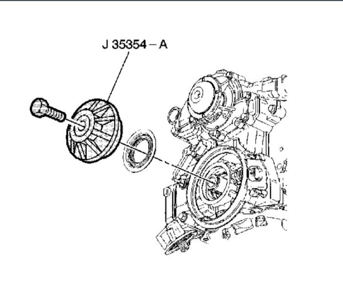

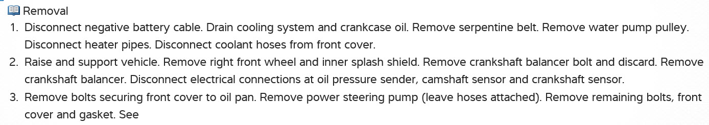

This is from the front crankshaft seal. I attached the procedure for you with a picture. When you are done, make sure you do the sensor relearn procedure. You will need a scan tool to perform this procedure. Check out the diagrams (Below).
Crankshaft Front Oil Seal Replacement
Tools Required
J 35354-A Seal Installer
Removal Procedure
1. Remove the crankshaft balancer.
2. Pry out the crankshaft front oil seal with a flat bladed tool such as a large screwdriver. Use care to avoid damaging the crankshaft front oil seal bore or the crankshaft front oil seal contact surfaces.
Important: Be careful not to damage the crankshaft.
3. Inspect the crankshaft balancer and engine front cover for scratches.
Installation Procedure
1. Install the crankshaft front oil seal in the engine front cover using the J 35354-A.
2. Tighten the bolt until the crankshaft front oil seal is seated in the engine front cover.
3. Remove the J 35354-A.
4. Install the crankshaft balancer.
5. Inspect for leaks.
6. Perform the CKP system variation learn procedure.
Relearn
CKP SYSTEM VARIATION LEARN PROCEDURE
IMPORTANT:
The scan tool monitors certain component signals to determine if all the conditions are met to continue with the procedure. The scan tool only displays the condition that inhibits the procedure. The scan tool monitors the following components:
Crankshaft position (CKP) sensors activity-If there is a CKP sensor condition, refer to the applicable DTC.
Camshaft position (CMP) signal activity-If there is a CMP signal condition, refer to the applicable DTC.
Engine coolant temperature (ECT)-If the engine coolant temperature is not warm enough, idle the engine until the engine coolant temperature reaches the correct temperature.
The CKP system variation learn procedure is also required when the following service procedures have been performed, regardless of whether DTC P0315 is set:
An engine replacement
A powertrain control module (PCM) replacement
A crankshaft balancer replacement
A crankshaft replacement
A CKP sensor replacement
Any engine repairs which disturb the crankshaft to CKP sensor relationship.
1. Install a scan tool.
2. Monitor the PCM for DTCs with a scan tool. If other DTCs are set, except DTC P0315, refer to Diagnostic Trouble Code (DTC) List - Vehicle for the applicable DTC. See: A L L Diagnostic Trouble Codes ( DTC ) > Diagnostic Trouble Code Descriptions
3. With a scan tool, select the CKP variation learn procedure and perform the following:
1. Observe fuel cut-off for applicable engine.
2. Block drive wheels.
3. Set parking brake.
4. DO NOT apply brake pedal.
5. Cycle ignition from OFF to ON.
6. Apply and hold brake pedal for the duration of the procedure.
7. Start and idle engine.
8. Turn the air conditioning (A/C) OFF.
9. The vehicle must remain in Park or Neutral.
10. Accelerate to wide open throttle (WOT).
IMPORTANT:
The engine should not accelerate beyond the calibrated fuel cut-off RPM value noted in step 3.1. Release the throttle immediately if the value is exceeded.
While the learn procedure is in progress, release the throttle immediately when the engine starts to decelerate. The engine control is returned to the operator and the engine responds to throttle position after the learn procedure is complete.
4. The scan tool displays Learn Status: Learned this ignition. If the scan tool indicates that DTC P0315 ran and passed, the CKP variation learn procedure is complete. If the scan tool indicates DTC P0315 failed or did not run, refer to DTC P0315. If any other DTCs set, refer to Diagnostic Trouble Code (DTC) List - Vehicle for the applicable DTC. See: A L L Diagnostic Trouble Codes ( DTC ) > P Code Charts > P0315 See: A L L Diagnostic Trouble Codes ( DTC ) > Diagnostic Trouble Code Descriptions
5. Turn OFF the ignition for 30 seconds after the learn procedure is completed successfully in order to store the CKP system variation values in the PCM memory.

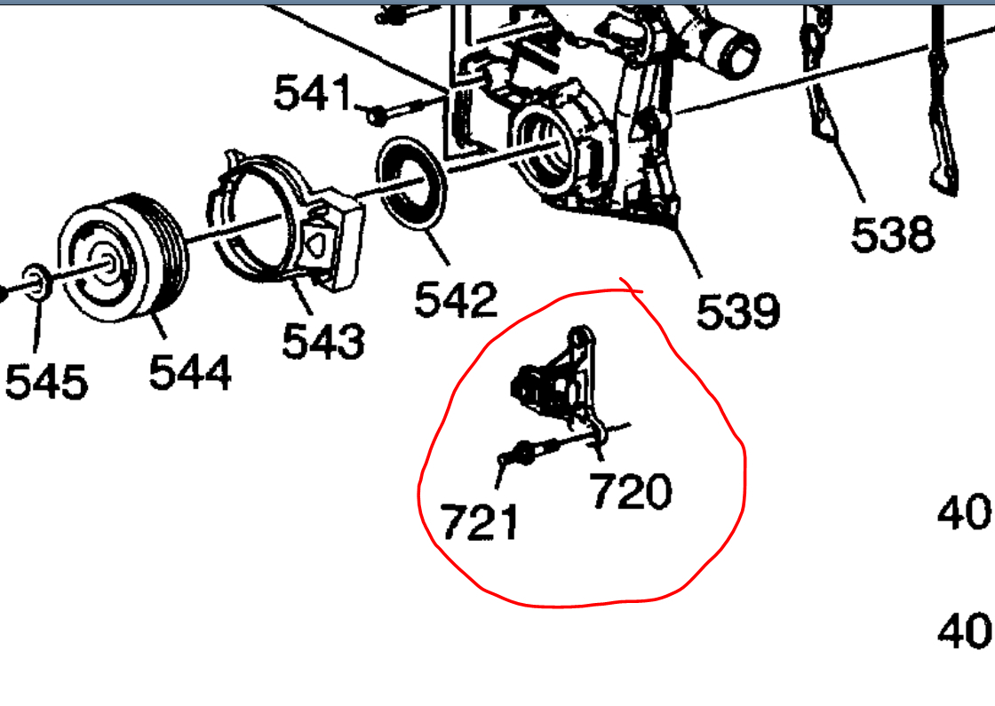

The only thing I can think they are not packing the oil pump cavity with petroleum jelly. That has to be done to produce a vacuum in the pump to make it start drawing oil. Also, the pick up tube may not have been properly attached. I would think they removed the oil pan to inspect the pick up tube screen to make sure it is not plugged. There is a pressure relief valve that may be an issues as well. I attached a pic below. I highlighted the pressure relief valve and the oil pump gears and backing plate. As far as the used engine they got, it may have had damage prior to install.
As far as needing a new crankshaft position sensor, there is a good chance it was damaged during all this work because of its location. See pic 2. I circled the sensor. You can see it is located at the crankshaft pulley, which is in front of the oil pump.
I need to know this. When they got the new engine, was anything changed on it? For example, did they install the new oil pump from the other engine? Also, (and I realize you are not with the car) if you can record the sound it is making when cranking and upload it for me to hear, it would be helpful. Now that we have a second engine to contend with and we don't know its history, it is going to make things more difficult.
There aren't too many things that can be causing this. I have no idea what they have done so far or what has led to this, especially on two engines.

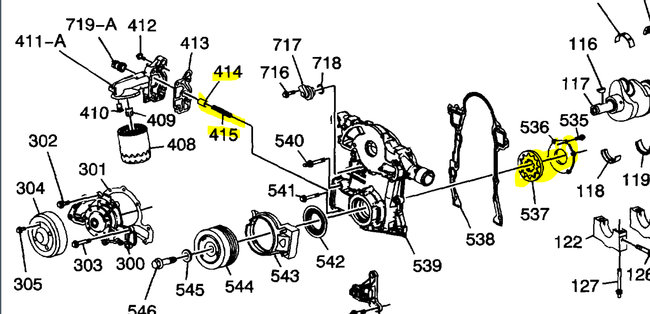

3.8L Engines
NOTE
The oil pump is located inside the engine front cover.
WARNING

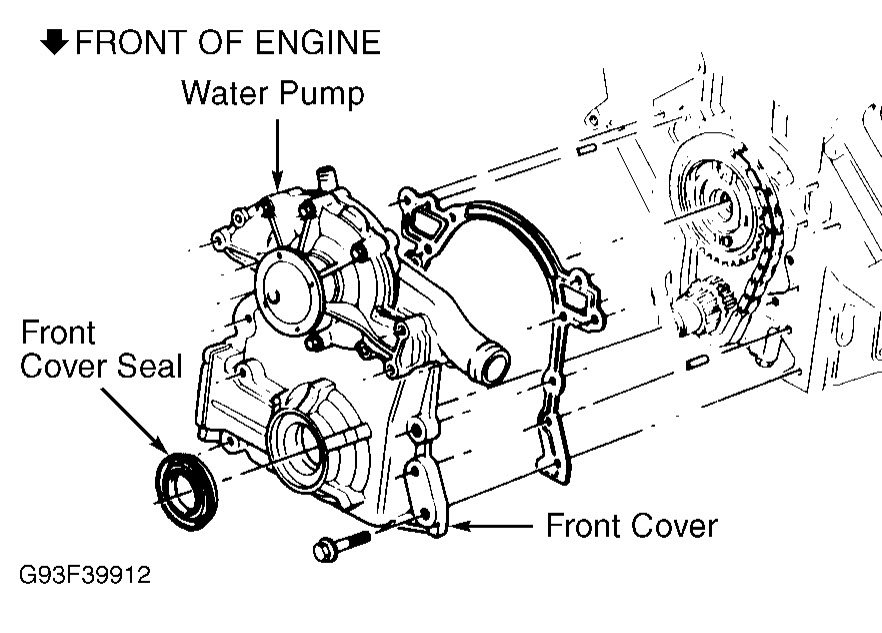

When troubleshooting a low oil pressure complaint, another possibility is a clogged screen on the oil pickup pipe, damaged pipe or gasket. The oil pan will have to be removed to check this. Running the engine without measurable oil pressure will cause extensive and expensive damage.
REMOVAL:
Remove the engine front cover using the procedure found in this section.
Remove the oil pump cover attaching screws and remove the cover.
Remove the oil pump gears.
If desired, remove the oil filter adapter and remove the pressure regulator valve and the spring for cleaning.
INSTALLATION:
Clean all parts well.
Lubricate the gears with petroleum jelly, packing all the spaces around the gears, filling the pump cavity. This is important. The petroleum jelly seals the pump cavity to help "prime" the pump. The reduces the time the engine will run with little oil pressure on initial start up after oil pump installation. DO NOT use chassis grease. Petroleum jelly melts at a low temperature and will "go away" as the engine warms.
If the oil pressure relief valve was removed, inspect the valve and bore for burrs. Check the spring for loss of tension. Replace the spring if in doubt.
Install the pump cover and tighten the screws evenly to 98 inch lbs. (11 Nm).
If removed, thoroughly clean the oil pressure relief valve of all varnish and install the spring first, the valve. Use a new oil filter adapter gasket. Install the adapter. Tighten the oil filter adapter bolts evenly to 22 ft. Lbs. (30 Nm).
Install the engine front cover using the procedures found in this section.

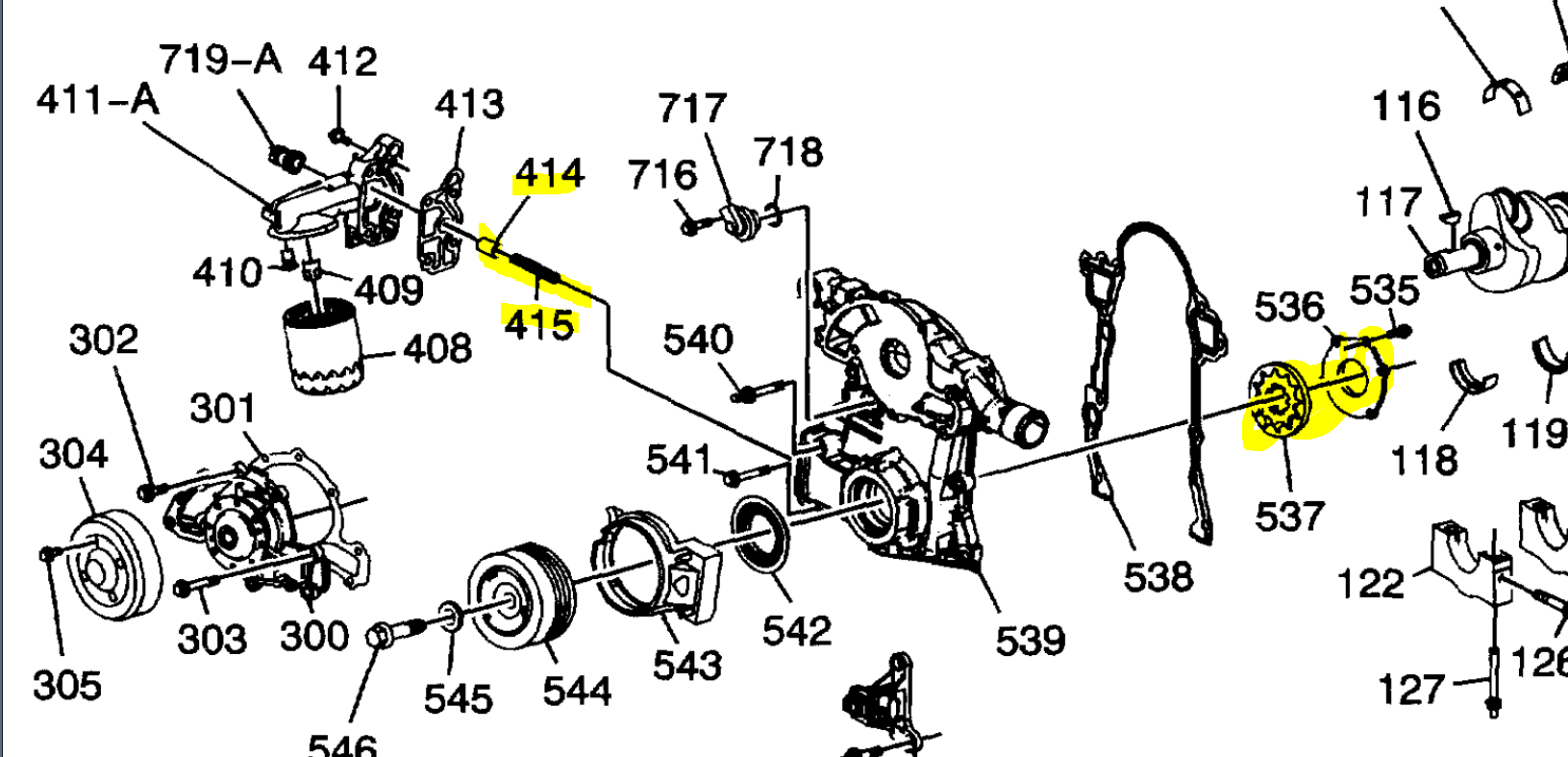

Oil pump is attached to front cover. Remove oil filter pressure regulator and gears from cover. The front cover is probably shot as well and will need replacement. Check out the diagrams (Below). Please let us know if you need anything else to get the problem fixed.
